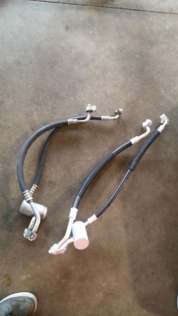

Found the leak in my A/C system. Was leaking out of a weld on the compressor muffler. Stupid line cost $70 from NAPA, but it sure is nice having cold Air Conditioning again. Money well spent.

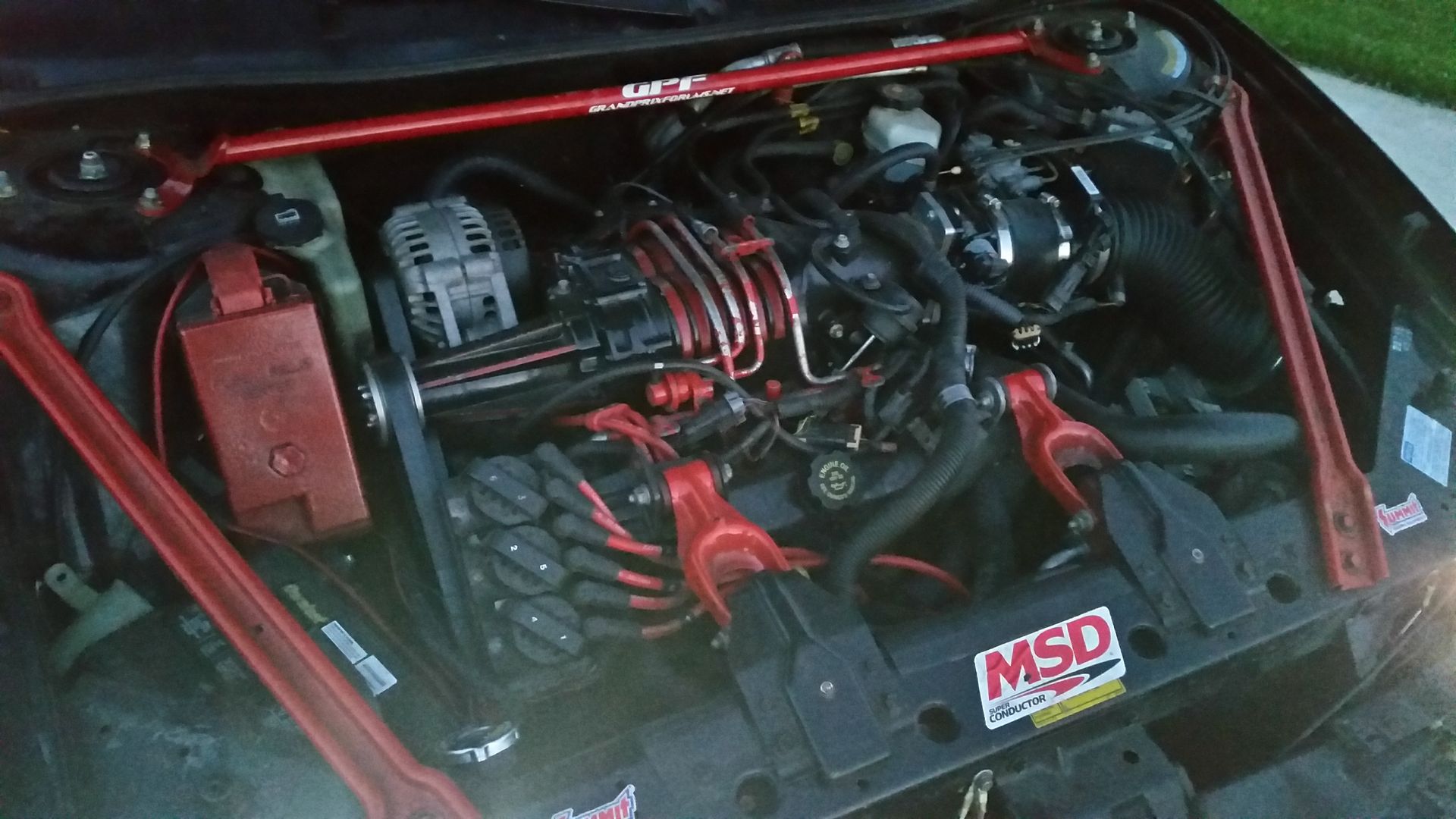

New line in:
Buddy of mine had a 3.2 laying in his trunk. Decided to put it on the car to see how it reacted. Damn thing has 0 KR on this 3.2 pulley. 16* Timing, 0 KR, 12.5 psi at the shifts. Car is running rich, so I'm assuming that's why I have no knock. Car pulls like a motherf*ker now though, and I like it.

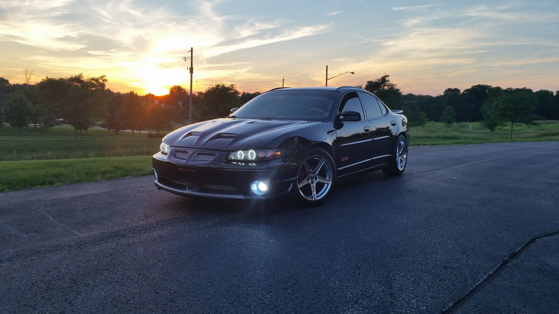

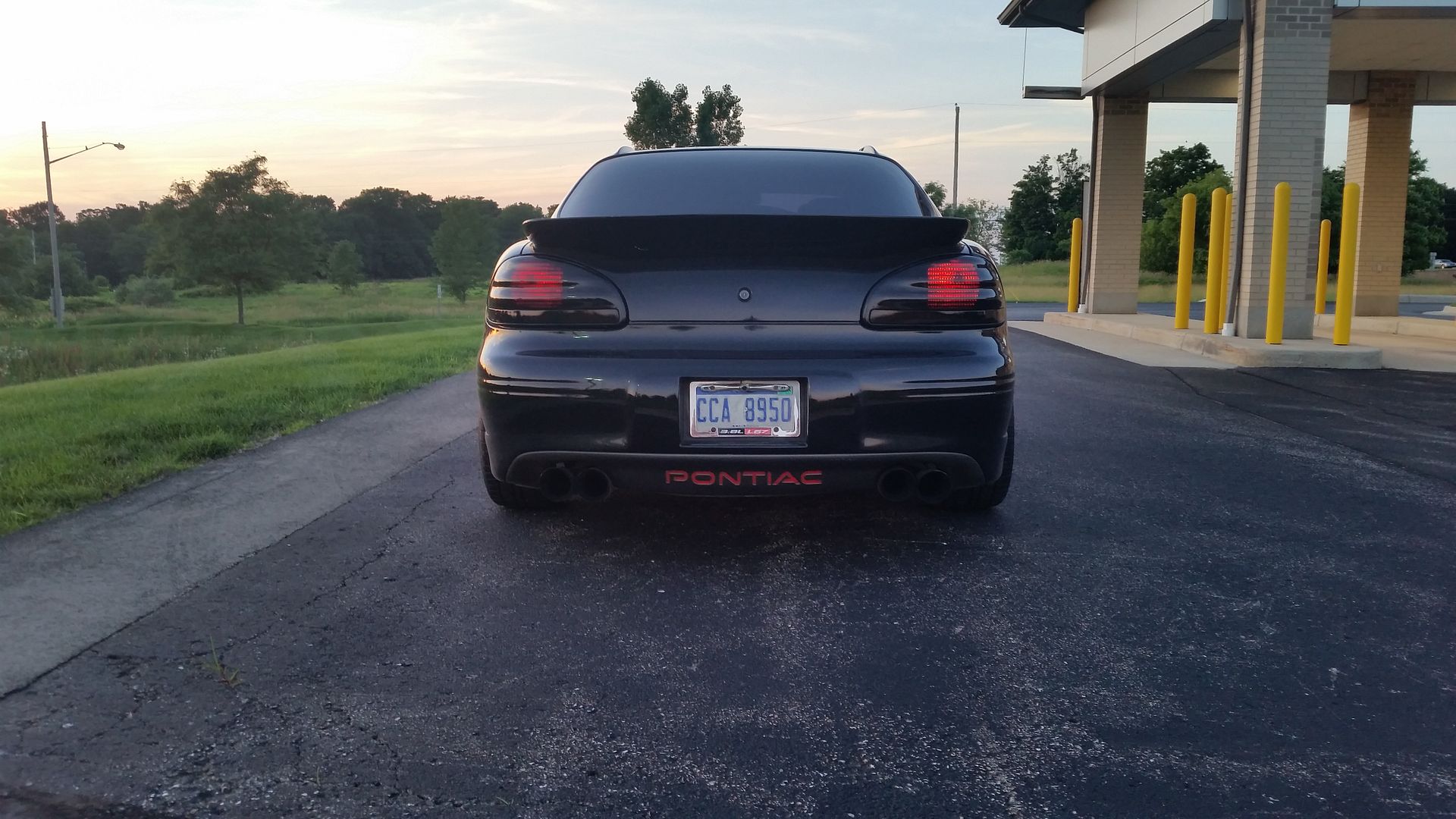

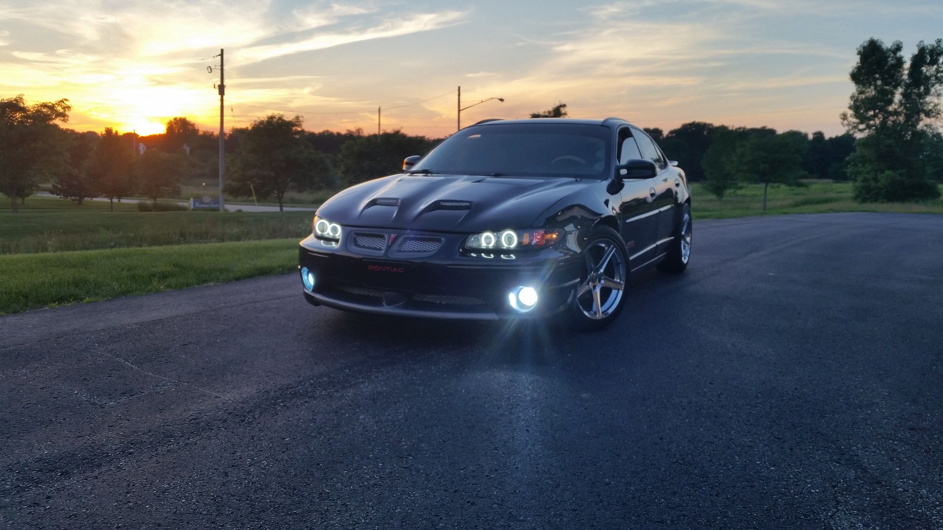

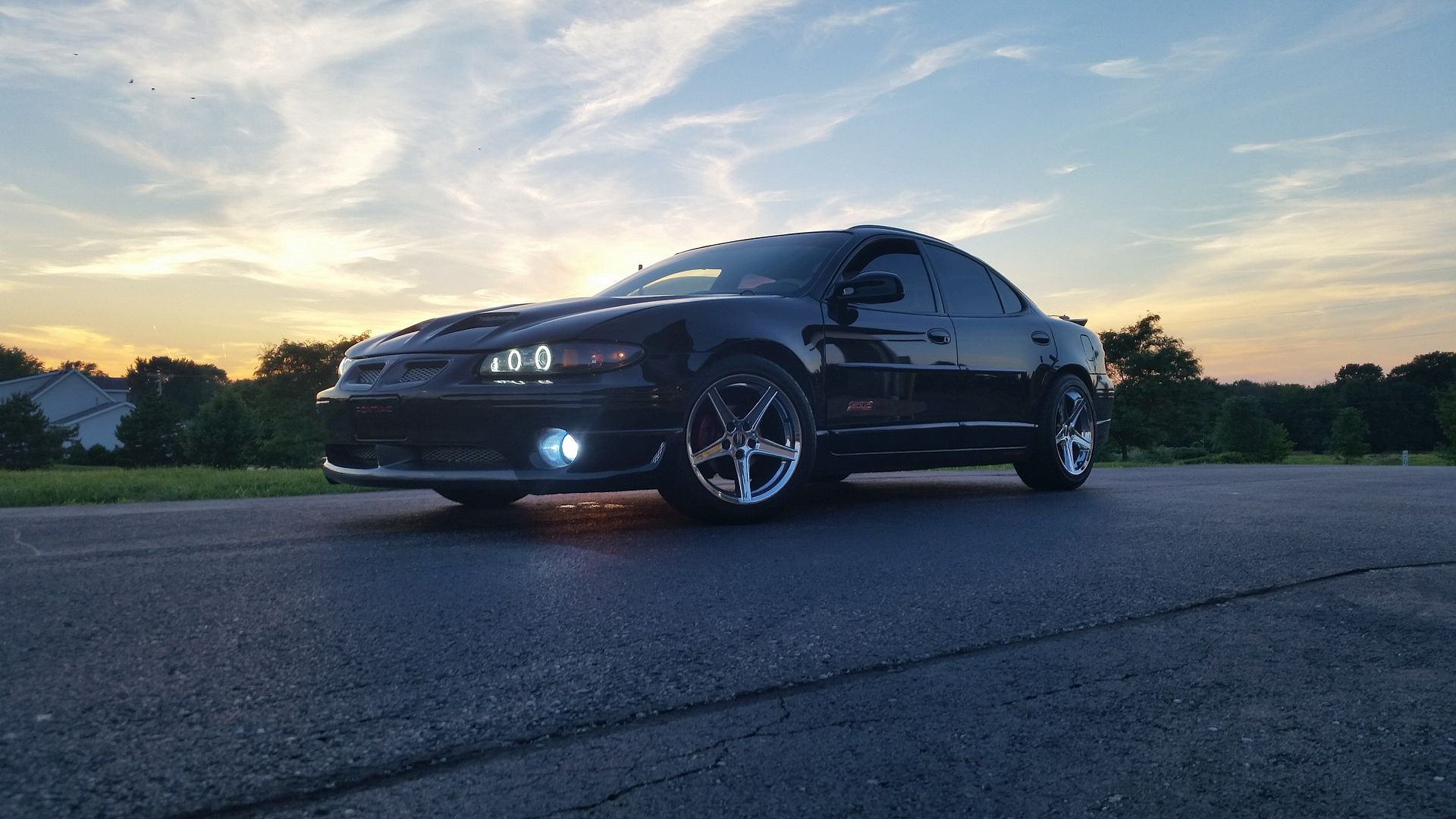

Found a decent spot to snap some pictures tonight:

Do you have a vacuum pump and gauge set to recharge the system, or did you have to pay to have that done? I'll probably be doing some AC work in the future, and I'm curious what others have done.
Re: 1997 Black GTP - Now With 04+ Seats.
That same line on mine broke too, 2 days before the meet. By the time I got to Royal Oak it wasn't leaking anymore... Was it a pain to get out/in? Looks like 3 bolts.
At my school I have a Snap-On A/C Machine. It can Recover, Vacuum, Leak Test, and Recharge the system. I got to use it for free. So I recovered any of R-134A in the System, removed the line, installed new line, put a vacuum to the system for 20 minutes, then added 1.90 Pounds of R-134A. Checked for leaks on more time with the UV Light and all was good.
Not at all. Super simple fix. It's just 3 bolts and the line pulls right off. You'll just need an extension to get to one bolt (Makes it easier, at least).
