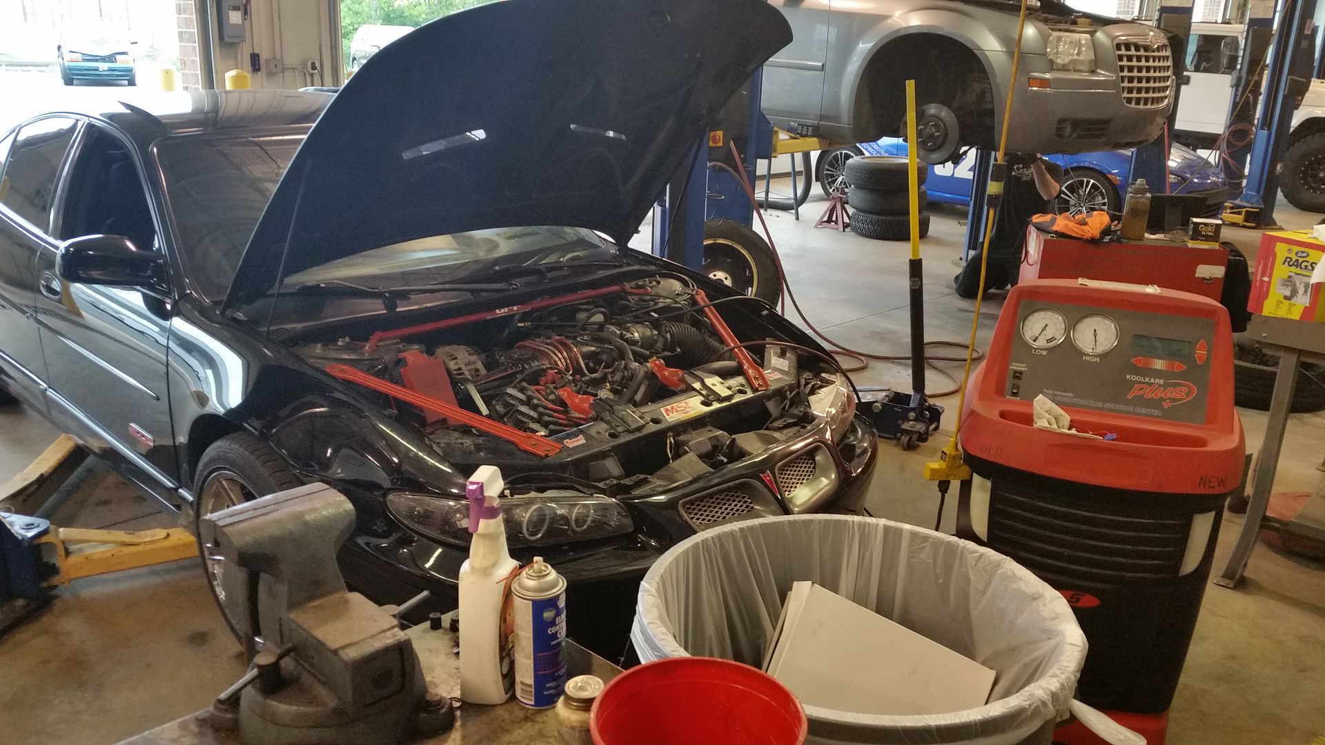

A/C has a leak somewhere, So I recovered all the R-134A, added some UV Dye, and Recharged:

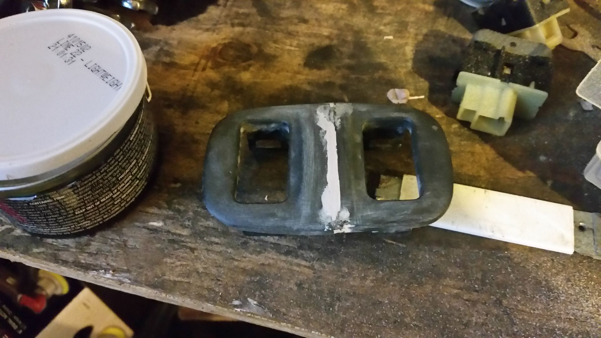

Finished the Dual Heated Seat Bezel:

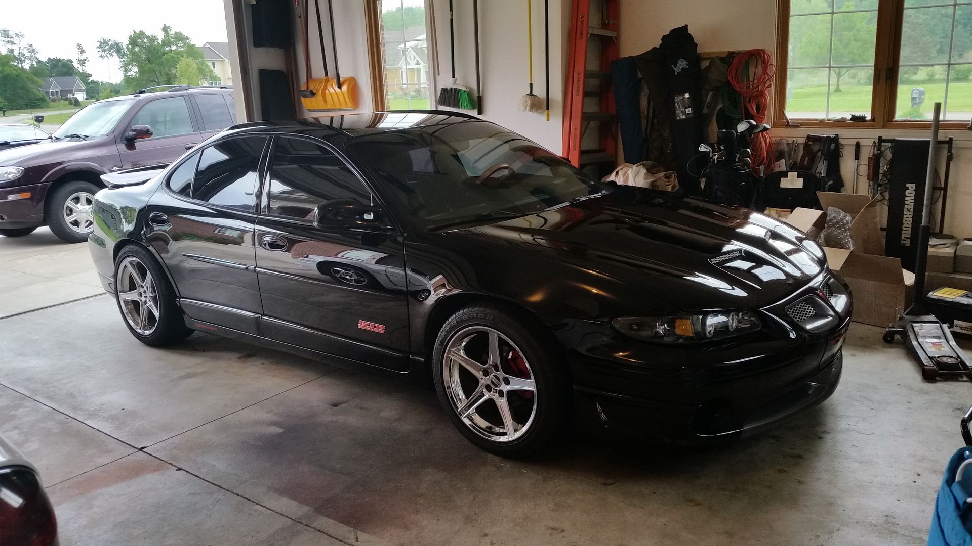

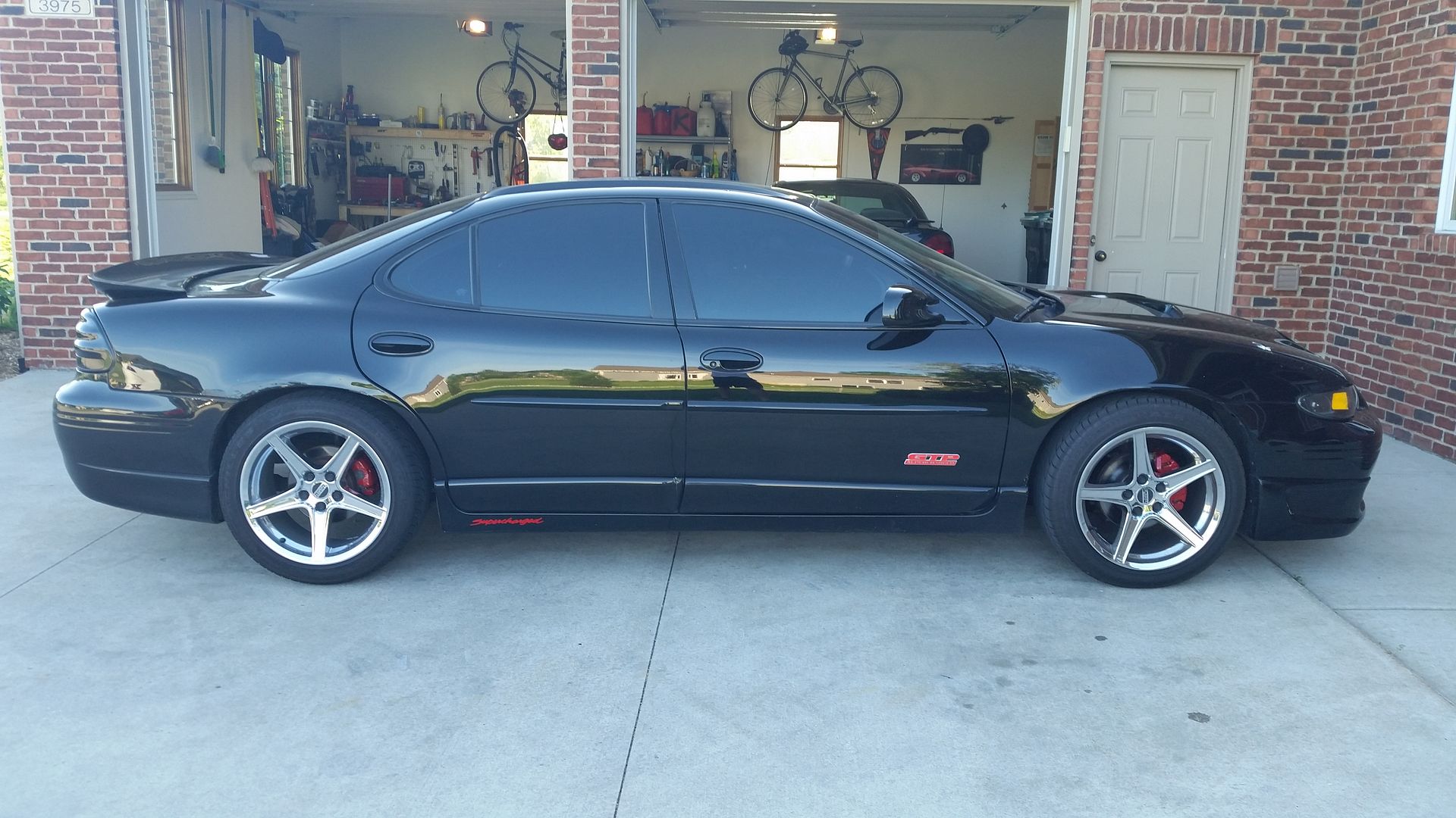

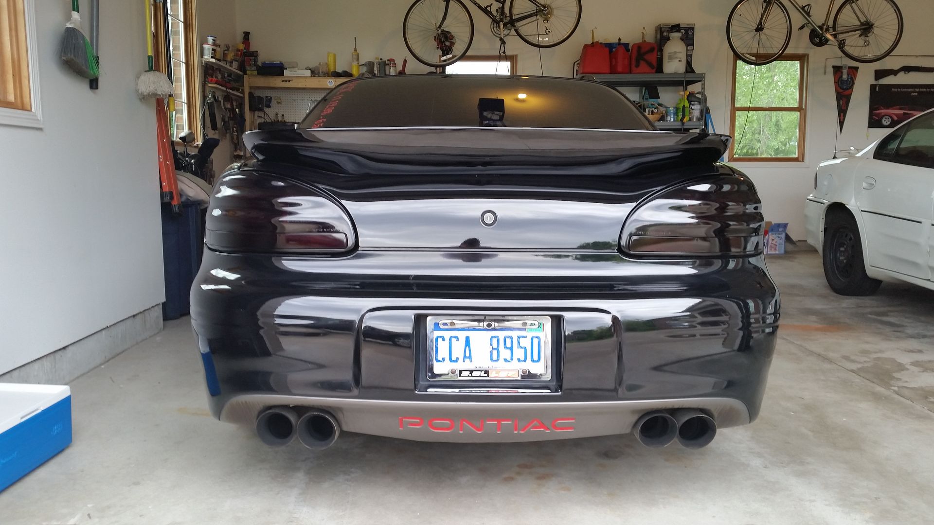

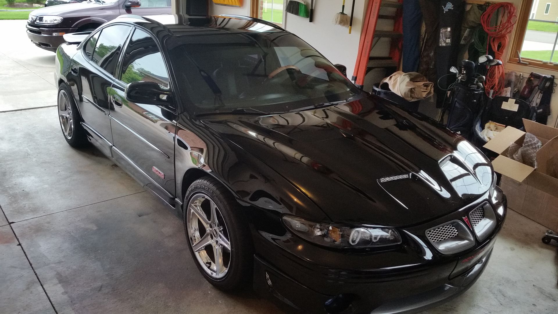

And then finally spent 8 hours buffing the car. Wash / Clay Bar / Cut / Polish / Wax. The paint needed some major work, and the results came out great:
Re: 1997 Black GTP - Now With 04+ Seats.
There is a lot of touch up paint on the hood the pictures don't show. Lol. But it's amazing the difference from before until now. The paint was in rough shape, from a long winter. Pleased with the outcome.
Now I don't want to drive it because it's so clean.

Excellent job on the paint Dan.
What products did you use for the cut and polish?

wow your car looks show ready man!! seats look good, bezel is well made, and paint is on point. Well done Dan

Thanks man.
I used all meguiars products. Ultimate compound for the cut with a variety of buffer pads for the cut, polish, and wax.

The Products I used, encase anyone was wondering:
- Rain-X Car Wash
- Meguiars Clay Bar Kit
- Meguiars Ultimate Compound
- Meguiars Ultimate Polish
- Meguiars Ultimate Syn. Wax
- Harbor Freight Orbital Buffer w/ a variety of different pads

Nice man, looks amazing. One question do you know the color that they use for the lower valance on the front and rear bumpers?
Also I am glad Eagle 077's are still around, man I loved them back in the early 2000's on the Nbodies, I might just have to get some, very nice detail work.
I believe its WA8945 for the Graphite Gray.
And just so you know, these aren't 077s. These rims are actually Mustang Saleen Rims. I did get the style of rims I wanted from the 077s but they didnt have a low enough offset, so I went with these.
Good work, well worth the time spent. Photoshoot before it gets dirty?
Thank you sir.
No photoshoot, because the cars already dirty from driving it for one day. :(
