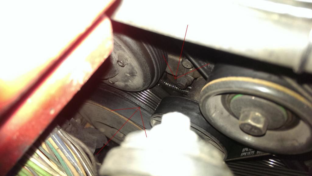

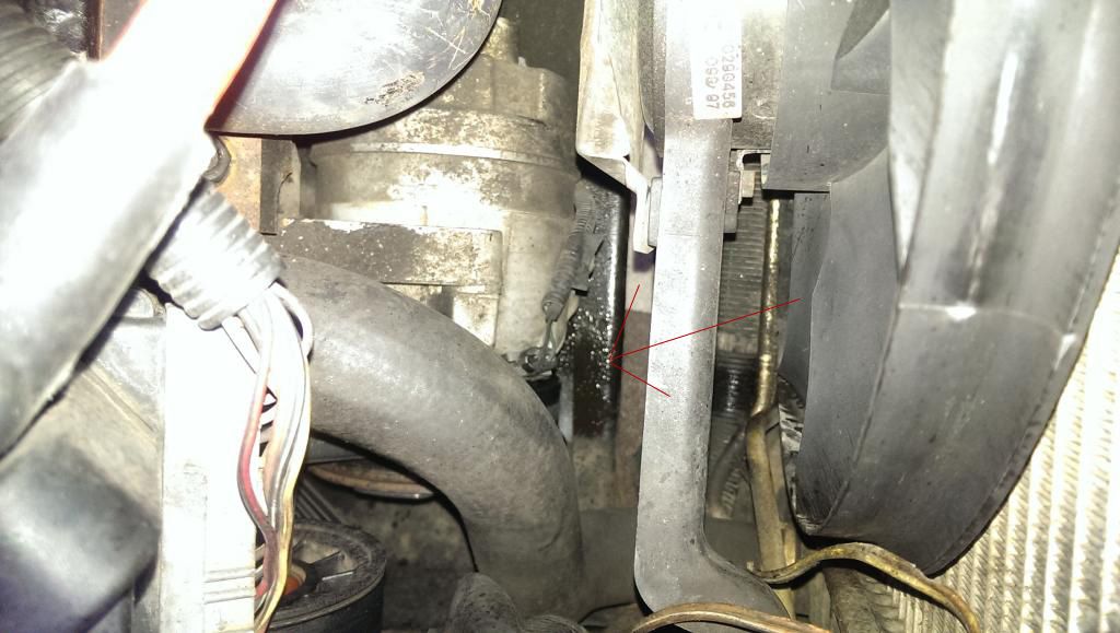

Car all of sudden has a bad coolant leak. Noticed it yesterday when working on the car.
It's a pretty substantial leak. Went from full in the radiator two days ago, where now I can barely see it way down in the radiator. Car hit 220* on the way home from work, which is under a 10 minute drive. It's just a constant drip. Here's some pictures I got of where I found coolant in the engine bay.
Underneath the A/c Compressor was some coolant:
And back behind the Crank Pulley. The further back ribbed portion of the Crank Pulley, where the Alternator Belt rides on was wet as well, as indicated by the arrows:
I also found a smidge of coolant on the Alternator as well. Basically, there's spots of coolant all over the belt side of the engine as it's getting flung around where it's leaking from, causing it to be a little difficult to pin-point where the leak is coming from.
My only two thoughts of where this could be coming from, is either the further back rear Coolant Elbow or the Water Pump / Water Pump Gasket.
Any ideas to help tackle this problem is appreciated.

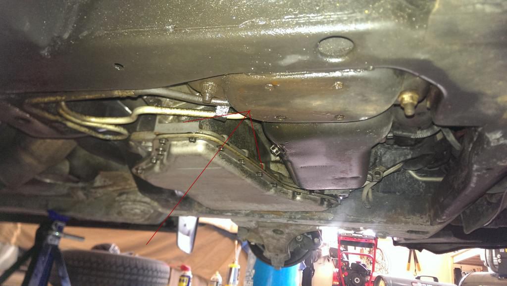

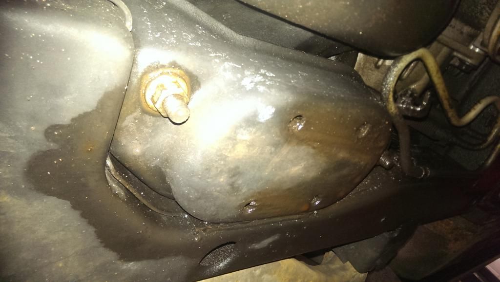

Here's a few more pictures, might not help but who knows.
Had the front of the car jacked up when I was replacing the front brake pads two days ago. This is when I noticed the leak.
It's mainly all dripping from this spot, where the 4 holes are. You can see the orange on it. Not sure what that is:

Im probably wrong but your motor mount isn't leaking is it? I know they have fluid unless you got solid mounts, because that looks to be where it mounts to or near.
