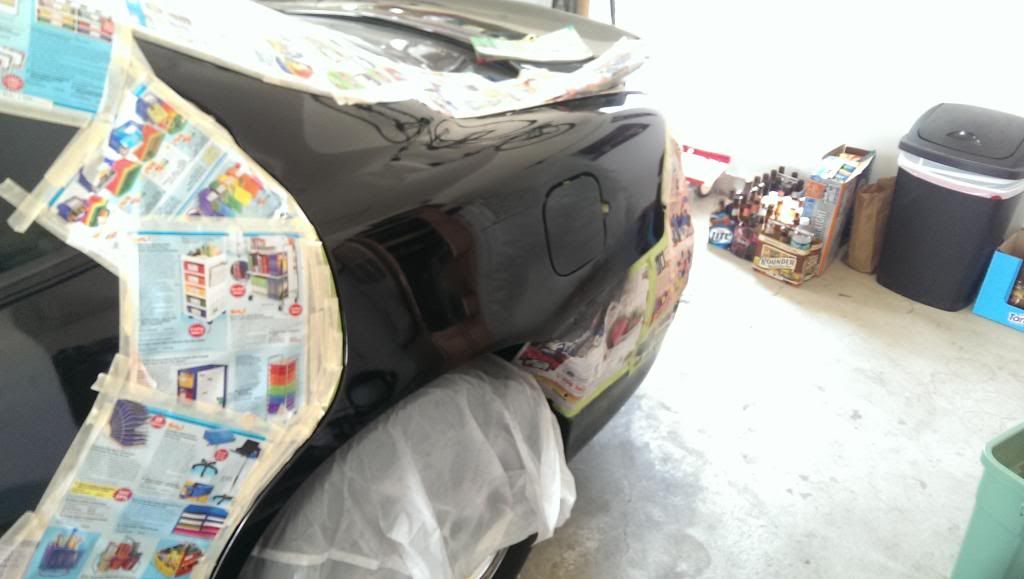

Really had to get this metal covered up before it started to rust. Made the huge mistake of taping off the surrounding area, so there is a tape line now, but not to concerned at this point, just looks better than before:

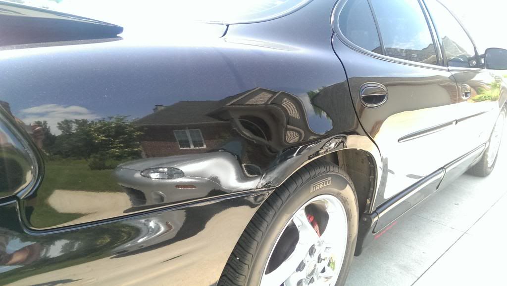

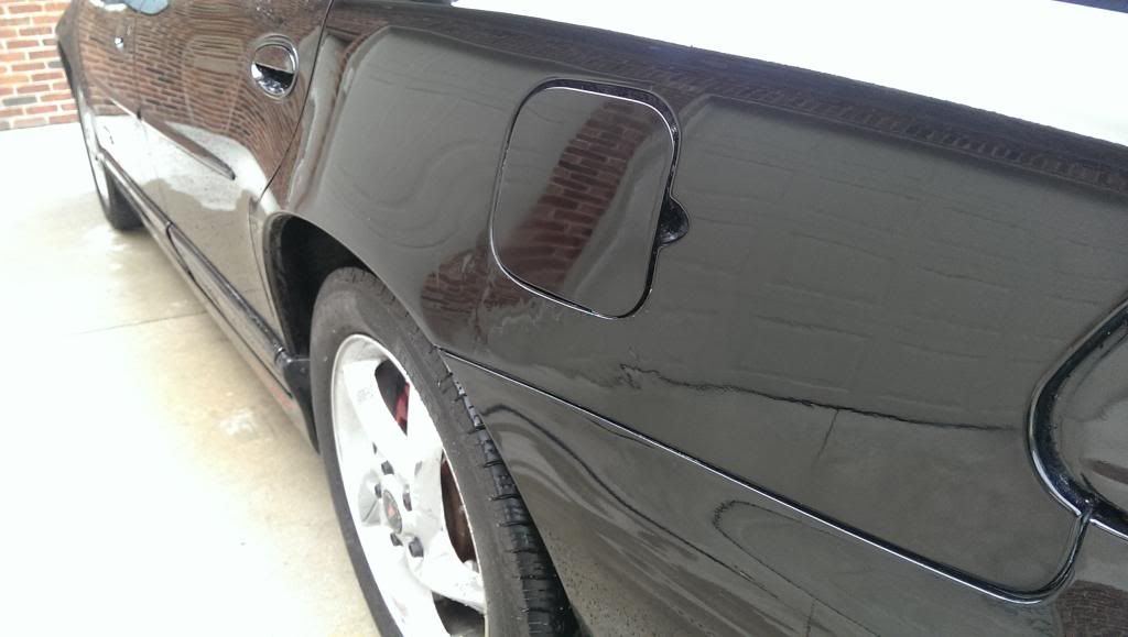

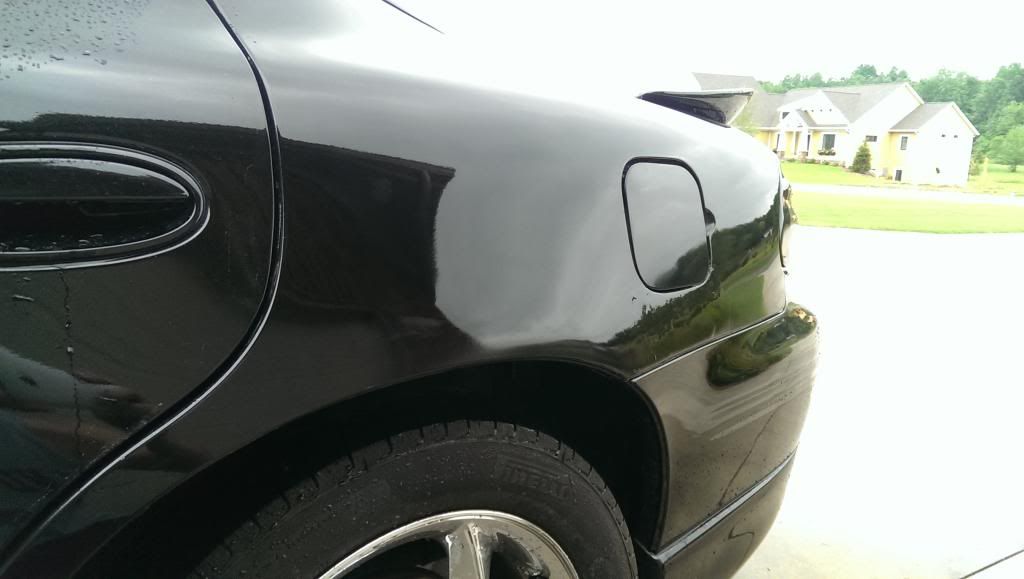

Then started working on the gas cap area. It started to rust again, and lots of bubbles underneath it. Don't have a before picture, but it looked nasty. This time I tried to blend. Came okay for my first time, and body work isn't easy to get to look perfect. I can see why it's expensive.

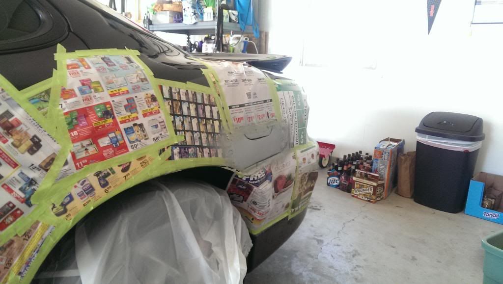

Taped off just the area for the primer:
Attempting to blend:
What it looked like with overspray all over the fender, before wet sanding:
Lots of wet sanding and buffing, this is how it turned out. Like I mentioned before, wasn't even close to perfect, but looks better than rust and bubbles:

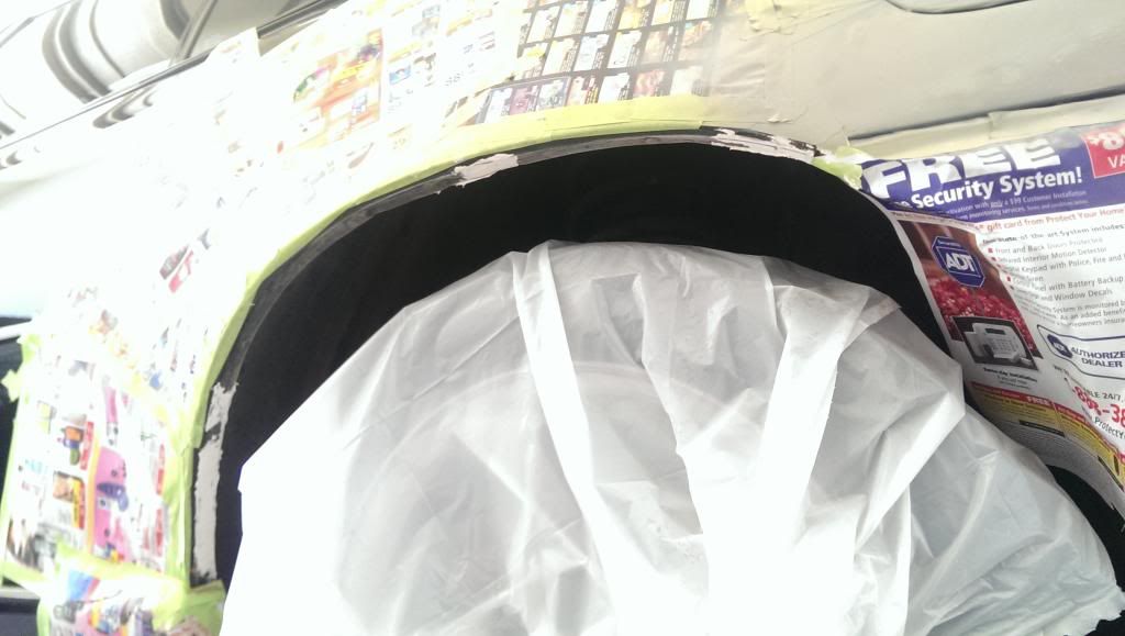

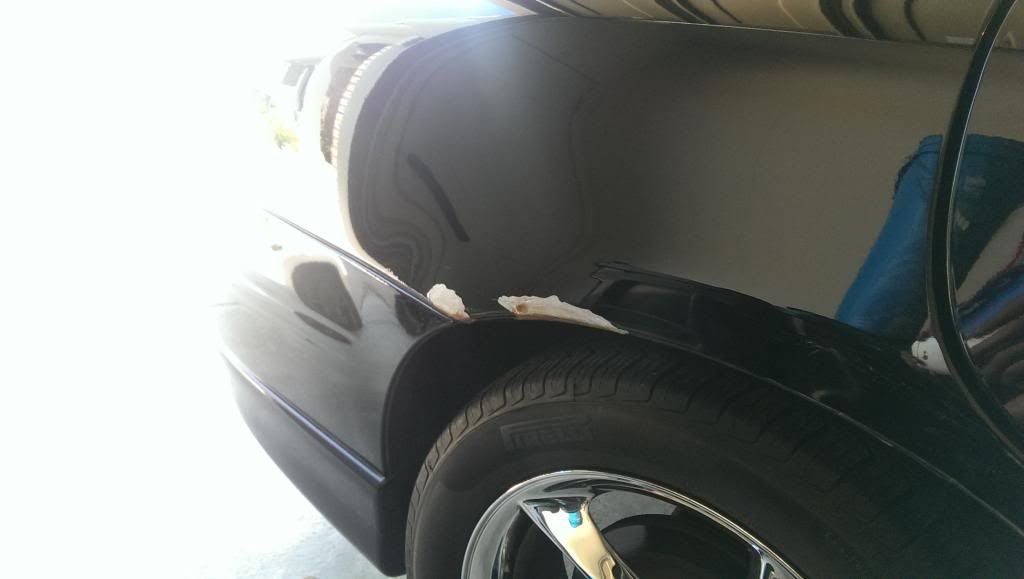

Also fixed up around the wheel well, rear drivers side as it was missing paint and rusting:

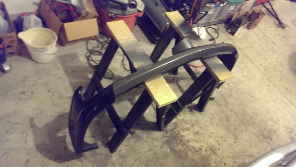

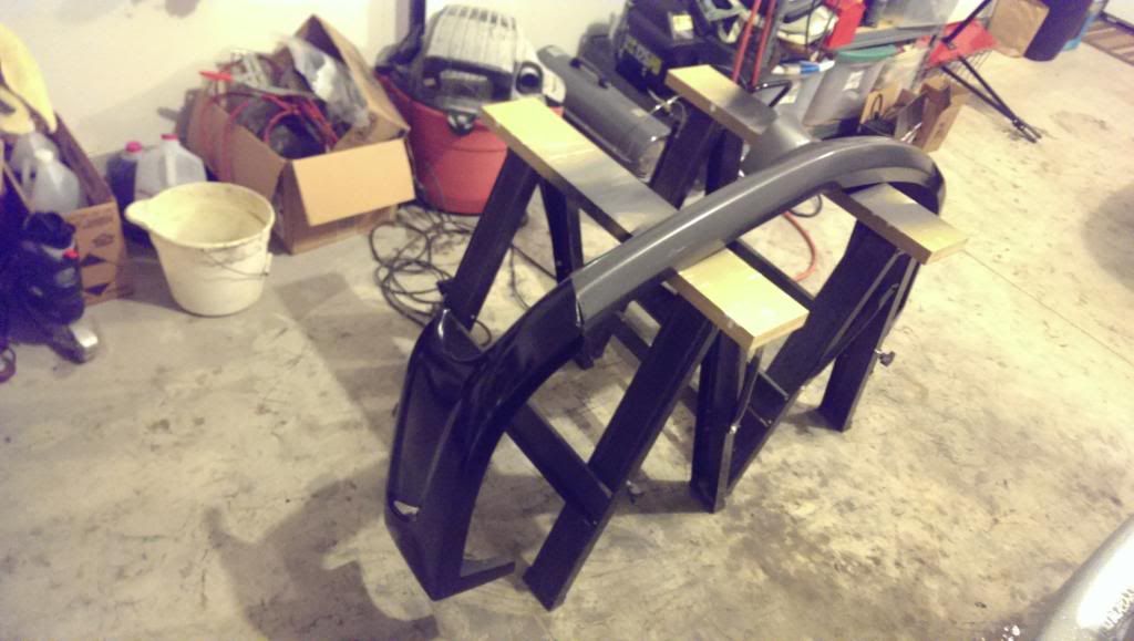

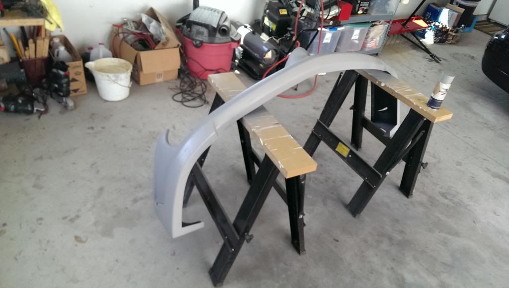

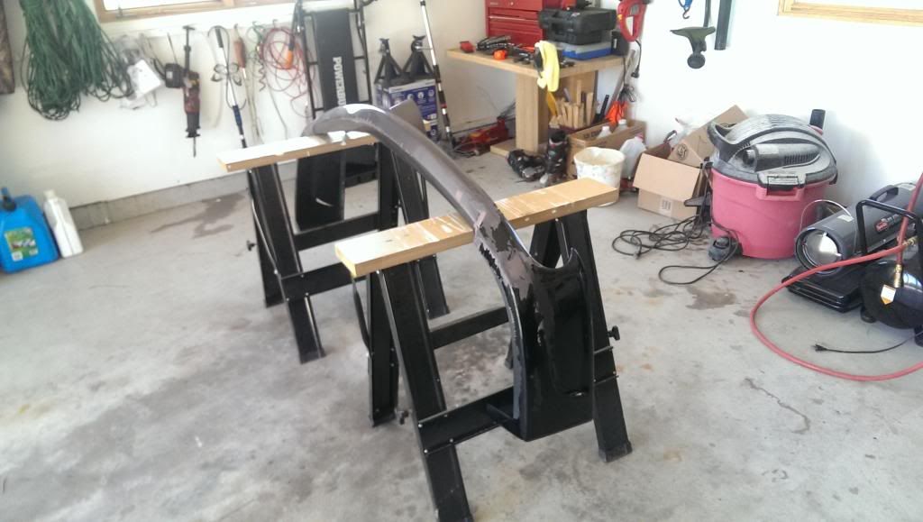

Then started working on repainting the Front Air Dam, as that was in awful shape:
Primed:
Just the black painted:
Working on the silver middle part, used the stock color code for this, WA8945:
Cleared:
Car without Front Air Dam:
Quick mock up with the Air Dam back on before wet sanding:
Wet sanded and buffed the Air Dam, isn't quite as "shiney" as I'd like it too, but still looks much better than before. It's ready to be installed again, but I'm leaving for an Alaskan Cruise tomorrow morning for a week. Which also means I'll be missing the big meet in detroit, which really sucks, but this is a once in a lifetime trip I got for free.

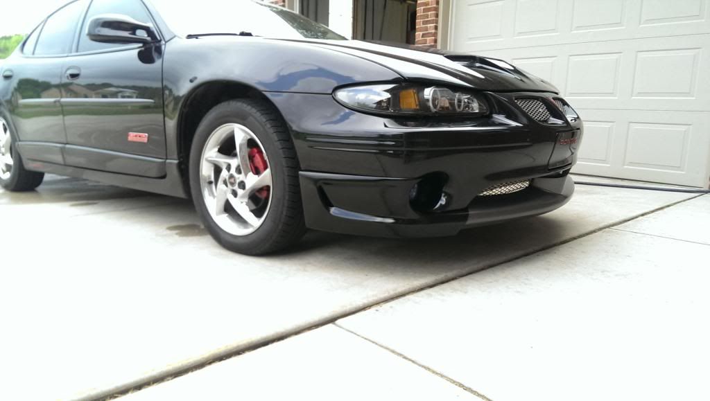

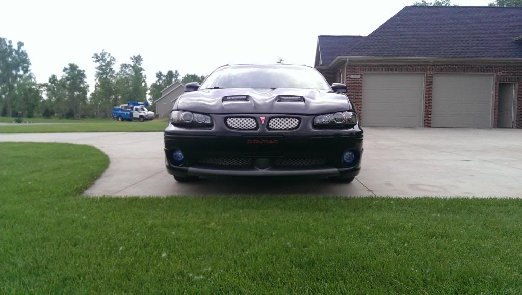

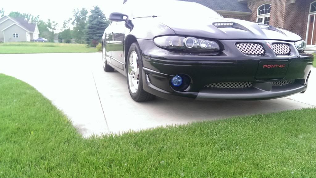

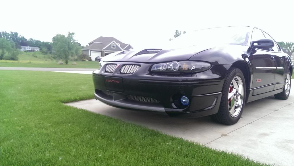

Did a few finishing touches and the car looks 100x better than peeling paint every where and rust.

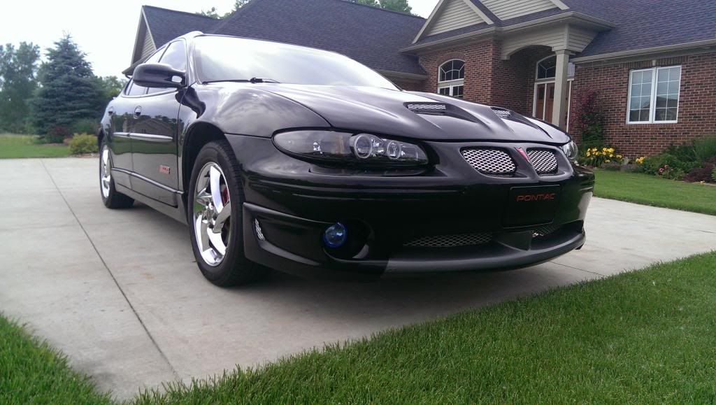

Add the grilles to the hood again and also added it to the front air dam:
Clean gas cap:
Blurry pic:
For a garage paint job, the front air dam turned out alright. Much better than before, but nothing like a body shop could do. As long as it looks good cruising down the road, I'm happy.
