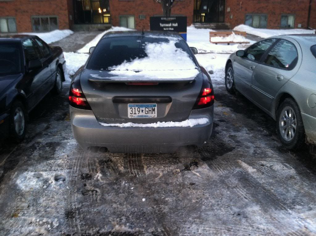

negative. not yet. don't have clear coat, paper, and compound with me at school. took it home over xmas because it was going to be too cold to do anything outside... clearly i should of kept them.
just got back in from putting them back on the car.
and yes.. the honda is my roommates right next to mine...
