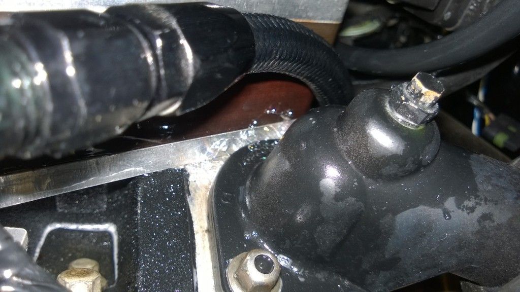

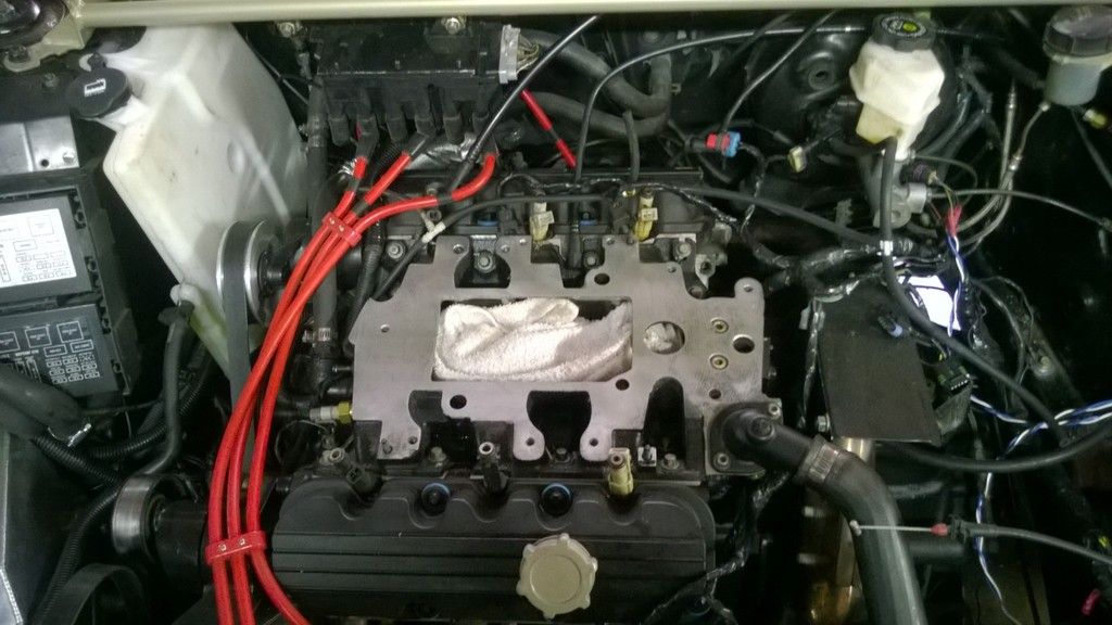

This brought me to the next issue. Map is only reading ~90kpa at idle. In the past I have sprayed carb cleaner around the engine to try to narrow down vacuum leaks but that is not an option for me as everything is freshly painted. So I came up with this:
Found a massive leak on the #5 injector. That was by far the biggest leak and probably most of the problem. Second biggest leak was at a defective vacuum T. And there was a small leak between the SC and IC, and one between the IC and LIM. For the record, Ed's intercooler came pre-sealed and did not have one leak, it is a very high quality product, and I don't suspect it to be causing the leak on the outer sealing surfaces. I pulled everything back apart, cleaned up the sealing surfaces even better this time, and that's where I left off today. Excited to finally be getting all the bugs worked out. Fingers crossed that it seals on my second attempt.

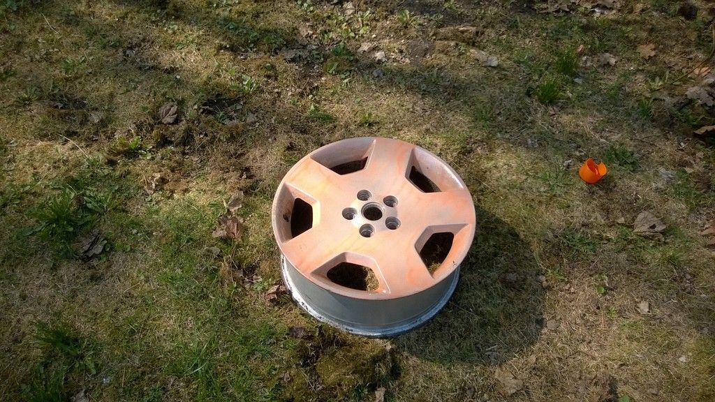

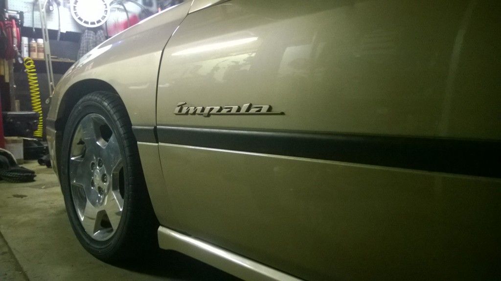

Oh snap, I never posted the pics of the wheels and tires!
Bridgestone Potenza S-04 Pole Position. 245/45/18 on stripped and polished 08 SS wheels.

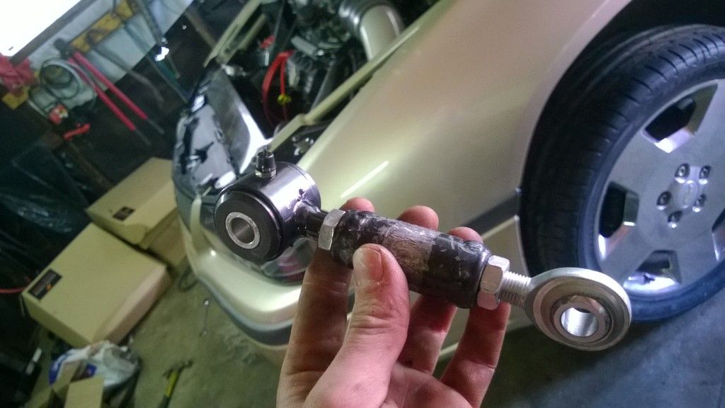

Also replaced the lower heim joints on my front engine mounts with poly bushings. Dampened it quite nicely but does not allow any movement. Not as worried about the vibrations fatiguing the metal.

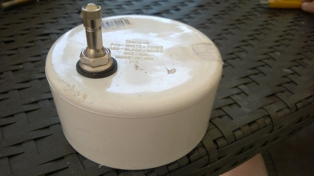

4" OD PVC cap (for a n*) with a hole drilled for a valve stem. Clamp it in a coupler to the tb. Have a buddy put just a few psi onto it and spray soapy water around the areas where there may be a leak and look for bubbles.
I did a redneck version of that, but as a smoke test. Get a nitrile glove and stretch it over the TB, pull the brake booster hose from the booster with the check valve attached, attach a clean hose to the check valve, spark up smoke device of your choice, and blow in the clean hose. After about 2 or 3 times of blowing smoke in you'll see the leak if you have one.

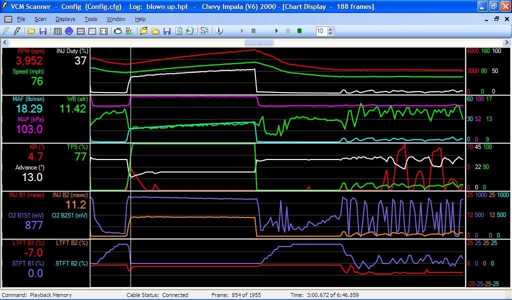

Well, I think I may have rod knock now? Was out tuning and did a pull to 6400ish rpm with no knock. Did another and had a blip of kr that was 5.4 when I first dipped in to the throttle but nothing else up to 6400 rpm again and now it is knocking and is showing a lot of kr. I've never heard rod knock in person before so I don't know. I pulled the plugs and all looked fine, none were smashed. Took the SC belt off, still knocks. Going to drain the oil and check for metallic flakes next. I don't think its a chipped piston, maybe an rpm related failure? Possible that it's the harmonic bancer? Collapsed lifter? It still has great oil pressure and never lost pressure.

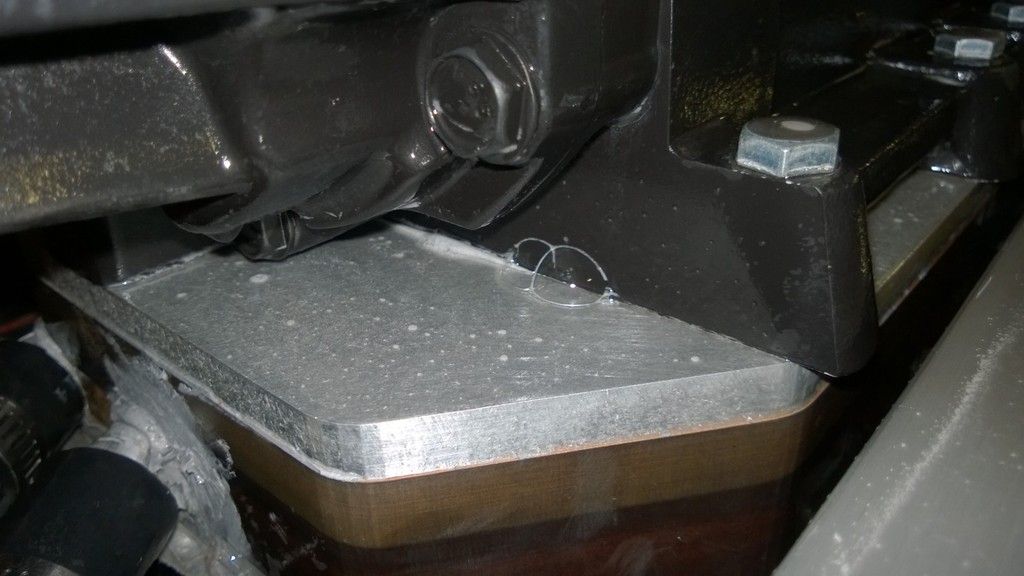

L67 short block is almost ready to be assembled. Spent a good part of the day fabricating baffles for the oil pan. Almost done with that.
