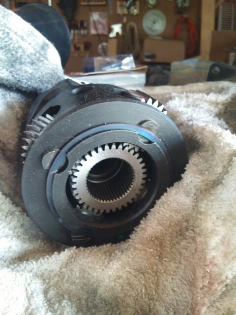

I'll sell you mine. PM me your email if you want pics. After doing some 0-60 pulls yesterday I don't think I need anything shorter than the 3.05's I have.
Hmmm ok give me a bit after talking to billboost and now overkill i gotta count the sungear on the diff in my shed.
overkill says in our conversation:
3.29 diff on 37/33 gears = 2.93 (all HD transmissions, for example. 3.05 diff on 37/33 gears = 2.72 your current ratio.
I just dont know which gear is the sungear.bill boost gave me a diagram but im still confused lol
That's mine BTW. Have more pics of it. No chipped teeth, came off an 80k gt. I paid 15 (pulled it myself and that bracket that covers the diff cover was not exactly fun to get off) and will sell it for 20 plus whatever astronomical shipping rates it costs to ship to your continent. Just trying to help a fellow imp owner. I would recommend getting the HD version with cover honestly. With your 1:1 drive gear set you get the best of both worlds, stronger diff and nice 3:29 FDR.
