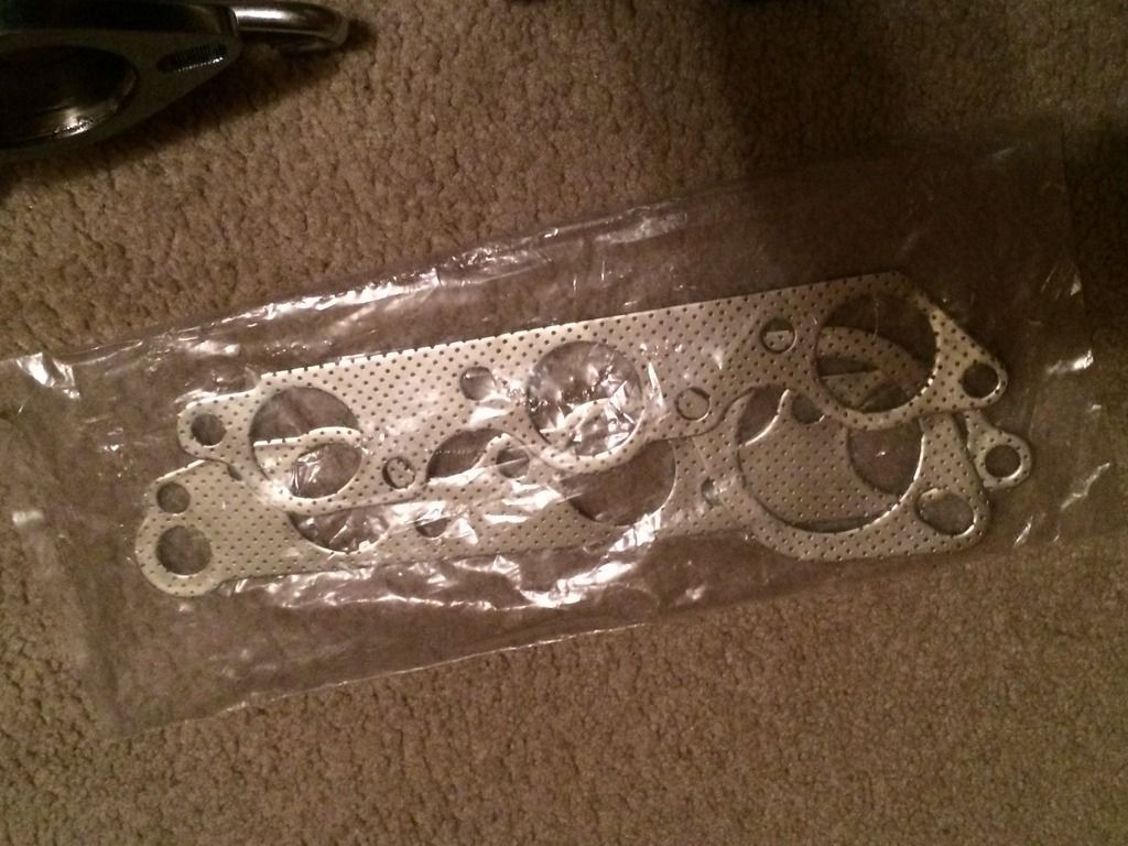

No, I will not be using the gaskets except for the piece that replaces to the u-bend. And no I will not be using those clamps either. Unless they really aren't as bad as people say.

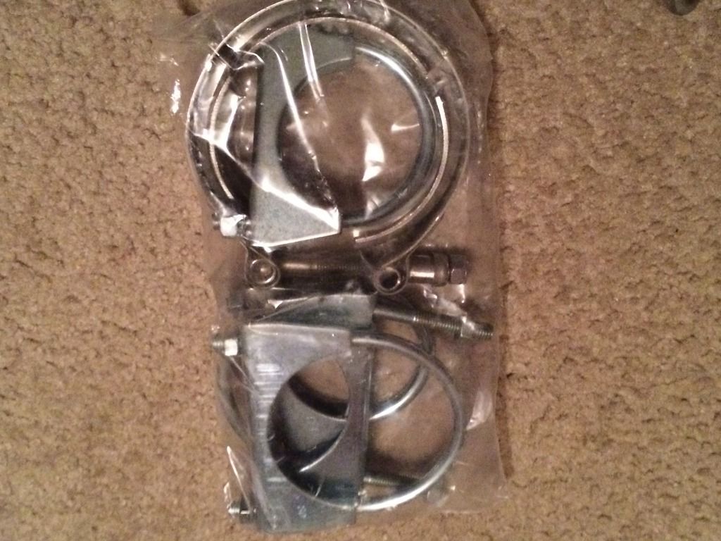

Frozen boost for the new clamps if you are looking for the best prices and pretty fast shipping. Reuse the stock gaskets.... just wipe them down and use the install thread. If you do the position, tap, tap tap, wiggle tap method..you'll have the least leaks of anyone you know

I reuse that flange gasket at the very end too? I don't know what the "tap, tap, tap, wiggle tap method is.

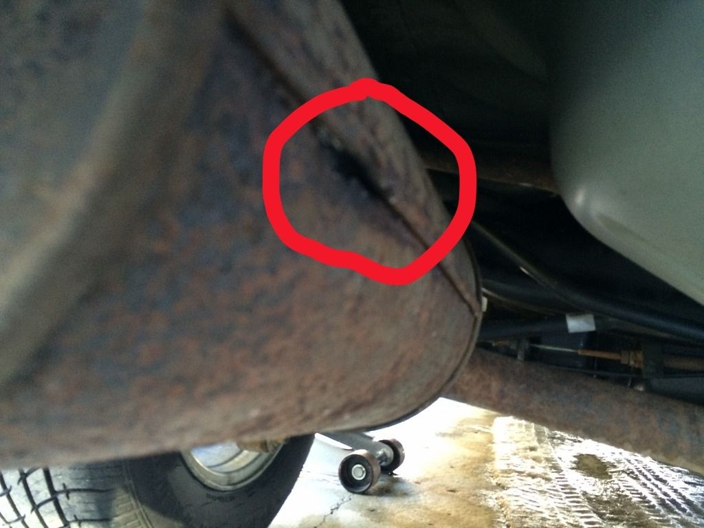

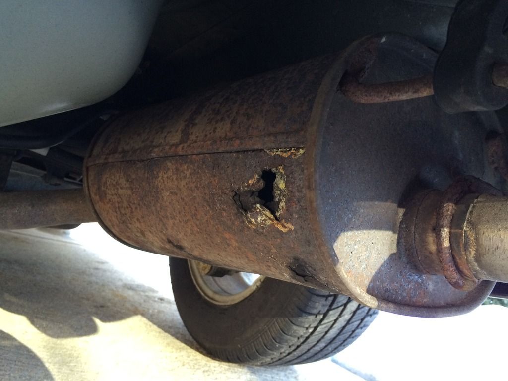

Well I've found the exhaust noises....
This hole wasn't the noise I was thinking of though. But when I covered that hole, the whole exhaust noise got quieter. But not the "tick tick tick" I was searching for. But then I looked on the other side and found this:
When I covered this up, the "tick tick tick" noise went away. And that would explain why I only heard it on the driver side muffler. So both my mufflers are shot. I probably won't replace them until it gets too loud, or until they just fall apart.
I can make a video later and demonstrate what I was talking about.
Re: Smelly Fish: Big plans
Mine hardly had anything left on bottom of the muffs, lol. And without a cat or res she droned and popped on WOT like everything...
Alrighty lol. But the first hole makes the exhaust sound good. It gives it a deep rumbling sound lol.
