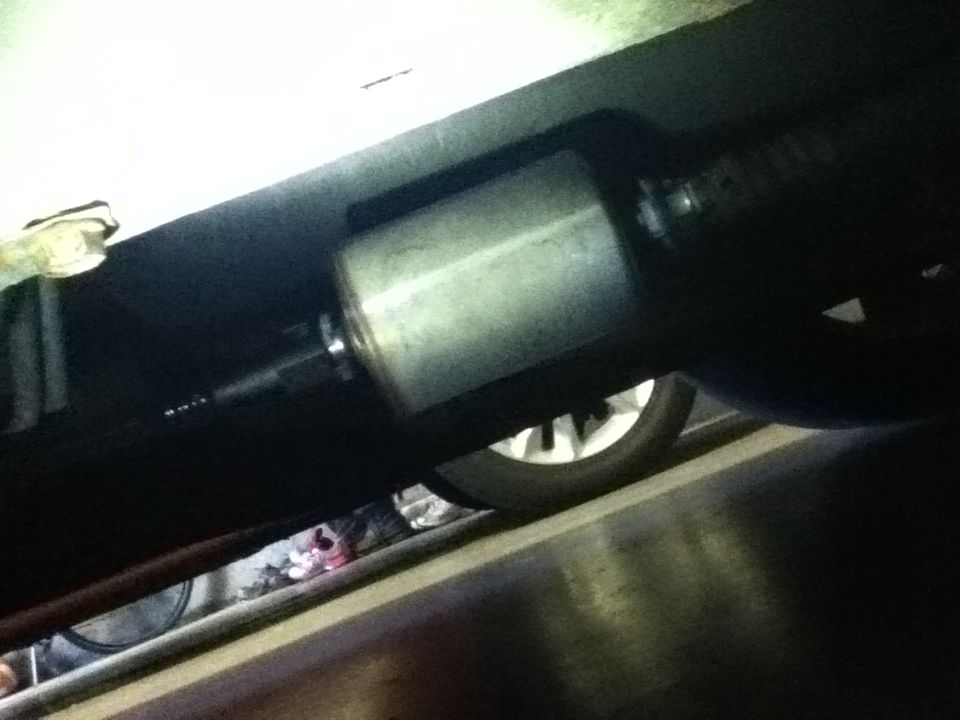

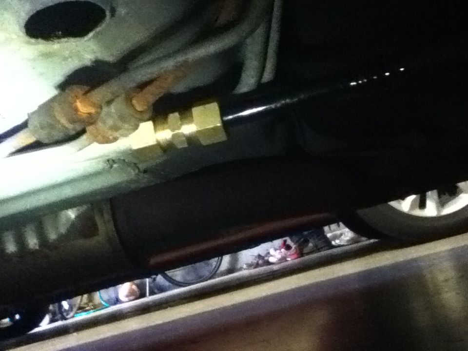

Shout out to HighOctaneRacing and turbomike231 for the write-up for the fuel filter upgrade. Everything went well, just needed to tighten up the fitting until it stopped leaking, but it is all leak free now.

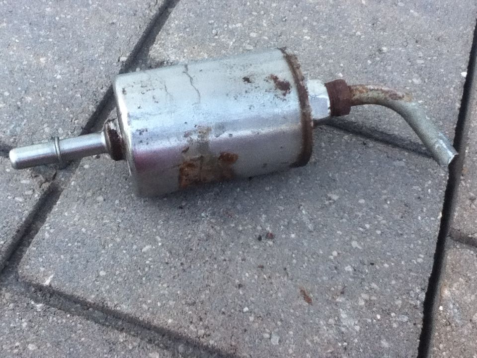

The old filter:

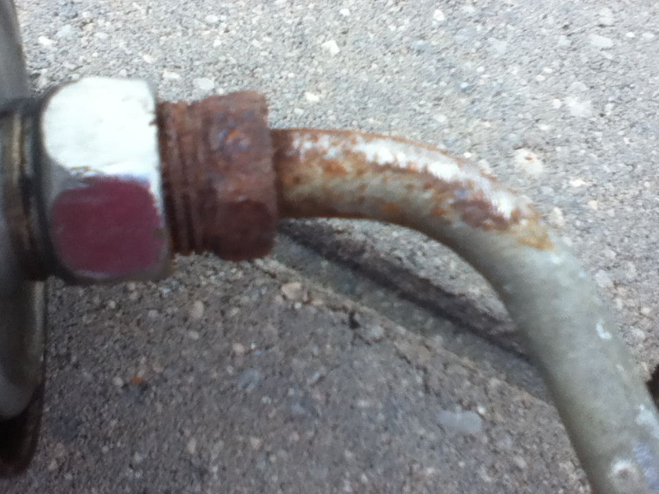

The threaded end was the rusty part that caused this upgrade.
​Thanks again to everyone who helped!

You didn't upgrade anything. You merely replaced the metal line and added plastic. Personally, I'd put a piece of rubber hose over that plastic line.
We gotta talk if you couldn't get that off. That's not rusty for a GP line.

How is that not rusty? The whole thing is covered in rust. Plus I was starting to strip the nut on the threaded coupler.

There is a smidge of rust on that. It's mostly good though. Search around, there's guys who looked at their lines and it started dripping.

I tried loosening the nut, but couldn't do it. This new filter will take 2 minutes to swap out.
Re: Meatball Sub with Pickles
if you read any other filter swap threads, you would have seen that you vice grip the line nut, then turn the filter, not the nut. that would have come off.
It's done and that's all that matters now. But I still need to zip tie the new filter. It is just dangling there.
Yeah..dangling filter on plastic lines that are held on by a compression fitting is a great way to cause a fire.
Lol, the first time I srarted the car, I didn't tighten the fitting enough so when I started the car, gas was pouring out from the fitting. Then Scotty told me to tighten it up and low and behold, she's leak free. But I will probably wait until after school to zip tie it. But what a difference does the new filter make!
