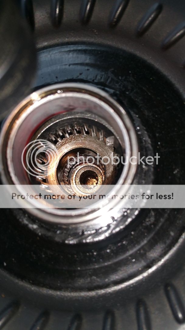

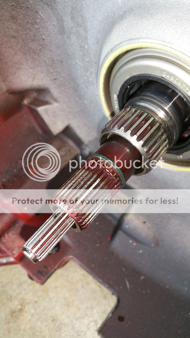

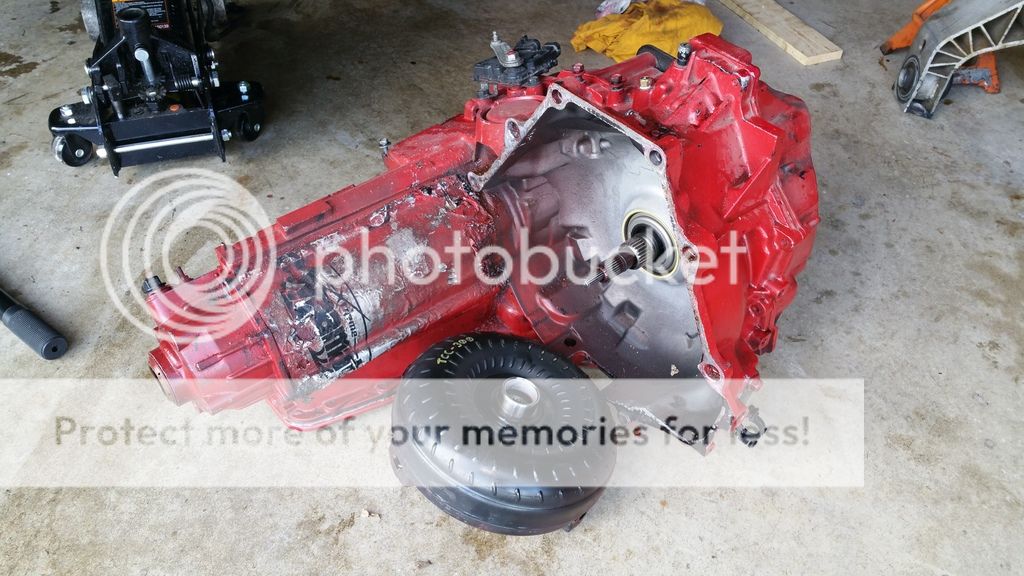

Just as gmr said, it spun the splines off the torque converter
***** power does that
so new tc and vroom vroom ?
Depends on the amount of shrapnel floating around. Dave (tep) will be at reptiles this weekend so I will take the trans up there and see what he says. And do some drinking of course lol
