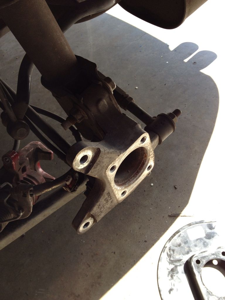

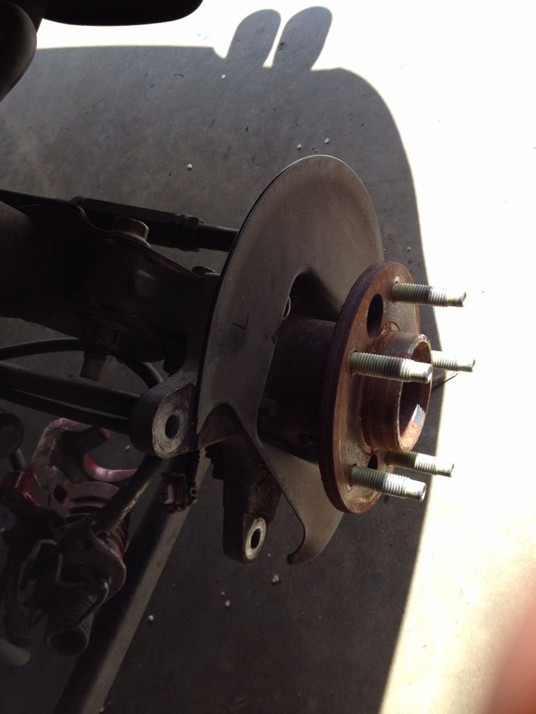

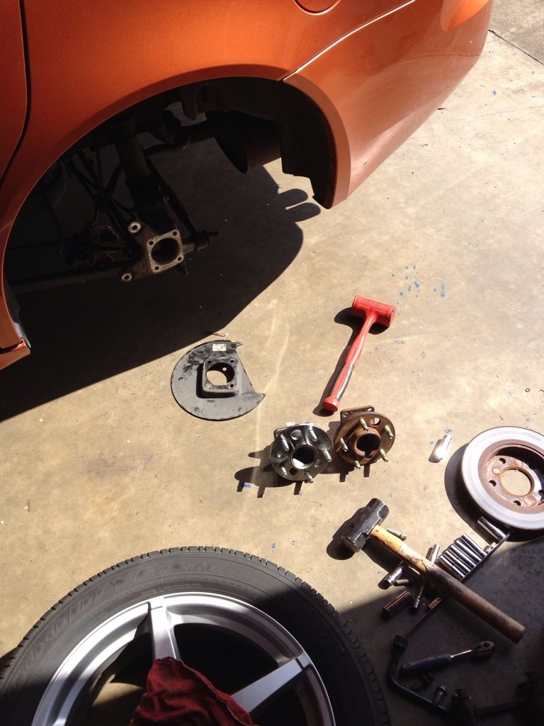

Well she is broke down again...rear wheel bearing started growling last couple days got it off the ground today and its pretty sloppy lol..back to driving my toyota

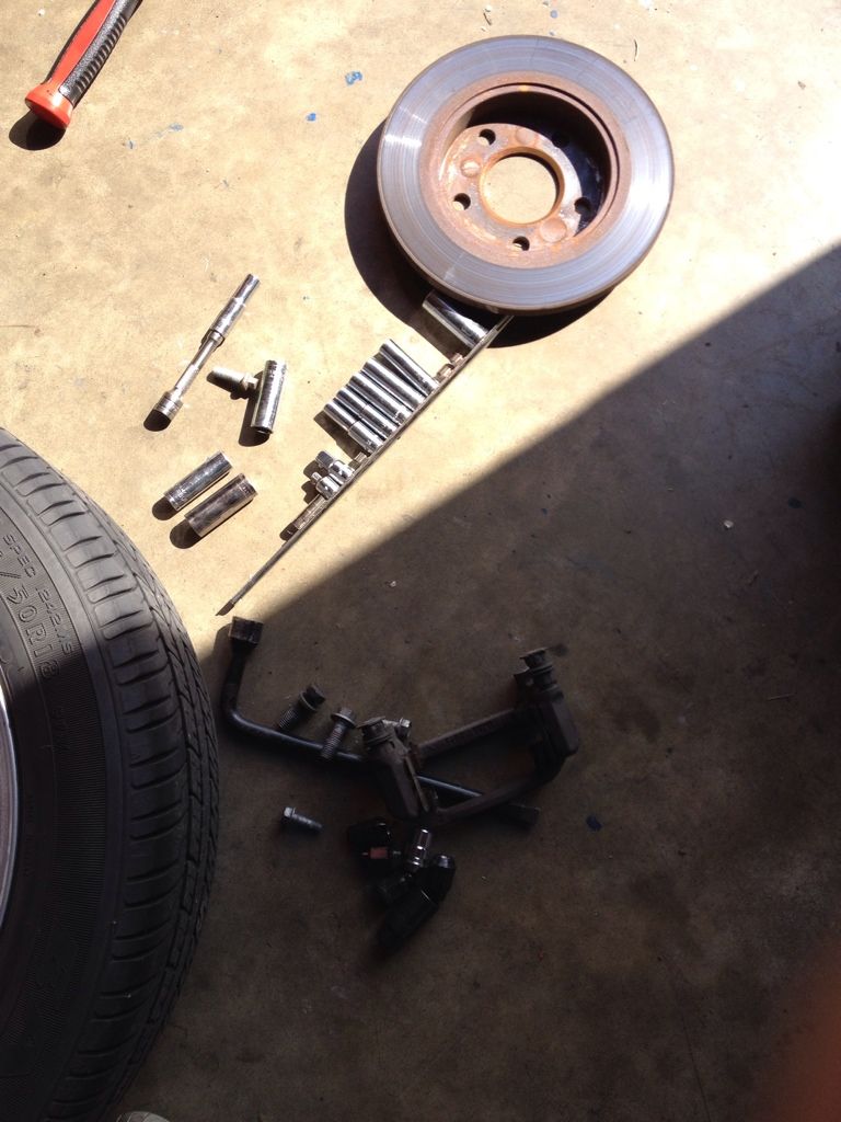

Installing another wheel bearing SPO grills this week...found a couple pics of my old car lol

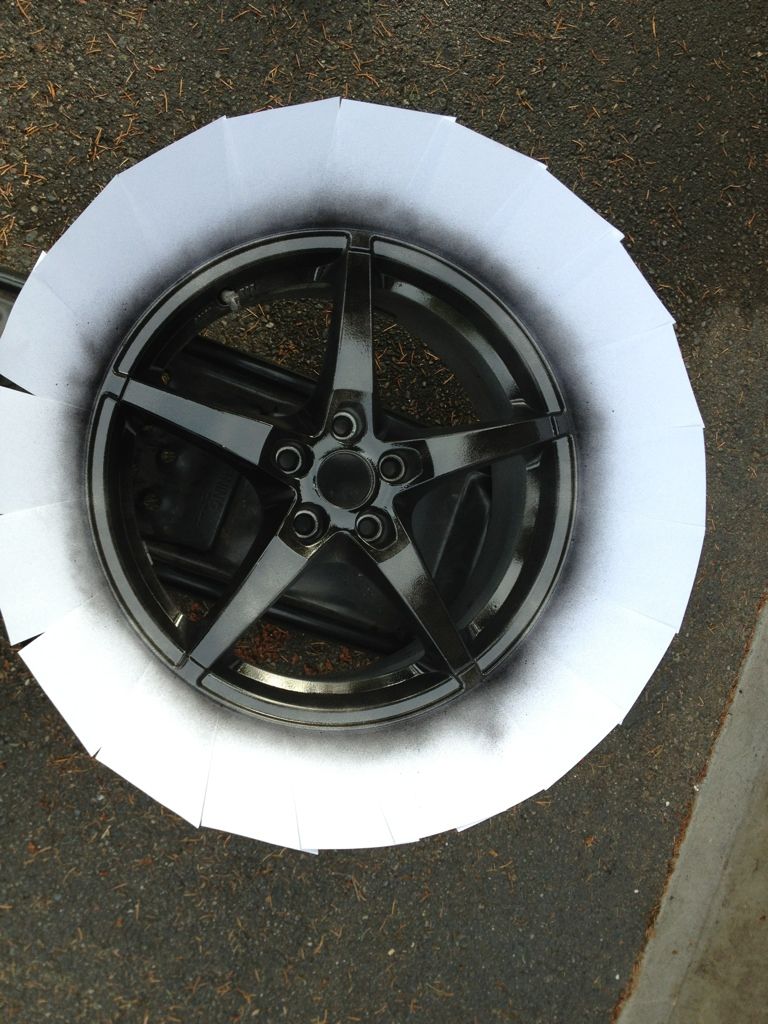

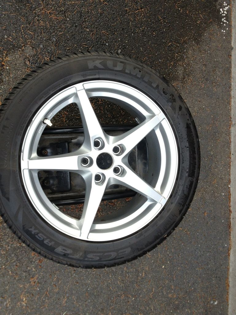

Currently throwing plastidip on my wheels for a new blacked out look...looking to order some 3m carbon vinyl and do a few little things...will post pics later tonight

Here are some pics of my current GP project...once the wheels are done my wheel bearings should arrive to replace the other 2 that finally went out
