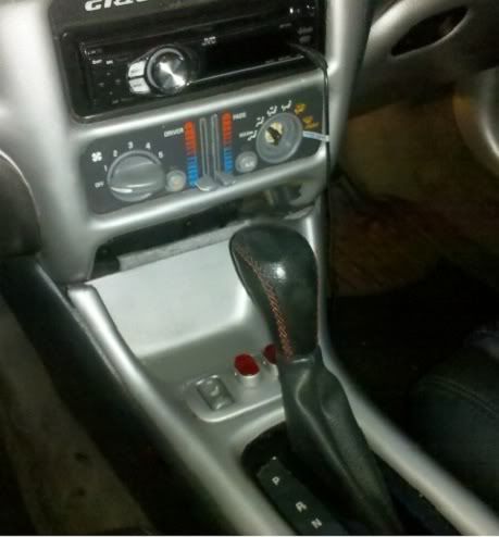

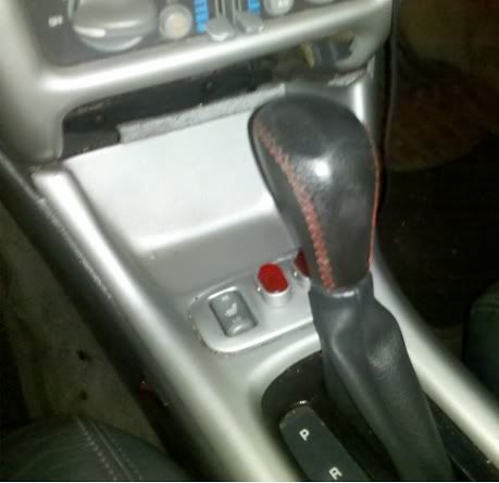

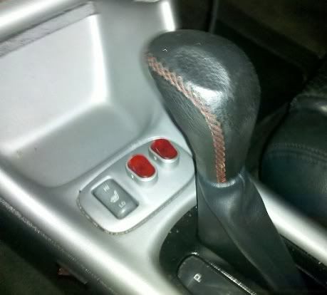

Here's the shifter, sorry bout crappy pics, took them with my droid this morning...Also mind the missing knob, and the EQ not being under the dash.
It's really comfortable, and doesnt move around at all.

so basically you just got rid of the shift lock button? if it doesnt move around then thats what im doing. not having that button leaves me open for more possibilities.
Basically, once you take the shifter off, theres a small metal shaft with a yellow hard plastic shaft inside of it. When you squeeze the shifter(button) it pushes that yellow shaft down, releasing the shifter, so you can change gears.
All you have to do it manage to keep that yellow piece held down (I used electrical tape) and it's worked fine for...bout a year now....
