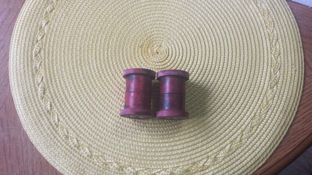

So trans should be going in 2-3 weeks. got the poly mounts installed yesterday
Also found a deal, its overkill but i figured why not, stage 1 high velocity l67 TB, also a l67 throttle body spacer which i know doesnt do anything BUT it does let me install the ZZP stage 1 l67 TB hassle free, month from now overkill is coming back to ontario so ill install it then and get him to dial in the new tb and SD headers I installed years ago lol. also getting poly bushings to complete the poly setup.
probably not much gains to be had but w.e it was dirt cheap and im bored lol.

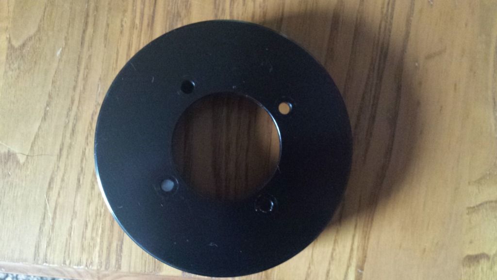

Zzp l67 stage 1 HVTB should be here next week and also grabbed a used zzp underdrive waterpump pulley for cheap to free up some hp. Us n/a guys need all the help we can get lol.

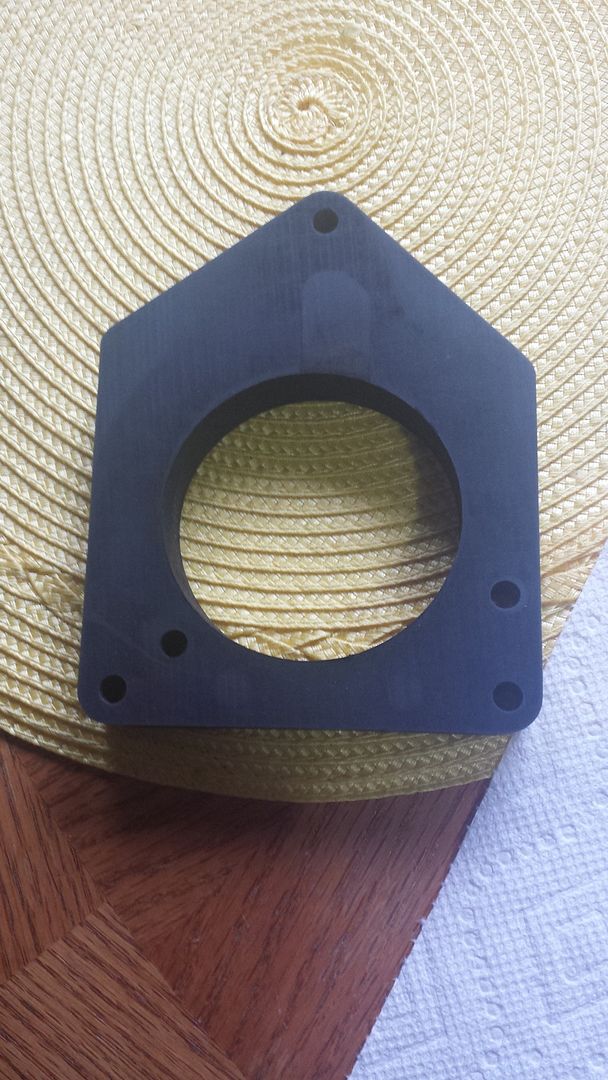

parts are here.
the zzp l67 hvtb, 72 mm so 7mm bigger then my stock one, gotta wait for overkill to tune it got him booked on june 22nd, bought a new 4'' k&n filter and made a new 4'' open cone setup.
$10 used poly bushings that are on the car already so poly setup is done now
and the throttle body spacer so i can mount the tb on hassle free.

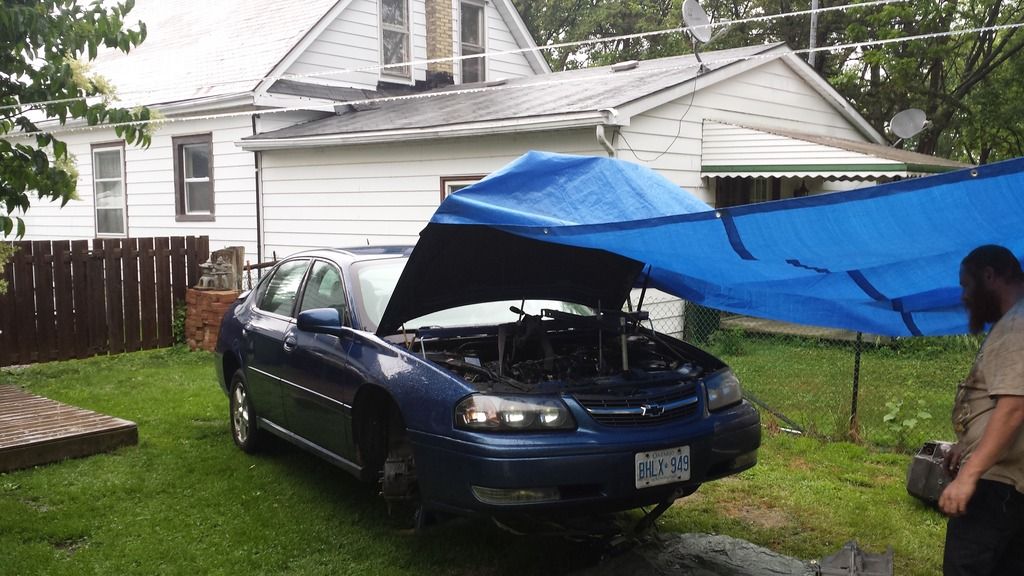

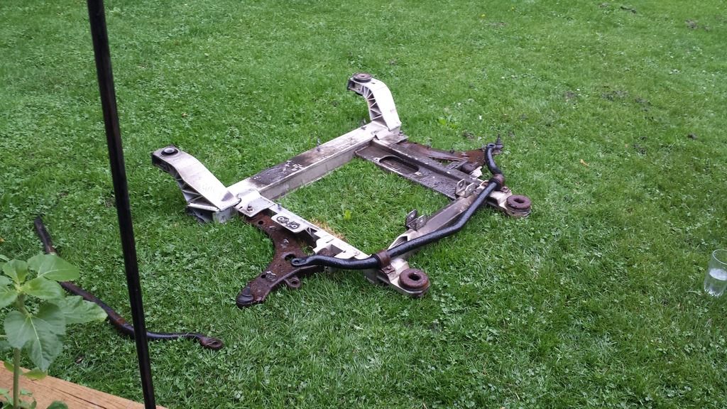

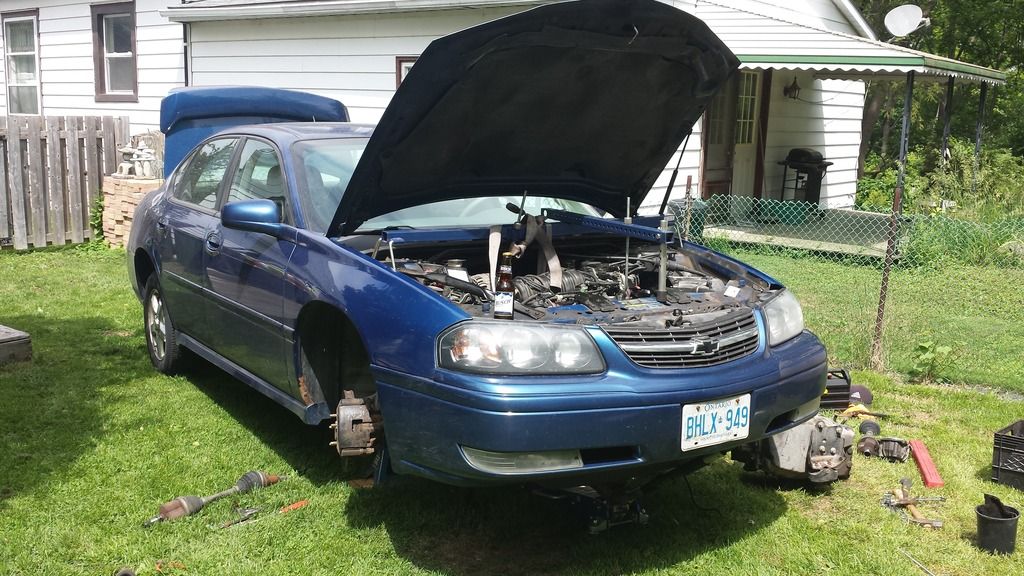

So lots to update on
New transmission is in with a transgo shift kit! with only 6000km on it shifts threw the gears quick and firm with the trans go kit.!
first day we got the trans out, then my buddy had to leave early.
second day it rained ALL day
new gmpp sway on
was together for 2 days then got a set of ER rockers. got those installed with the zzp l67 high velocity throttle body yesterday.
so now just gotta drive it easy tell the I get a new incar tune from overkill this saturday.
