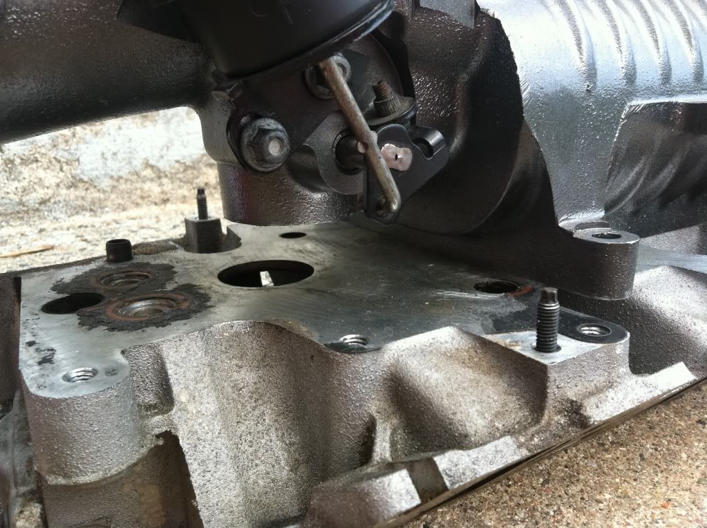

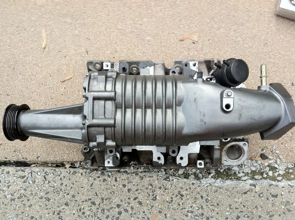

Okay so the M62 came and I have good and bad news.

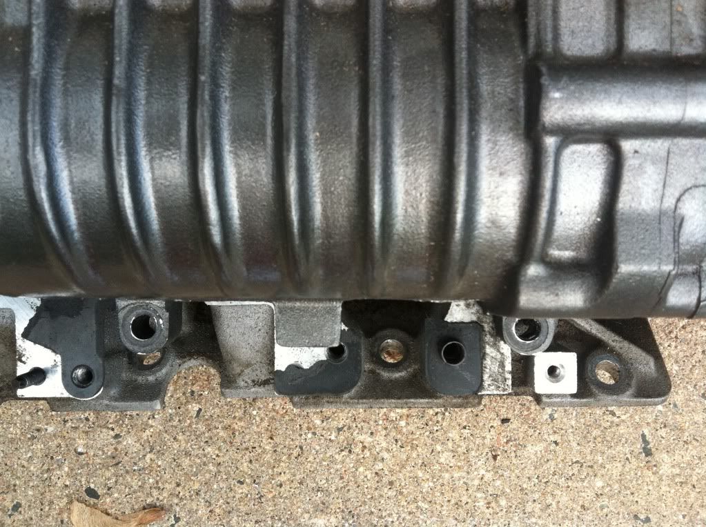

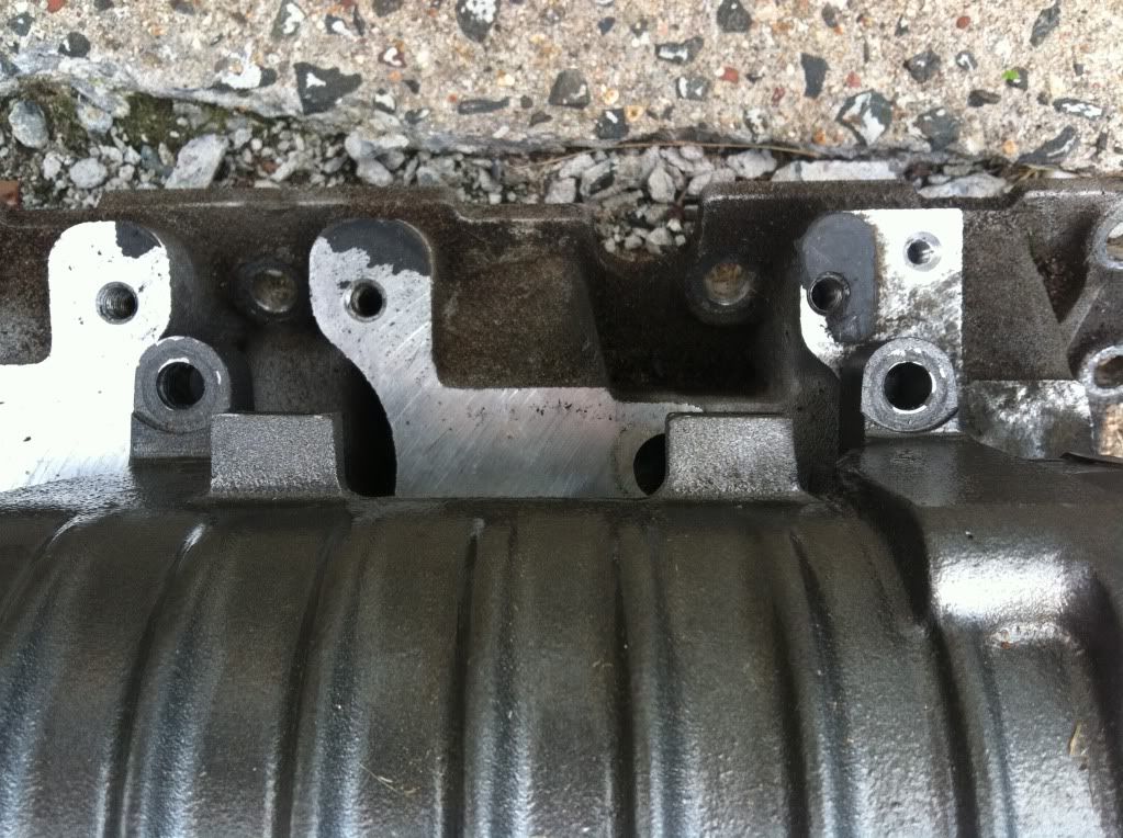

The bad news is, it's 99% likely that I'll need a completely custom adapter plate. The holes simply don't line up and the M62 will need to sit a half inch closer to the belt so the pulley is aligned. It's off by exactly a half inch.
I'll need to cut the LIM about an inch back where the boost enters and then put a plate over the entire thing with the correct bolt pattern for the M62.
The BBV is going to be a pain, as you can see in the pictuer it's just open space between the blower and LIM. I'm going to need to hack the LIM open because they don't land straight and weld some sort of collar on the plate to attach the two. I have the BBV port from a Cobalt, so maybe I can somehow weld it to the plate.
Good news! The throttle body will fit 100%. I have an old GenV TB here (drive by wire) and it bolts on flush. So my N* to GenV adapter will work, no issue.
Aside from needing an adapter plate of some kind this looks like it's going to work.
