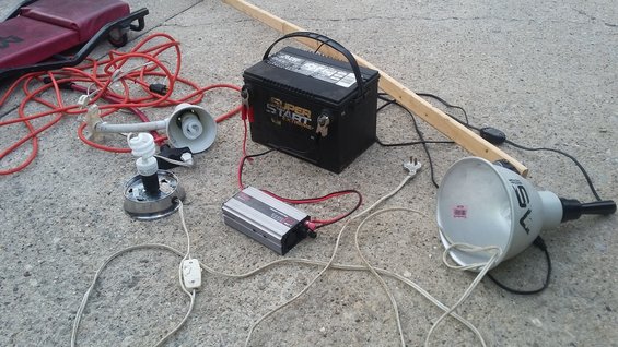

My lighting rig. Used a bunch recently:

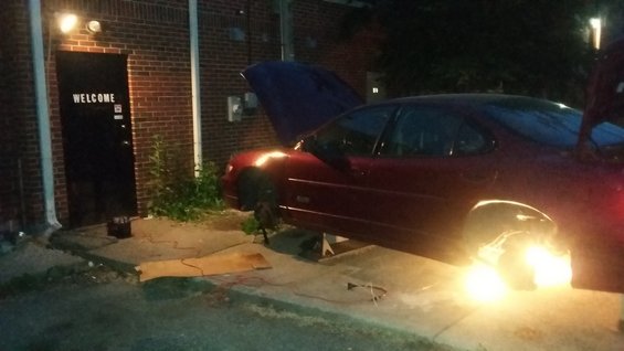

How it looks at night:

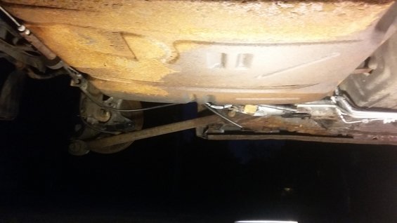

Tank looks wet. Hmmm.... wetness doesn't smell like fuel. But maybe tank should be changed out anyway. How hard it that?

My tanks fine and looked no where near your guys does. knock on wood.
Mines not looking so good. Although that wet spot smells nothing like gas. Gonna have to do research on how to replace it. See how difficult it might be.

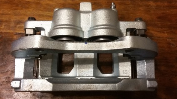

Picked up some nice re-built Calipers from this place out here in the city. They specialize exclusively in calipers. Only place like it as far as I know. I had planned on re-building the ones I had myself, but after researching it, and reading how everyone complained about how much of a pain it was, I decided against it. I just don’t have the patience for some things, and this seemed like one of them.
They sure are pretty! Re-built OEM. Zinc platted. Dust boots. Guide pins. Pad Clips. Crush washers. Everything except the banjo bolt. $177 out the door for all 4 calipers:

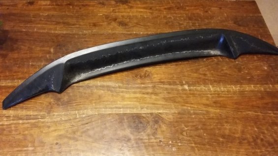

Picked up this special edition spoiler from RareGMFan back in early June:

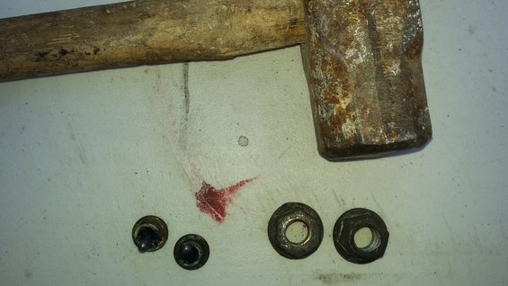

Got the trailing bolts out. What a b1tch. Bent back the rusted azz backing plate and pounded the fu**ers out with a sledge hammer. Heated and pounded like an angry gorilla:
Straight up junk:
Man did that nut get messed up. Used it for both sides so only damaged one nut. Bolts are fine. These little piston looking things fell out from the e-brakes as I hammered. Got them back in though:

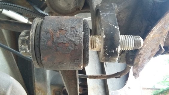

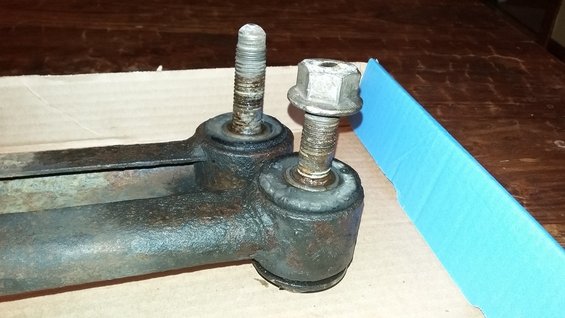

Couldn't get the bolts out again. This time they're stuck in the trailing arm itself. Soaked them in penetrating oil. See what happens. Bastards, these bolts are:
