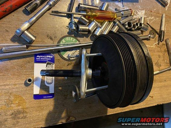

In my case, I had to use JB Weld to remove the balancer so I need to get a new one anyway. Sucks. They ain't cheap :|

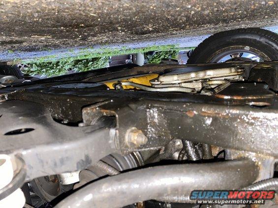

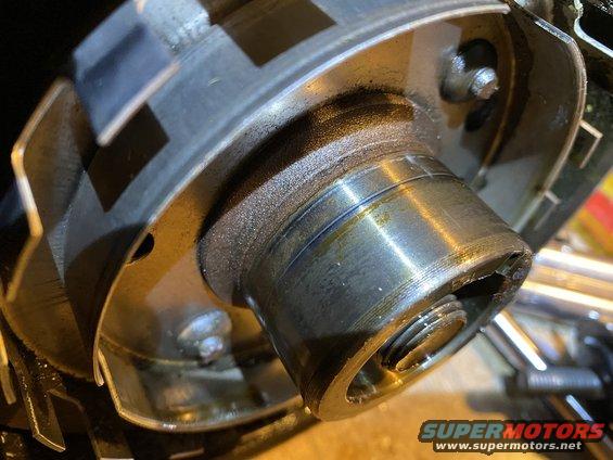

Here's some pics of how the bad the oil leak was. It was dripping all the way down the subframe. The motor mount bracket hole was a pool of oil. I pulled the balancer, took me like 3 days. Yes, 3. Problem being that 1 of the bolts kept popping out threaded holes in the balancer. Threads were Fuk'd! Ended up putting globs of JB weld on that bolt and going full ape of torqueing the bolt into the busted threads. I let the JB weld cure... And finally got it off. It was awful. I was starting to panick that it wouldn’t come off…. Anyway, deep groove on that balancer shaft.

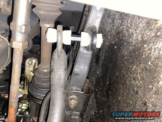

Also included a pic of the correct way to install subframe links. To add to my woes, I somehow lost the lower trim from the passenger door. Arghhh

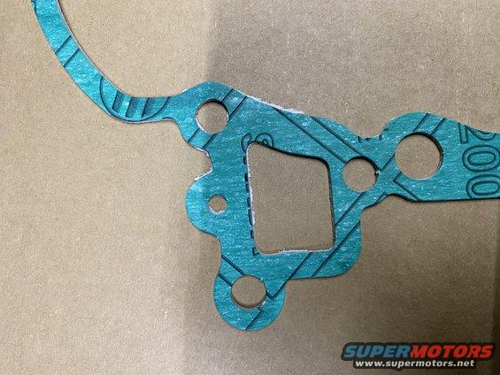

And the gasket that ZZP sent me is a little janky I think....

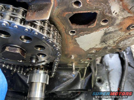

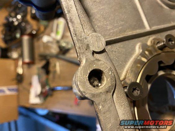

Made a dumb mistake. Broke a bolt off, in the block :| Started bolting down the front cover, but didn't remember about the crank sensor and the 1/2" of distance the bolts would need in order to hold it on. Well, wasn't thinking really, bolt wasn't getting close to the timing cover (cuz crank sensor was missing) and I kept tightening, and snap. Didn't take much force either. Very disappointing. Pics below. My plan is to just forget about that bolt. Have about 3/4" of threaded bolt welded to the front cover itself, to at least hold the sensor in place. And hope the other timing cover bolts hold the cover in place well enough to have no leaks. RTV the shyt out of it too. Sucks though.

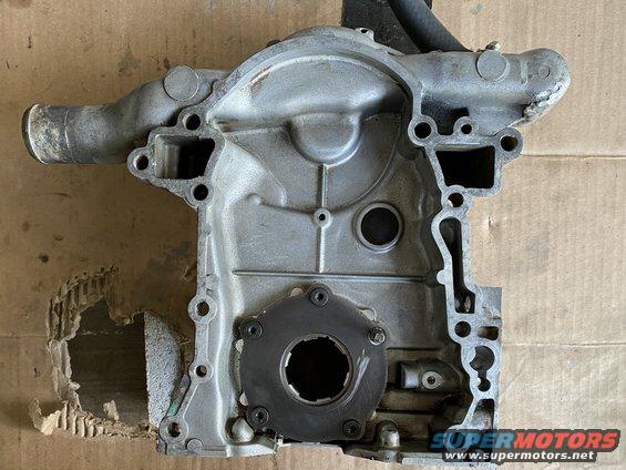

Now that I have the front cover off again, I decided to mill down the oil pump cover since it's for sure being nicked by the chain. Which explains the metallic "TINK-TINK-TINK" sound that I've been hearing. You can see the circular scratch in the pic. It's a ZZP cover, supposedly milled down .020 already, but you know how ZZP quality goes. It will be milled down another .015. But anyway, when trying to take the cover off, one of the bolts holding it in rounded on me. Dammmn it. Tried J/B welding the torx socket directly to the bolt, and tried it 24hrs later. Snapped right off. WTF.

In the block: Grind 2 small flats on the stub and grab it with vise grips. That probably won't work but it's a good first option. If that doesn't work, Grind what's left of the stub dead flat. Center punch it. Start with a small (1/8") drill right down the center. Progressively work up to a larger drill until you release the tension. You can go up to and maybe a little past the tap drill diameter and be fine. Even is you chowder the threads, it's better than no threads.
In the cover, Drill the center of the head out. Just slightly larger than the major diameter of the fastener. (8mm?) Once you release the tension of the fastener, it will thread out with your fingers.

Thanks Brandon! I tried the vice grips. There's enough there to grab with grips but that bolt would not budge not matter how I grabbed it man. I tried drilling it too, that worked, and then the drill bit snapped off in the hole! Yep....****yyy. I just can't catch a break man. Was thinking to drill a hole big enough for a self-etching screw and call it a day. But I couldn't even get that far. I'm fairly confident that the other bolts will hold the timing cover in place just fine. I really really hope.
For the pump cover bolt, I'm going to have the welder/mechanic just deal with it and get it out for me. I would usually just do it myself, but experiencing some 3800 fatigue at this point with all these problems. Even if somewhat self-inflicted. Car has been off the road for 1 month now :\

Oil pump cover was removed and milled another .015 , for a total of .035

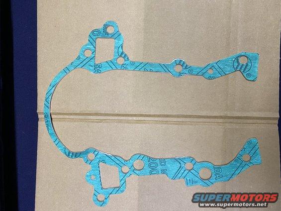

Everything is back together now. I sprayed with cut gasket from ZZP with sealant, sandwiched it between 2 FelPro's. Got the new seal installed and pump was primed. I was worried about debris and crap have gotten into the oil/oil pan. Even though id di seal it off with tape. But out of caution, I drained the oil after the repair was finished. Poured in fresh oil, ran that for 100 miles, and not changed oil again, filter too.

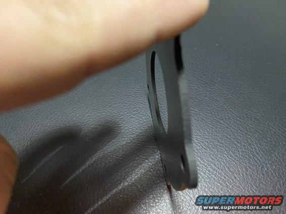

the cam sensor issue ive seen with too thick of gaskets. one reason i just gently grind the pins at the peen, machine the cam and crank gear and use the silicone steel coated felpro and one oem t cover gasket stacked. i also adjust the magnet tangs for minimal slop in the crappy sized cam gear hole in the jp/rollmaster.

Good tip man. Thanks. Getting that sensor ear machined ASAP. The gasket being too thick definitely crossed my mind. Especially that extra special gasket samwich I put together. I tightened the bolts an extra 2ft pounds to try and get the cover closer. If you look at the last pic in my prior post with the red gasket, you can kinda see the magnet and its crooked looking. It’s not flush. I don’t remember fixing that. Gonna try the machined ear first. Really, really don’t wanna pull it apart again.
