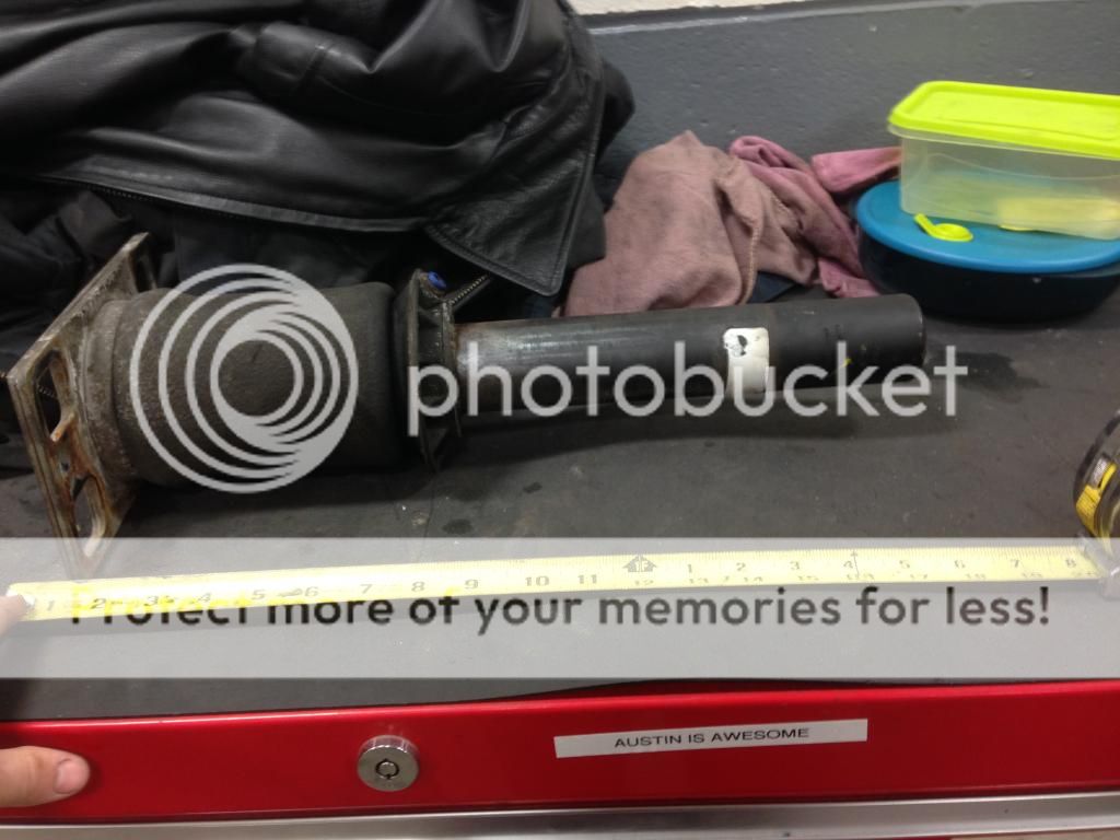

Still speculating. Pulled this off a truck the other day. Need to find something like this that's closer to what I need.
The universal kit from bag riders is the way to go. I might be able to find some part numbers but when I had to rebuild my struts for bags, I just ordered bare struts from bag riders that were way shorter than stock and just reused the old brackets.
In my opinion, its gonna be easier to fabricate brackets for the universal set than it will be to 1. salvage struts from another car 2. cut spring perches 3. figure out threaded bags/custom mounting brackets 4. make sure that everything clears 5. make sure that struts can handle the bag pressure (or else you're in for a super bouncy ride)
Reliable and cheap don't usually go together so starting with a universal kit would be my choice. Plus that comes with the support of bag riders because they know their products. They can't help much if everything is pieced together from various places
Just reuse the stock mounts for the back and you could use stock ones for the front, but fabricating something might not be too hard. I think stock mounts up front would cost you an inch or two in lowness but fabricating front mounts would be pretty easy. The ones I had were just flat steel triangle shapes.
for the price of the struts just send them to bagriders and have them send you back something complete. that's seriously what i would do if i were going with a universal route.
