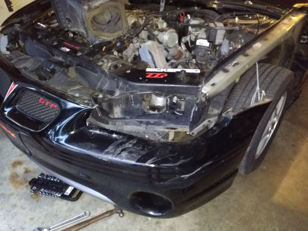

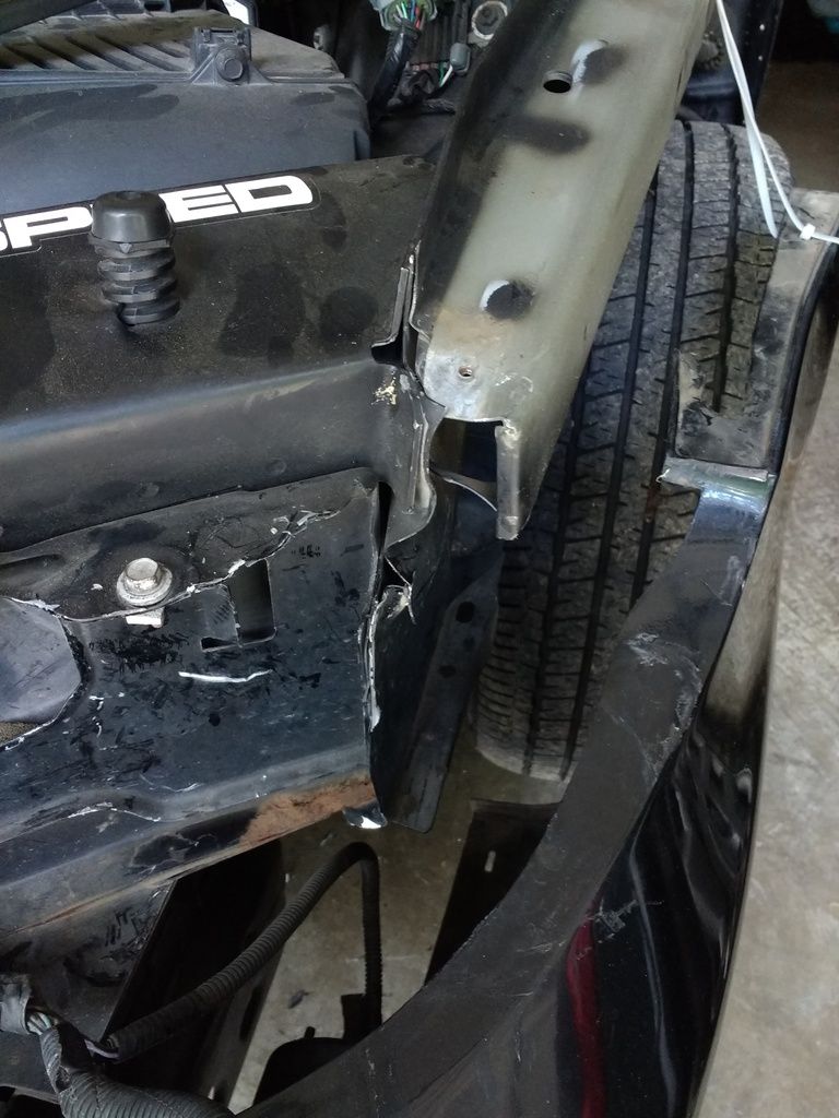

So what in here needs to get bent back?
I tried to get the metal in front of the airbox beat back into place but it's taking a while.

Hey nice work. Keep workin it. In Oregon insurers will only insure salvaged title cars with limited liability.
Harbor freight sells a cheap dolly and hammer set. It will help reworking the headlight area.
I thought it was gona be worse

Just saw this. My GT has similar damage but more severe. I put a headlight and fender on and nobody cares. Don't mess around with the inner structure too much until you have installed and attempted to line up another hood and fender, and have the replacement headlight mounting panel in hand. At that point, you can see what you gotta do to get a lamp back in it. If you want to know if the structure has been knocked out of square, choose symmetrical reference points across the engine compartment and measure in an X.
That rivet is a real buzzkill, and so is the lone spot weld holding hood hinge to fender originally. If you had not swerved a little, you may not have had that much damage up front but the airbags might have blown and really killed it. Keep your eyes peeled for Camaro brakes too if you are frequenting yards. I'll check in on you now that I am aware you had a wreck. Sounds like you just have liability insurance, yep. Thats something you should have been well aware of. I do keep full coverage on my GTP even though it has so many miles. The difference in price is totally worth it in these situations.
