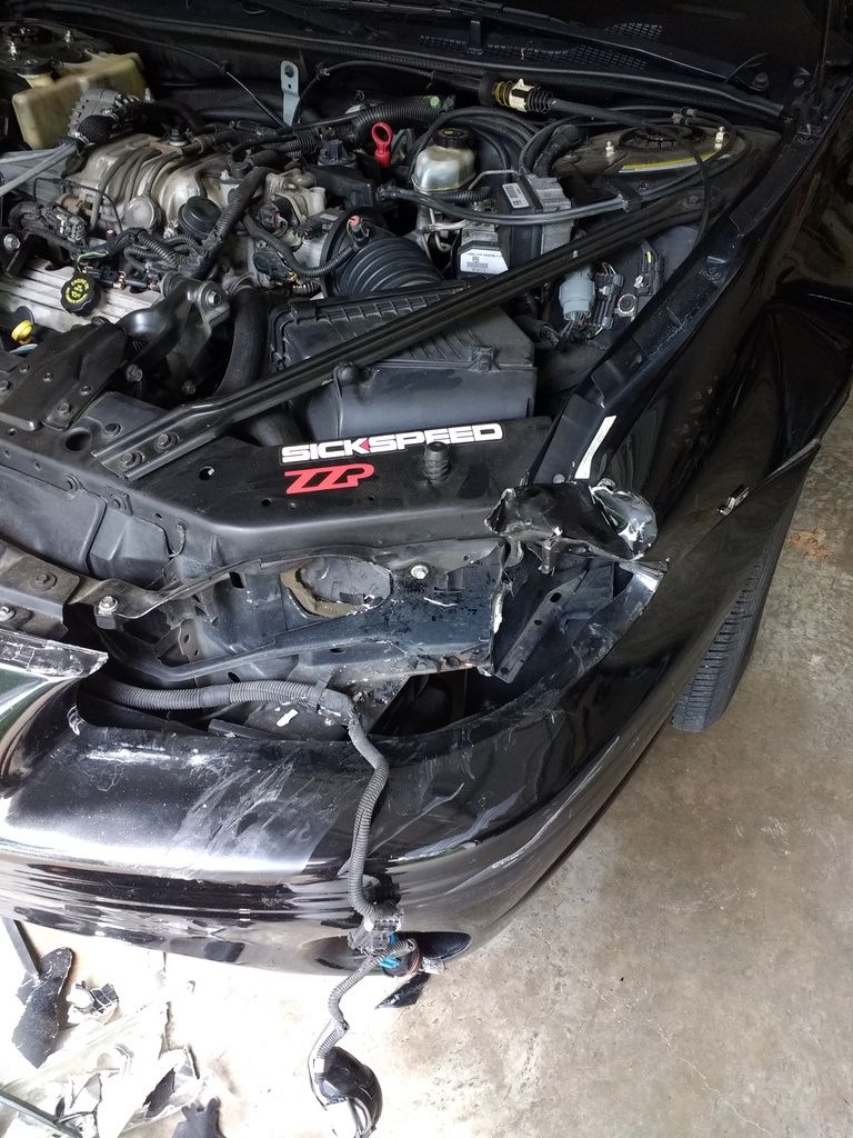

I rear ended a Honda CR-V because they stopped really hard and the grand Prix couldn't. I tried to miss her but there was a ditch next to me. Didn't hit it too hard but apparently I hit a crunch zone on my car. The pictures should explain what is messed up.
So here's the bad news. Apperently our insurance doesn't cover damage to my vehicle which is probably the dumbest sh*t I've ever heard of. So all repairs have to be done by me.

New parts from a body shop would be $2,000 easy with labor and paint.
You're talking a hood, fender, headlight, headlight bracket, maybe even the metal bracket on the core support too, then repaint the bumper.
Fenders and hoods are the same for 2 door and 4 door. Used parts should be less than a few hundred bucks.
Stock brakes? What go fast parts on car?
If doing it yourself, can be done as it doesn't look too bad. I'd run around and get a few estimates, ask if you can supply parts and only pay labor, extras as needed. Explain it's not an insurance job and you're paying out of pocket. I've gotten some good deals when explaining it properly and doing some of the leg work.

Can you pop the hood and get a picture of the braces thats kinda the tell on how easy it will be to fix.. This is a perfect thread for idrivejunk
Swapping fenders bumpers doors is pretty easy but braces and impact zones are a different story

My son crashed my 01 monte ss kinda the same way just on the other side.. i thought "i can fix it" until I popped the hood and seen the braces and crumple zone bent and the engine pushed over.

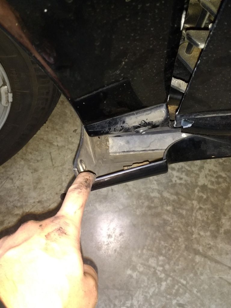

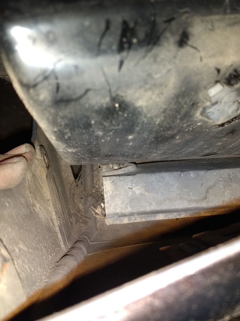

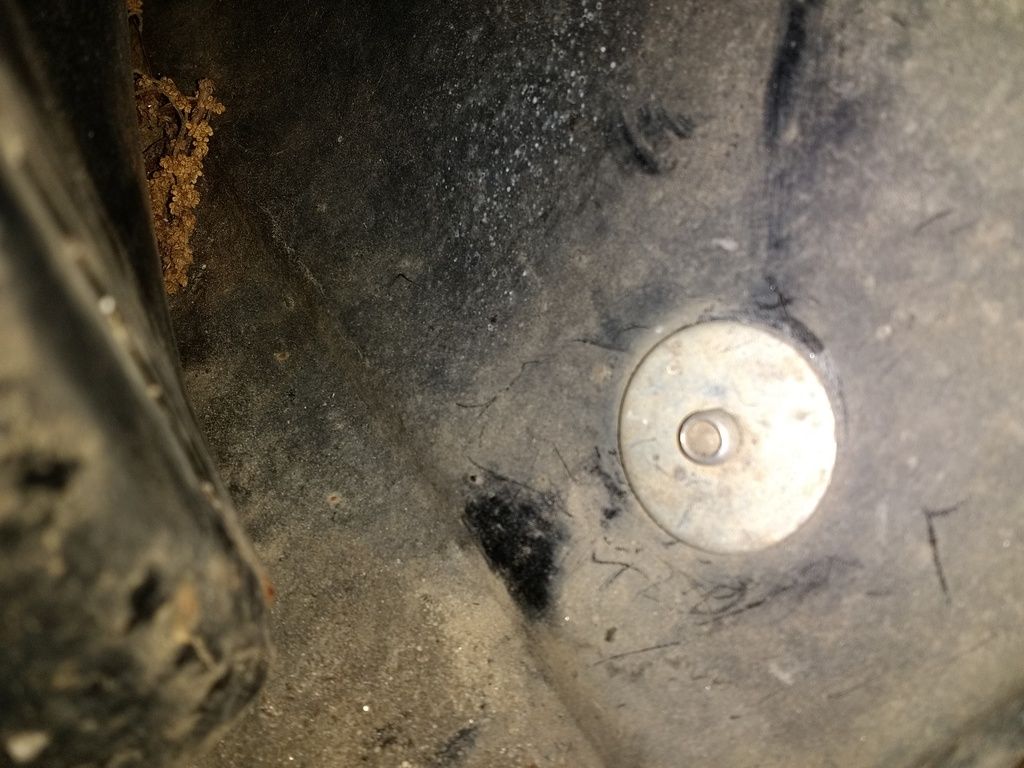

How do you get the fender off? I have all the bolts including the two under the door and the one above the splash guard but it's still hanging on to something under and around the door
Sent from my Moto G (4) using Tapatalk

If you inner structure is damaged then that opens another can of worms as everyone has already pointed out.
Looks like a rivet.
Drill it out and use a bolt/nut + washers for reassembly.
You probably already figured that out.

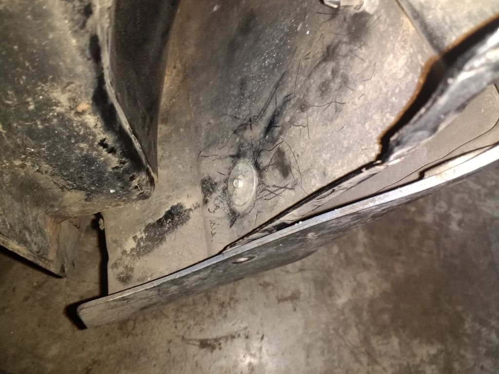

I was about to cut it with something. It's in a really awkward spot. I'll take more pics to show the location
Maybe a Channellock end cutting nipper
That would be a great tool for this. If I had one lol
I'm starting to think this whole side skirt might have to come off if I want to drill it out.
How do you get the side skirt off?
Here's a better look at where it is.
