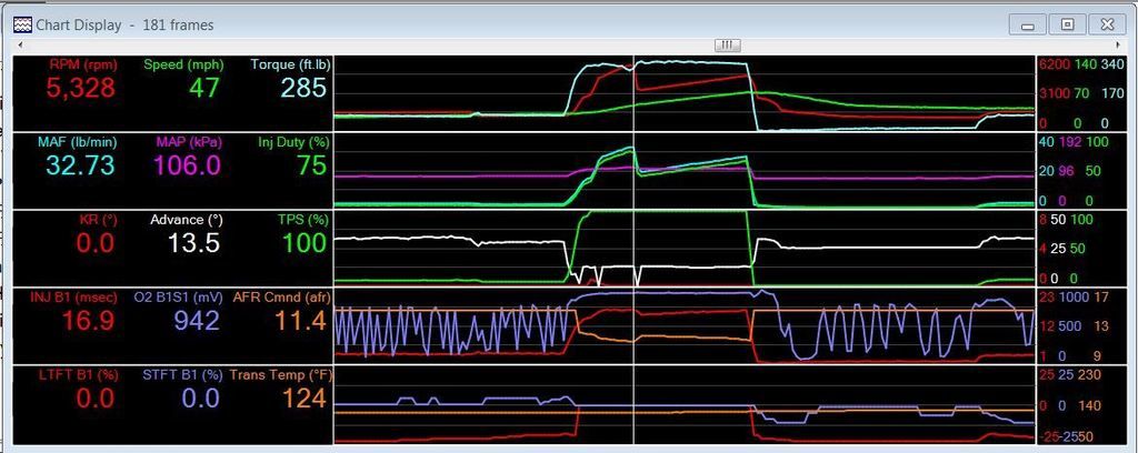

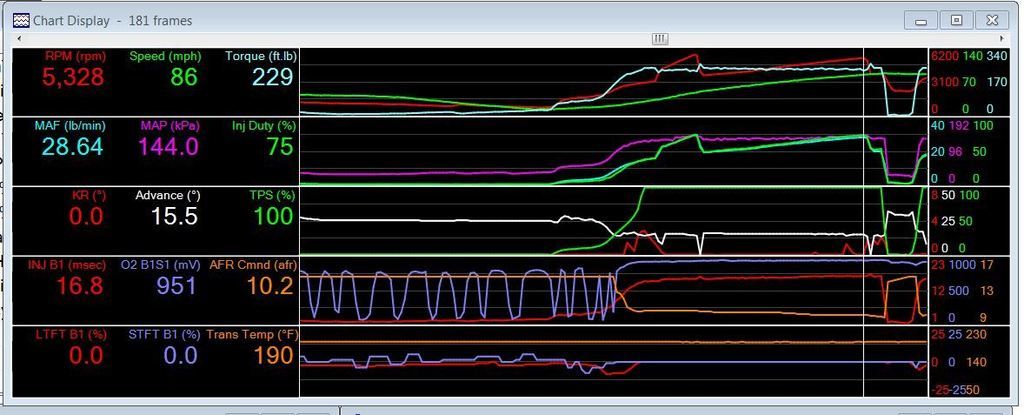

In the meantime, I did some scan comparisons. First pic is of grandpa's car. Second is of another STOCK grand prix during similar weather conditions. Note the TPS, RPM, and MAF value. If the If the TPS and RPM are the same on both, shouldn't the MAF value be closer than that? That flat MAP value kills me too.
Grandpa's:
Other stock Grand Prix:
Re: Grandpa's 2001 Silver Metalic GTP -Low on boost?!
That map reading is no bueno. You tried a different sensor?

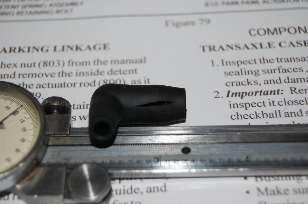

I got my boost back!! Split vacuum boot going to the MAP sensor.
Replaced with a short section of vacuum line to diagnose. All is well now! Well, except for the P0172 (System rich). I guess that's better than lean. When I go WOT, at least it's pig rich.
P0172 Points to either, leaking injector, faulty O2 sensor, or faulty MAF. Already did a MAF swap, and PO just replaced the injectors, so I'm leaning towards a failing O2 sensor....

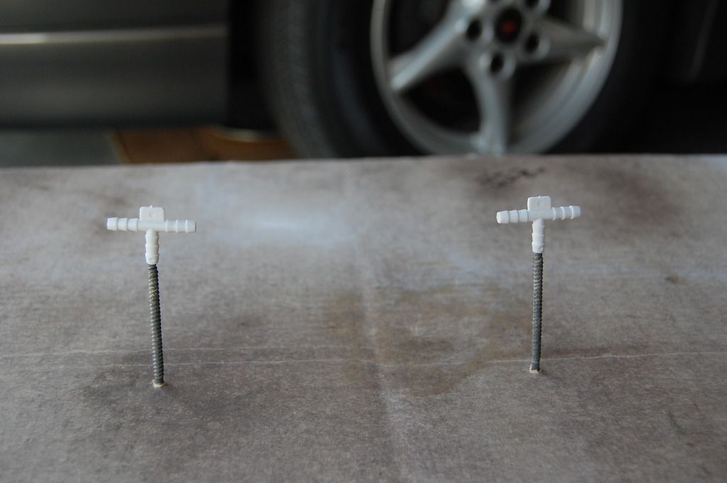

I also plan on re-running all the vacuum lines after what I saw today. So I grabbed a box of hose and a blister pack of tees. Only available in white. No bueno. So, out comes the Krylon.
Before; (Blah)
After: (Clean)
