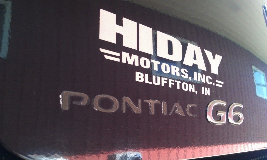

Here are some pictures of the removal of badges and dealer sticker.

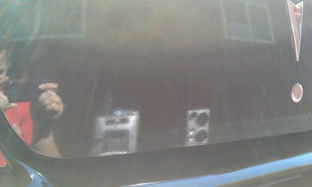

I know the pictures aren't the best due to the crazy orange peel on the trunk deck, but you seriously can't see where the glue was. Cleaned up super well.
Enjoy:
After:

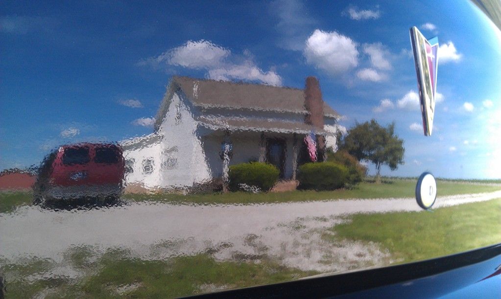

Start of paints finish:

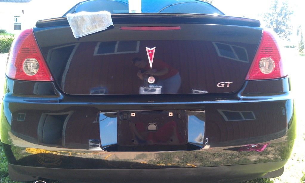

4-5 passes of polish, sealant, black glaze and 3 coats of wax later....
Still no where near perfect enough, but I need to get some better cutting pads and will go at it again come spring time.
Until then, the G is done except for a few more apps of wax before winter.
Holy shiny...Can I shave by looking at the car?? :D
If you look in any panel except the trunk deck lid, yes you can use it as a mirror! lol
I spy with my little eyes some orange peel :)
Yes, the trunk deck is awful! It was that way when I bought it. No idea what happened.
The bottom of the doors are that way too. The only part that's been repainted since I bought it was the roof, and its smooth as glass, no peel what so ever.
The trunk and doors are nowhere near factory quality.
