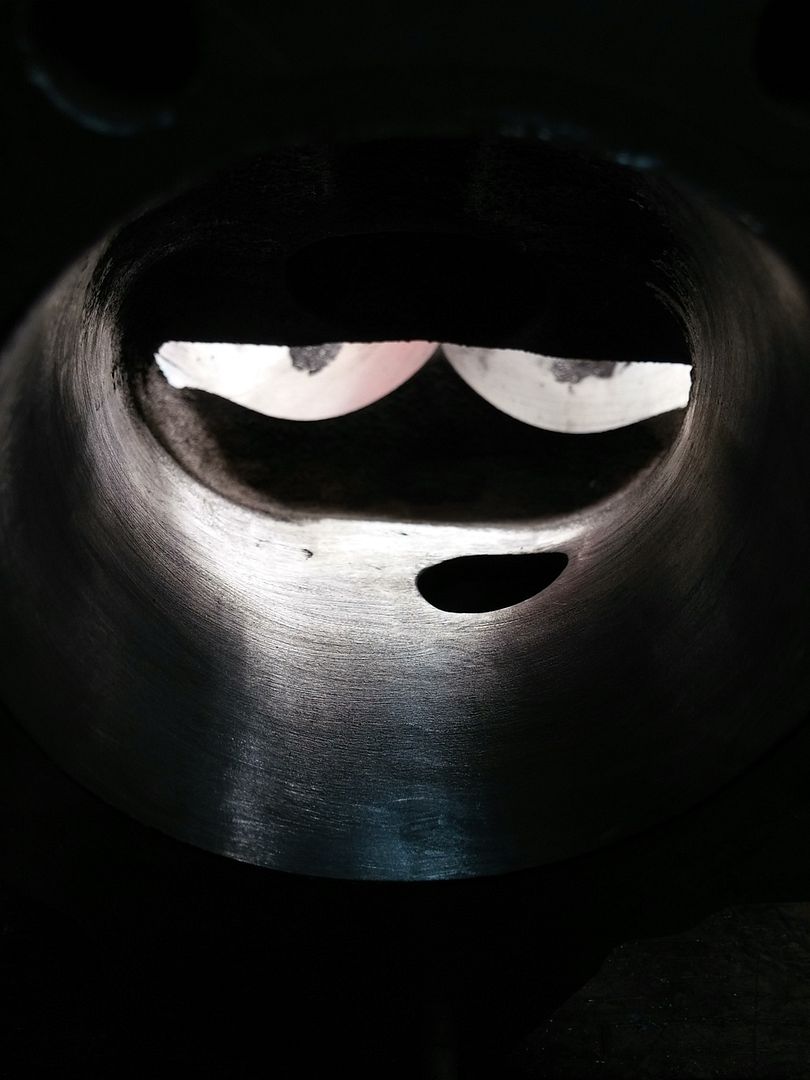

Pics of the ported blower with nortstar tb plate attached. Still need to get some case needle bearings to finish it off.

^^^ ouch!
I think it looks fine. I know that slope in the inlet is tough to smooth out. Can't really use a sand roll on it. Did mine mostly by hand there. Its still 100x better than that stock lunar surface.
Re: BoostedPontiac's 99 GTP
Still better than stock lol. Ill have to get my die grinder in there to smooth things out. At least the inlet and outlet are good.

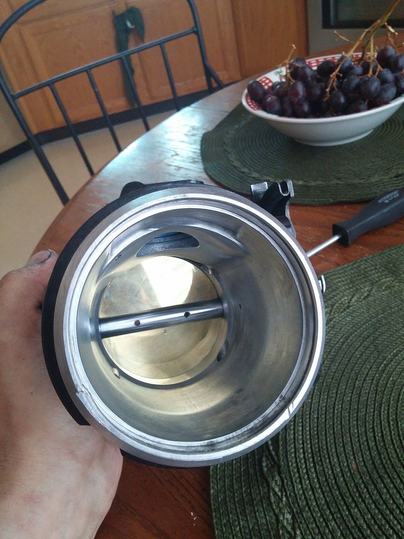

I thought it was until I read this. Was on my upgrade list but if its true that a ported gen III is just as good I can forget it. Would like to have a bigger TB though. I ported the blower and took the MAF chunk out of the TB, but outlet is still stock 69mm? Blower is a little over 75mm now.

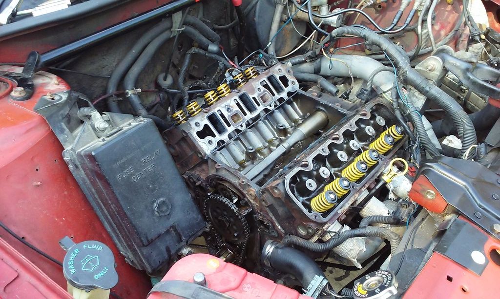

Only progress pics I took. I polished the blower inlet and opened the outlet too.
