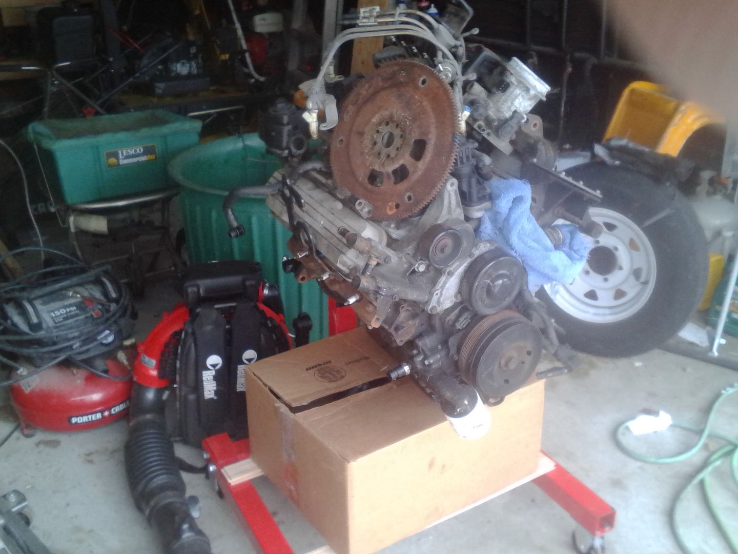

Yes lmao. Looking at getting an engine stand for myself guys asking $50 all black can be fully adjusted to fit a sbc 305 to a 454 and any engine in-between

Make sure you get the safer type, or at least know what you are dealing with if you get the other kind. The safe type has to legs coming out under the engine, the unsafe one only has one so it is prone to tip over while moving.
Re: 85 trans am!!!
i got this one off my brother. you can buy em new from HF for 45 bucks if need be, not sure of the style they offer tho.
this one is good for a 1000 lbs. my brother had got it for his 464, but ended up not using it.
its wider then a 3800 engine. very stable.

Nice stands and I went looked at it again its a single leg I'm using my grandfathers single leg one and I have no issues with it but I am very careful with it. As long as it will hold a fully built engine. I may reinforce it make it more stable because I want to turn it in to a test engine stand so I can run the motors break them in and test before going in to the car.

I consider my Goodwrench single-leg stand a block holder, it has had a bare 400 casting on it for several years now. With 800 lbs of Pontiac iron on it (a complete engine), well lets just say I don't like it for long because its weak and tippy. A test stand is a completely different thing. I'd start with square tubing and build it from there. Nice examples on the web if you look.
