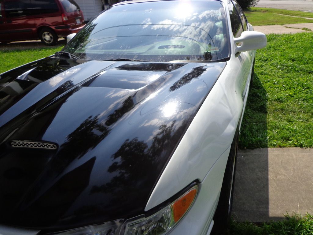

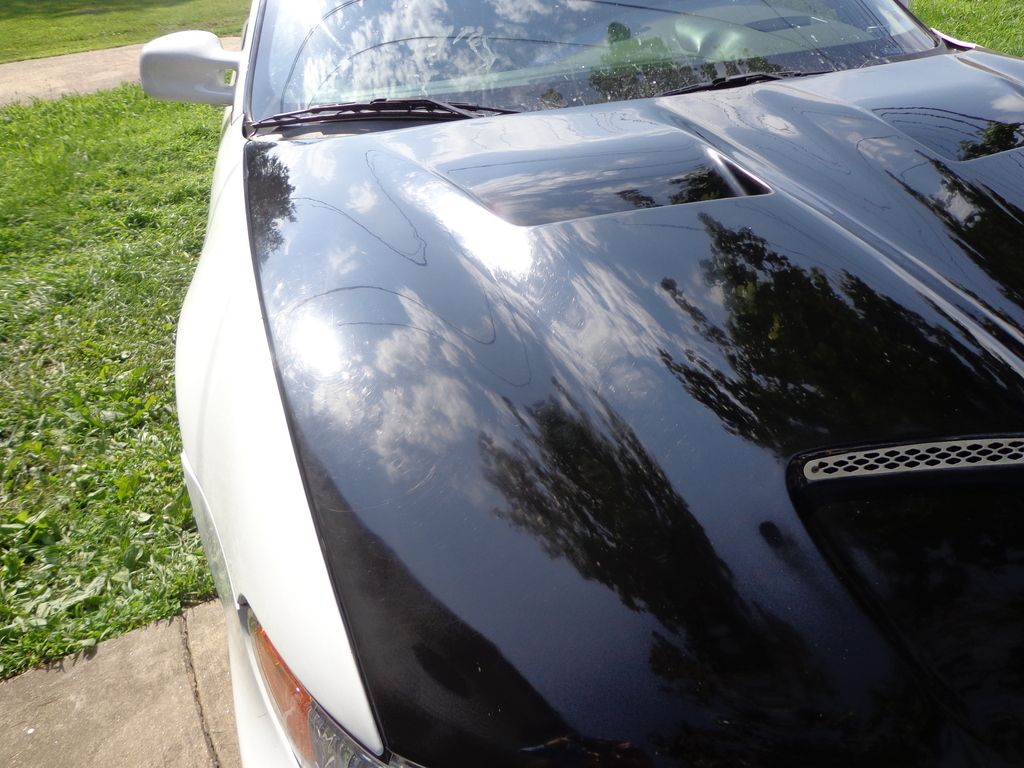

Hood is back on. It looks better than before but far from perfect. Looks pretty good though, considering what I did:

Living that Amish life will do that to you. Once you compound/polish it.. A proper hand wash (2 bucket method) will keep it looking good then just use a quick spray wax to keep it up.
lol. Compound/polish and coat the car with the one of the newer coatings on the market. Trust me you won't look back once you start using one. If anything a sealant and spray wax to maintain will also work.
Re: 2000 GTP: Go-go-gadget-Grand Prix!!!
Yep, thats mighty shiny! FWIW, on the side convo... PDR guys are into hot glue now, they glue studs to small dents to pull them out, in areas such as pillars where theres no backside access. When using tools to push dents out, paintless or not, the idea is to work in a spiral from the outside in, raising the center last. When metal is stretched (different thickness in different spots) as when kinked, heat can help rearrange the metal's molecules to correct but not within the heat tolerance of paint. So it will burn and lift coatings. If you have stretched metal, a PDR guy can't do much for that. None of this helps a fiberglass hood, that needs filler and paint.
