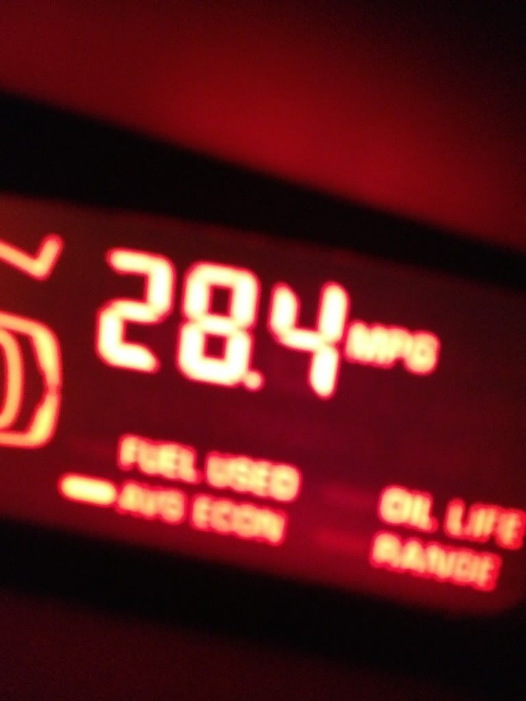

I've had a few people asking me what kind of MPGs I'm seeing with the NIC cam, so here it is. Keep in mind I also don't have EGR. This number is my 75 mile drive I have from home to work, doing about 75MPH the whole time on the highway.
