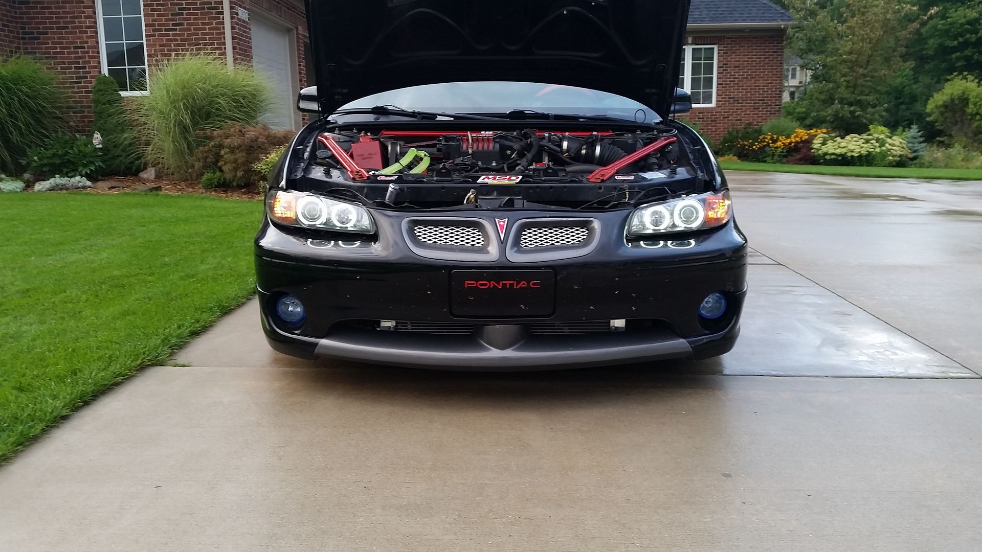

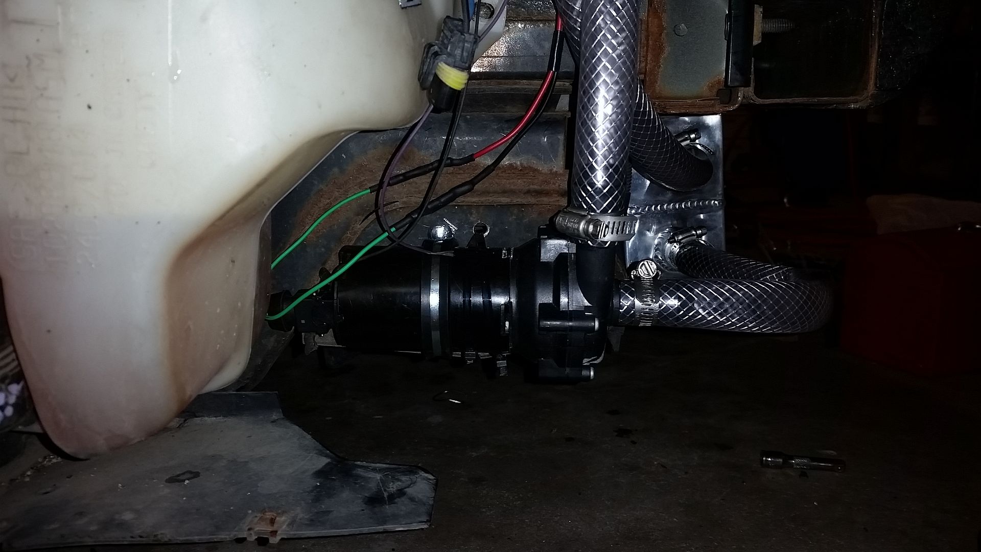

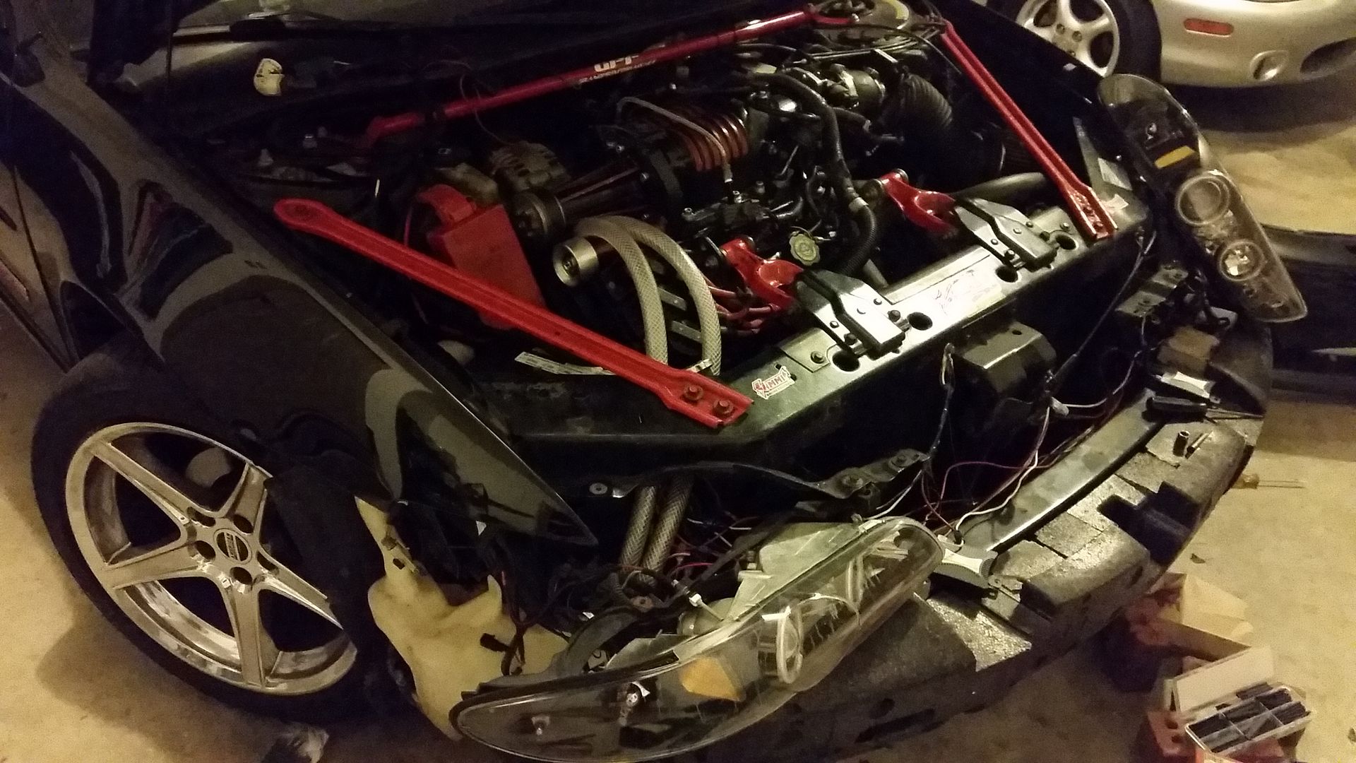

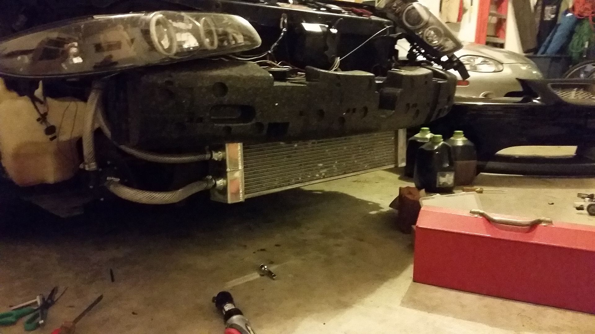

Since I had another car to drive, I decided to tackle the rest of the intercooler job. Parked the car in the garage and went to work. Been extremely busy with work, daughter, family, and other things. So it took me 3 days to finish, with a total of about 6 hours. As this all was a first for me, removing the bumper, installing the FMHE/pump/hoses/wiring. But I'm glad to say, everything went smoothly for the most part and she's up and running with ZERO leaks.
Day 1, just got the bumper off:
Day 2, got the front mount/pump on and hoses ran:

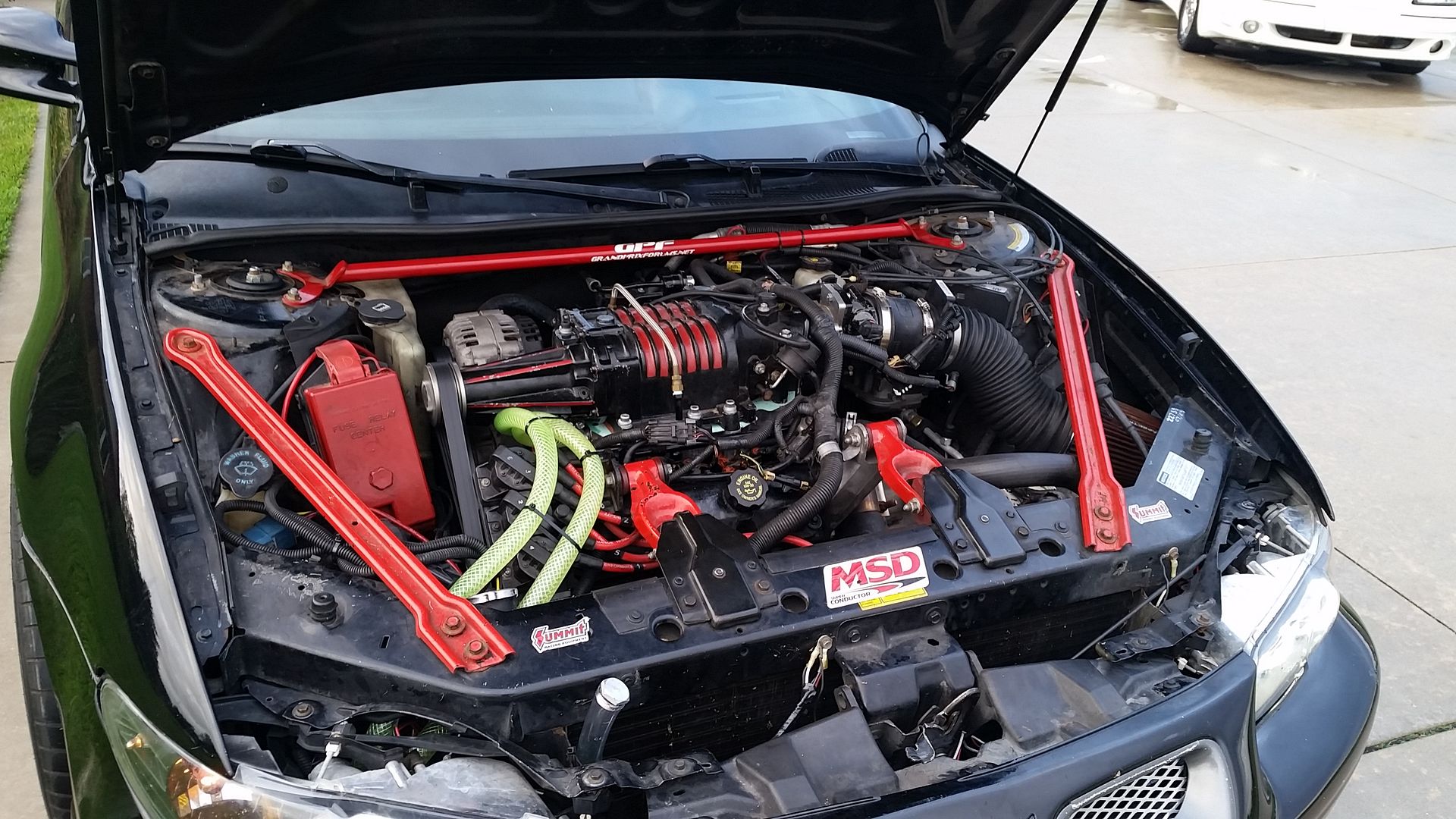

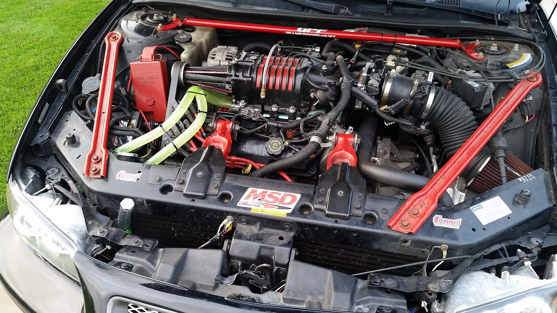

Day 3, finished it up:
I ran Peak Green Coolant through the system, incase there are any leaks I can determine if it's the Car (Dex-Cool), or the intercooler system. I also took the Belt Wrap off for now, as the belt clears the bracket if it sits on the furthest rib on the pulley. I may end up doing something with those intercooler lines eventually as the zip ties kinda kill the looks of it for me right now, but it's a Grand Prix, so it needs zipties.
Couldn't figure out the wiring for the pump. With the relay I grounded it out, gave it constant voltage from the battery, then ran an Add-A-Fuse line to the fuel pump fuse for the switched source, but even with the car off the pump would constantly run. :th_scratchhead: Tried a few other things, but same thing. So I ended up just splicing it into my Halo's switch for now.
As of now, I can't really utilize the full effect of the intercooler because I am completely out of fuel. With my setup on a 3.2 with a Gen V, I'm pushing my stock injectors to the absolute max. For now it's just going to be a KR killer until I can get my hands on some 60# injectors.
Before I ever left the W-Body scene, I've always wanted to have a full size intercooler. That's the big thing I've always wanted. Now I can cross that off the checklist. :D Up next, going to work on the rust underneath the gas cap one more time before I decide to get it professionally done.
