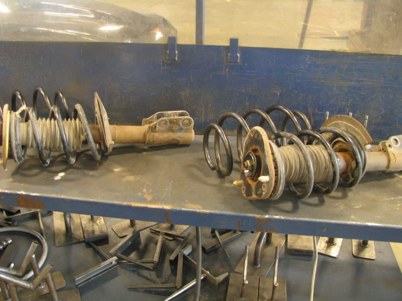

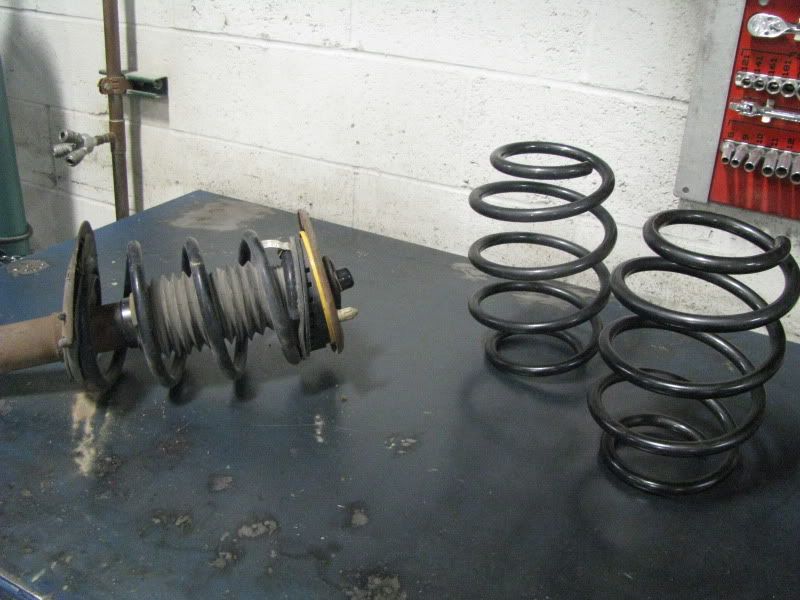

Stocker off and the Eibachs ready to go on

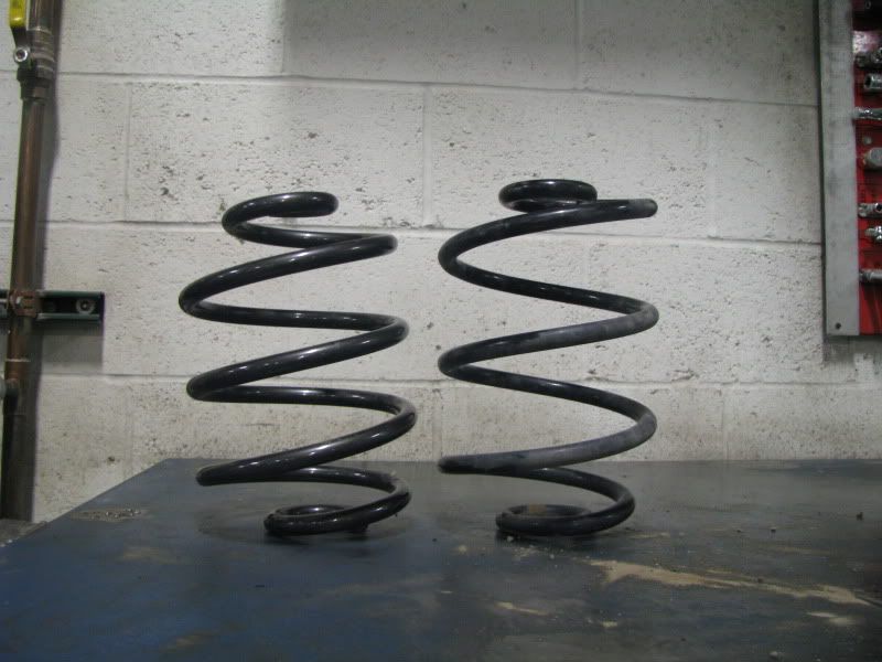

Stock Front Bonneville GXP (FE5) spring on the Left, Eibach on the right
Eibach on the left this time, stock rear on the right

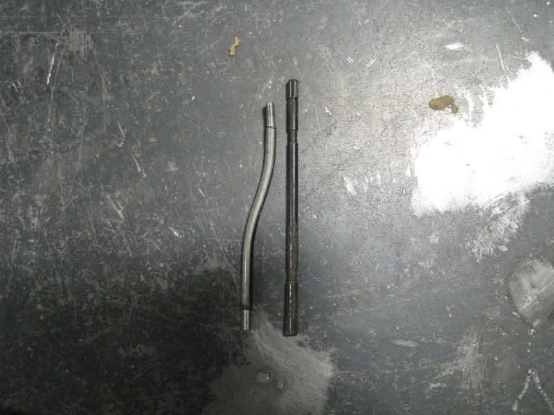

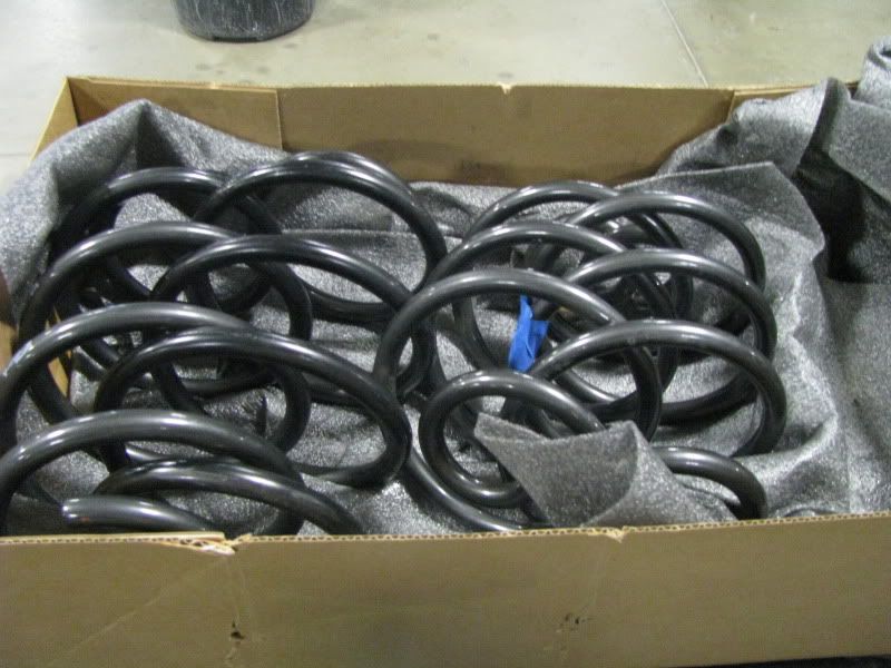

One awesome thing about the Eibach kit, they supply the shorter rod for the Auto Level control in the back
you can see how much shorter than stock

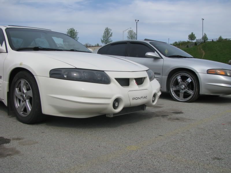

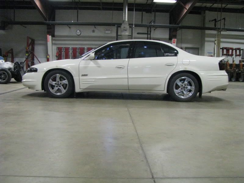

The Payoff
Before
Now

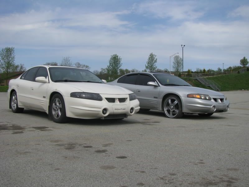

the car has to settle, but here next to a stock 2000 SSEI
and the difference in Numbers
Front
and rear ( it actually came down to 27 7/8" after the Level control got settled)
