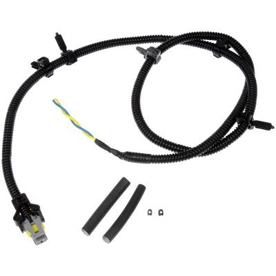

So I've ordered new FL and FR abs wire harness/connector/lines because mine are both bad, throwing the same ABS/TCC problems we all have/had. My question is....what kind of splices are these? I've never seen them before, and all most of the kits (Dorman, Delco, etc.) come with the same kind of little metal taco splices. Are you just supposed to crimp them over your wires? I don't guess it matters I just want to make sure there's nothing I'm missing when I splice these in. Thanks! https://contentinfo.autozone.com/znetcs/product-info/en/US/drm/970-047/image/4/
Both my Dorman kits had those connectors. I tossed them and used a regular butt connector and my own shrink tube.
