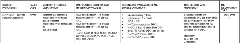

I'd say start small, It sounds like a dirty air filter could cause this code (reduced air flow)... then work towards the harder stuff
...need to check out MAP/MAF sensors also-- see official troubleshooting info --
