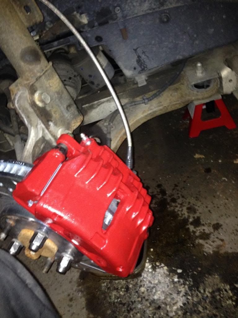

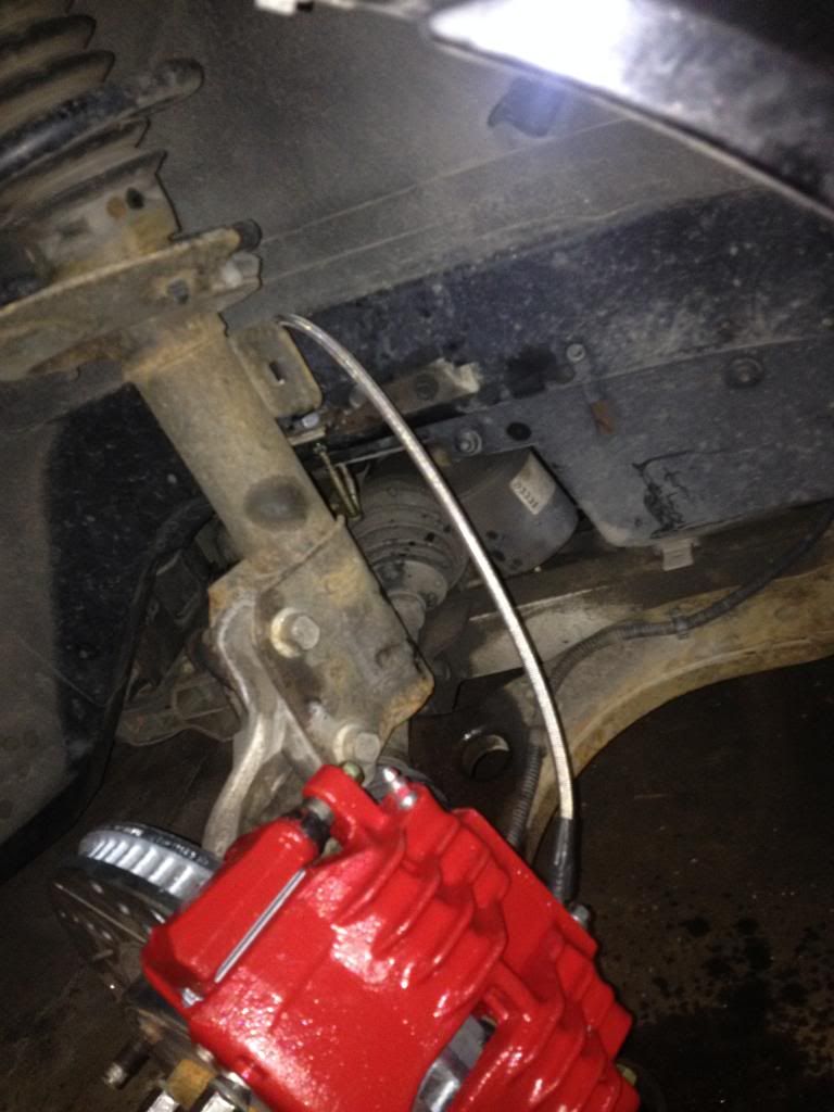

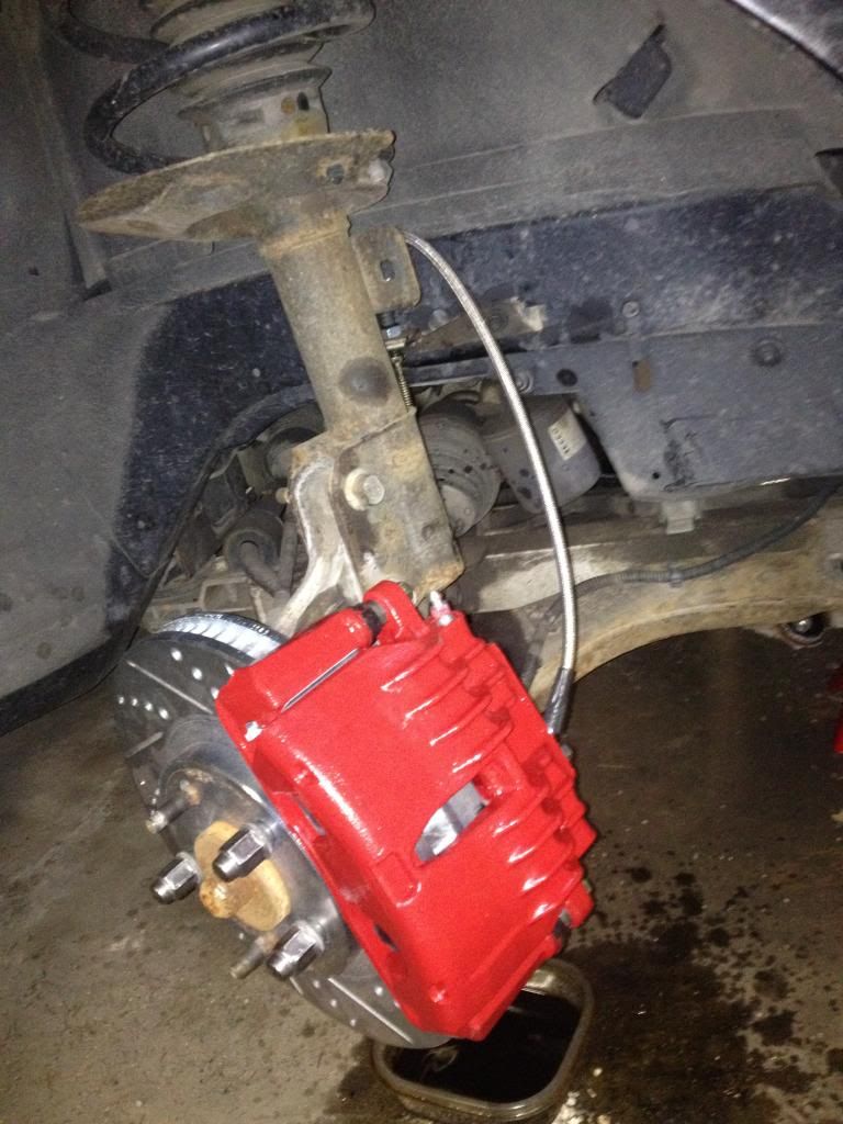

Does this orientation of the brake hose look right? I feel like it has to be, but it seems like it might pull tight on a full lock turn, and it looks like it might rub on that tab coming from the strut tower if I turn the wheel straight or the other direction.
And I assume we want the bleeder facing up as in the pictures, Im only asking because I read one set of instructions that says to face it down.. but that makes no sense to me.

air rises so bleeder stays up. Your at full suspension travel as is, jack the spindle up to ride height and turn the wheel and check.

Oh yeah, I didnt even think about the suspension travel taking up slack. I know I had it right with the bleeder, but when I searched for the ss brake line orientation on google I came across a set of instructions that said you want the bleeder down. I thought that made no sense.. cause yeah the air wants to rise to bleed out. Figured I might as well get a second opinion on that while Im here.

it dont look like you bent the mount tab where the line meets the hard line up top, once the car is on the ground, turn the wheels and put your hand back there to see if it rubbing. i had to turn mine at the caliper to make it clear the tire.
Re: Stainless Steel Brake Lines
ive had to clock the hardline end to help force the line into a "spiral/corkscrew" that clears everything. your caliper side may need to be clocked over a little too
