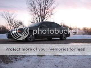

Car is a 2001 dark bronze mist gtp sedan 151k currently on the clock.
Dont have any stock pics but here is one shortly after purchase.

Will have some current pics tomorrow
