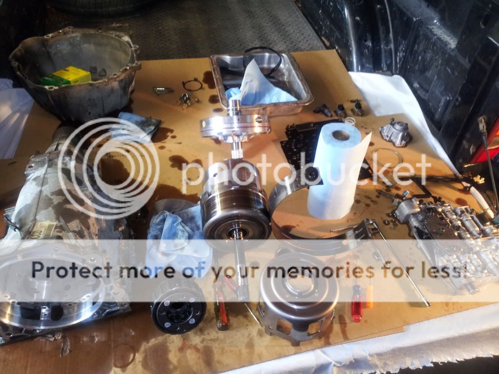

Finally found some time to work on this. Hope to have it done before thanksgiving.
Fun.

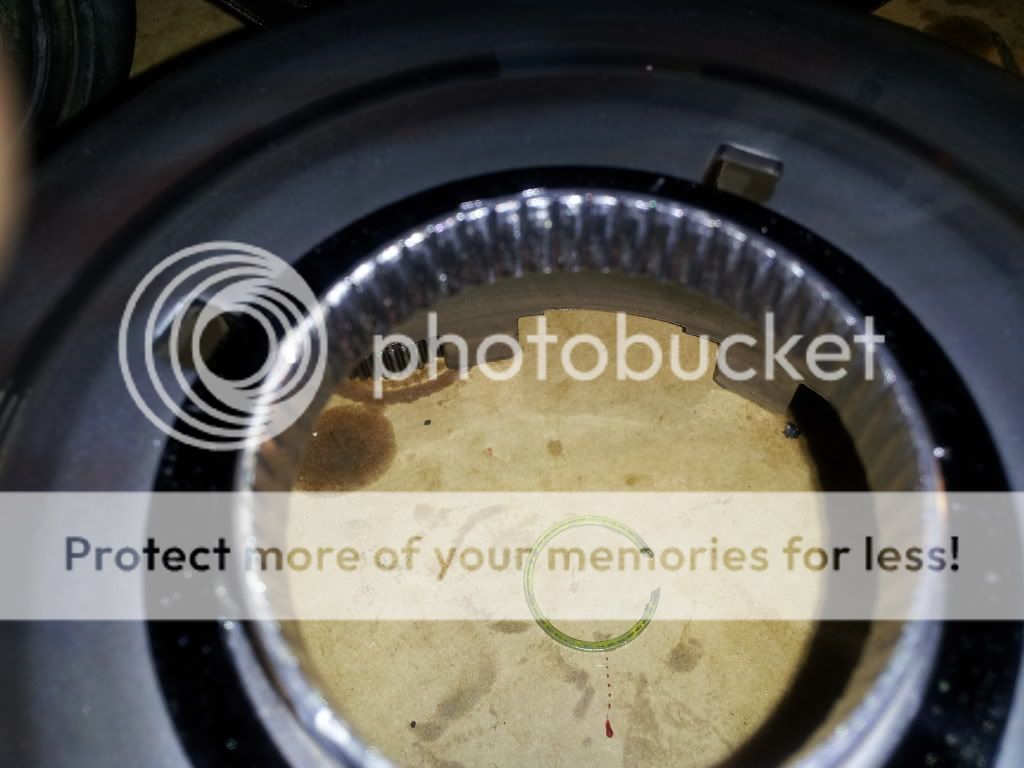

Culprit found, reaction shell as suspected.
They're not bad. Lol.
