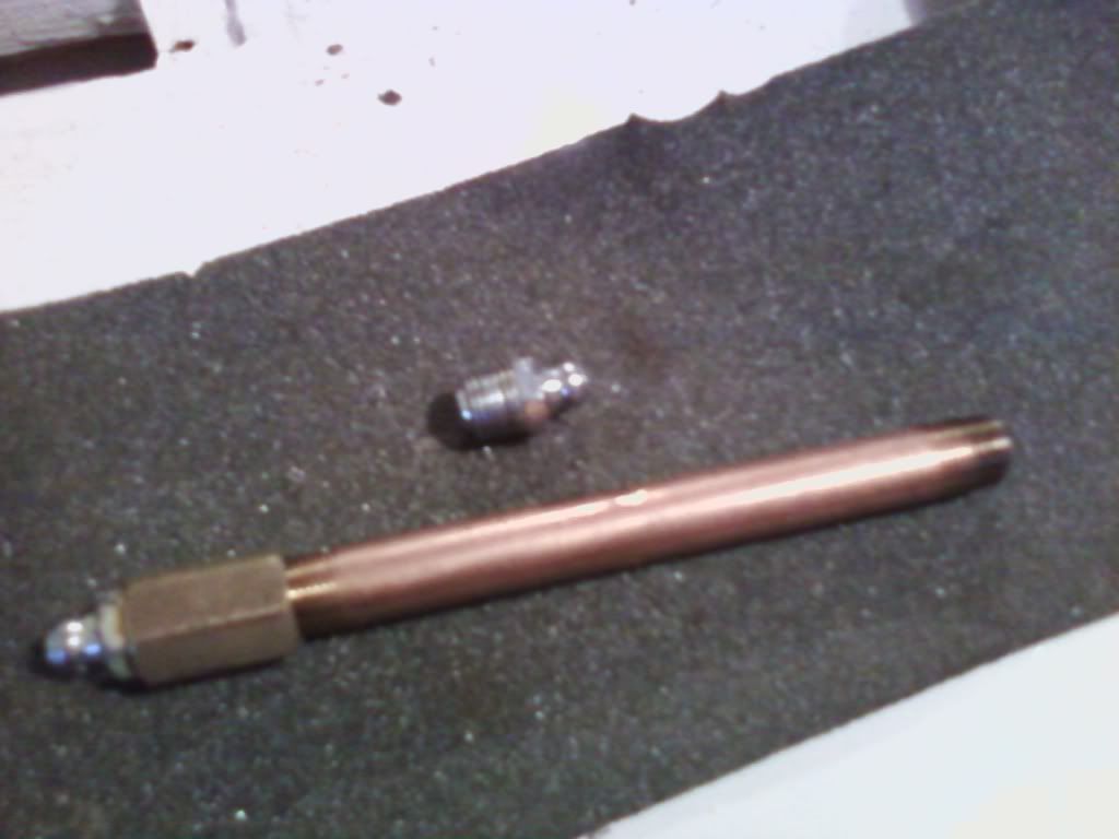

Humm. Try a different grease gun. It's going to be messy, but they will come out. Is grease coming out from anywhere now? If so something is not tight. The one side is easier if you use an extension. The Bolt you are using with the grease cert on top isn't leaking is it? The grease fitting to use directly into the housing is a 1/8th pipe tap. This is what I used.
