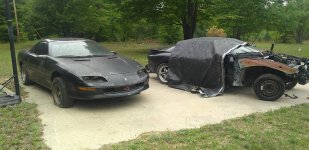

I was at the local parts store the other day, and was offered a deal on some 4th gen cars that have been sitting for a while. That weekend I went to look at what i thought was only 2 cars, and ended up bringing 3 home. I managed to get everything for about $1400.
The first car was a 1996 trans am with 89k original miles. The guy bought it from a dealership back in 09, but it had title issues due the dealerships sketchy ownership. They took 2 loans out from different banks on the title for this car. After the bank seized most of the cars from the lot this was left in limbo for about 11 years. long story short the car was considered abandoned by the sheriffs office, and i now have a title for the car.
The next 2 cars are a wrecked 97 trans am WS6, and a 95 camaro. with the money i made from selling parts out of the 97 and the 95 I was able to keep the 96 trans am for free.
