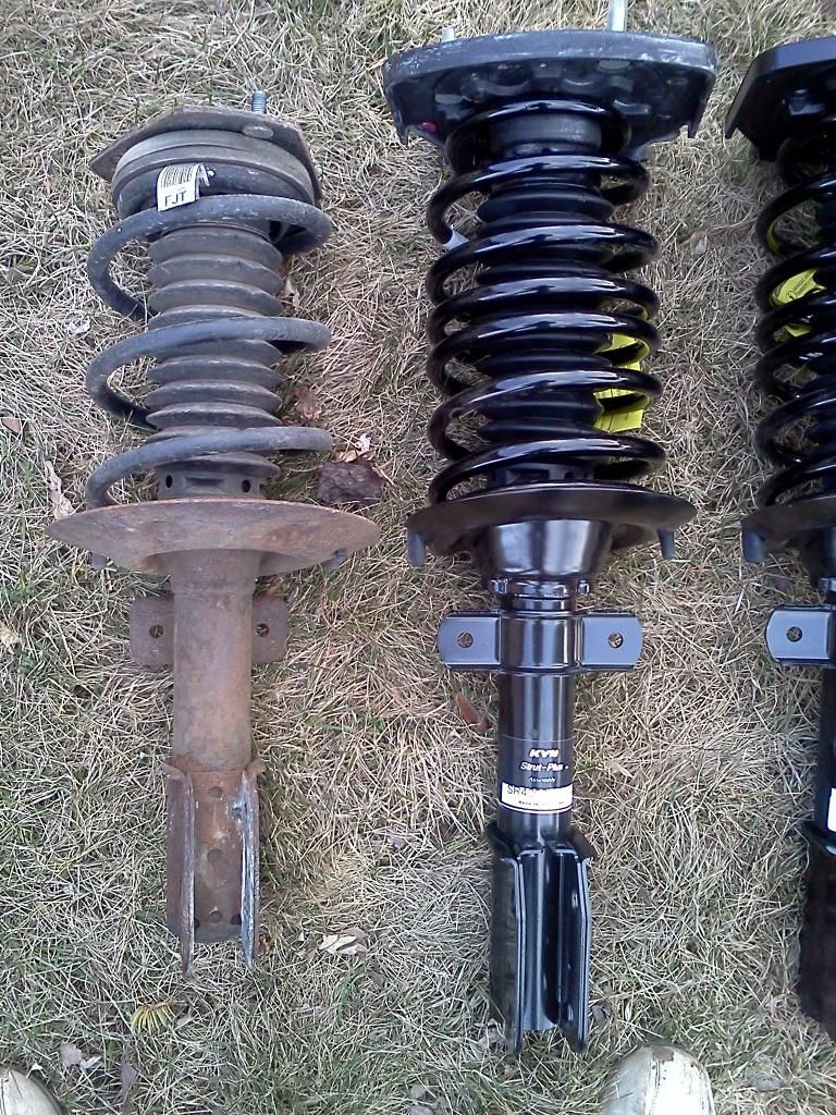

So for my 2008 I purchased lower control arms and quick strut assemblies for a 2003 model grand prix. Based on my research the LCAs and struts are interchangeable but look at the front strut I pulled and the one I ordered from Rockauto:
I mean this thing doesn't even look close. What the f*ck is going on here guys? Even if the spring settled look at how much longer the bottom portion of the strut assembly is. And also the top mount is friggin huge!
What to do guys?!

What I was saying.. is your question didn't consider the total length of assembled strut. Meaning if you measured from the strut tower to the connection point at the knuckle. You mentioned the LCA is the same and the knuckle was the same. I saw a potential variable and IIRC I thought using 97-03 struts would lower an 04-08 approximately an inch or less.
I didn't consider that but I see what you're talking about now. Would there be any significant issues with the small amount of drop you've mentioned given I will be getting an alignment?

I run 97-03 KYB quick struts in the front, and in spite of expecting the same thing, my 05 sits at the same height as it did before my front springs started sagging. Can't say I would have minded if it lowered the front though, my back end sits a tad low due to 200 lbs. of audio equipment and it would have made it look a little more uniform.
Put the front quick struts in the front along with the LCAs and everything seems ok at this point. I plan to put the rear struts in the rear of the car :cool:
I'm pretty sure the 2003 front struts put a slight lift on my 2008 in case anyone runs across this thread in the future. Maybe a 1/2" - 1" of lift is what I would guess.
so once the spring relaxes and settles into the rubber isolators youll likely be where you were with your worn out strut.

So in like 100,000 miles they'll be all settled in? I'm at probably 500 miles and I still have some minor 4x4 action going on in the front. If they didn't change anything structural how come the part numbers are different? Also, the spring did not look the same as the original.
So it looks like about 2.5 years ago and 40k miles I replaced some front end parts on my 2008 base model. Due to the lack of quick-struts available for the 08, I converted to 03 LCAs and front strut assemblies. The only major noticeable difference was a slight lift in the front of the car - maybe 1"+
I am about to replace the steering rack which has developed a clunk. My concern has been that although similar, the 03 parts are not an exact match for the 08. I am debating if I should replace the LCAs and front struts again now that quick struts are available for the 08s. Seems a bit wasteful considering the parts only have 40k on them but now would be the time replace since I'll be pulling a lot of things apart.
