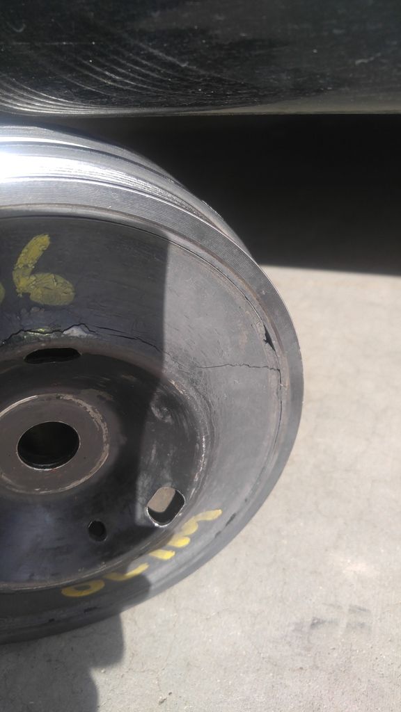

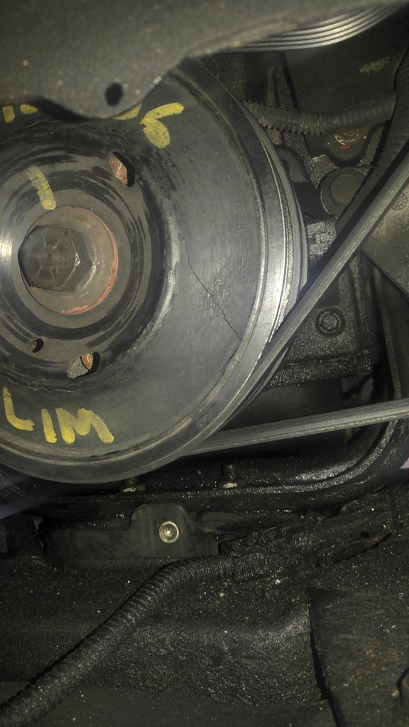

Ok well I just replaced my power steering pump and although it was shot and everything runs a lot better now the rattle noise it still there. Although while under the car it sounded like it was coming from the hb. The rattle is only at idle and once under load it goes away. Does that sound like a hb problem. Also my hb has little crack and for some reason I can't get the sc belt to sit right. You can see in the picture

looks like you found your issue. time to replace that. was this a junk yard engine? odd its got yellow writing on it.
what year is this car? and why does it look like the frame is cracked? bottom right of the pic. dark line that turns to the top, not sure if its a shadow. or a splash shield or a bracket, lol just looks odd to me.
So that's a bad crack then? Haha no the engine is original with 108k on it. That is the hb I got off a gtp when I top swapped

take a closer look at it in the day light. its all dirty and hard to tell exactly whats what in a pic.
I meant on the hb. Whatever your seeing is just a shadow or splash guard I would have seen a crack that was bad haha. The cars never been in an accident before either

blancer looks to be busted, would explain all the shaking and clunking sounds. id not drive on that. if you still got the l36 balancer you can pop that on till you get a new l67 blancer, no boost is a bummer, but f it, better safe.
Hmm ya it's more of a rattle but I just ordered a new balancer from pep boys. Only 71$ I should have it tomorrow.
