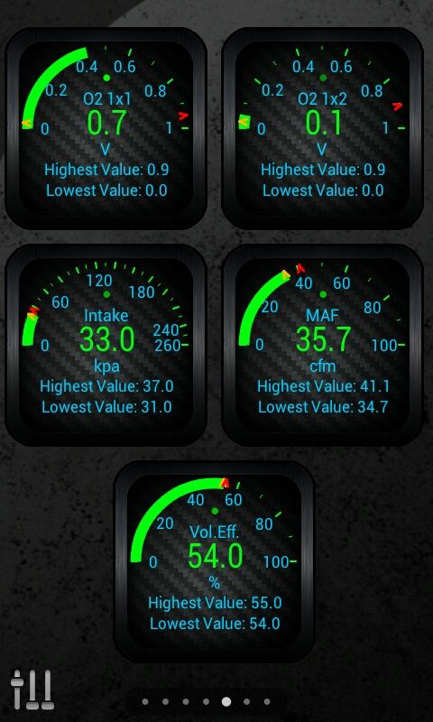

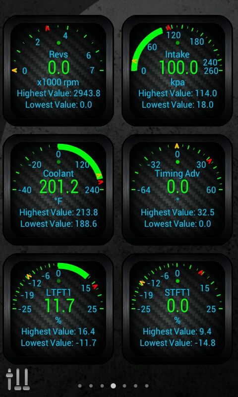

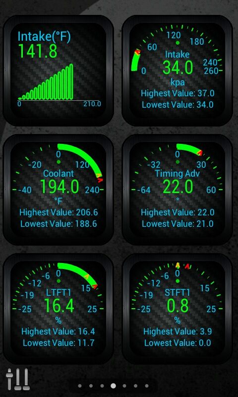

here's the scans
key on after running
LTFT's 16.4 but fluctuate downward when gas is depressed

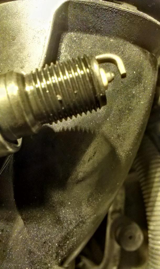

plug's 1 & 3
plug #4
since the plugs were changed last night the mis has changed completely, as in its a stutter like excess fuel is being tossed in the mix and simply cannot burn it out fast enough...
I don't know I'm just guessing at this point
I found the bit-o-electrode when I cut the cat I didn't know what it was at the time. there was nothing else before the cat in the pipe. if it was chipped would there not be debris in there as well?
