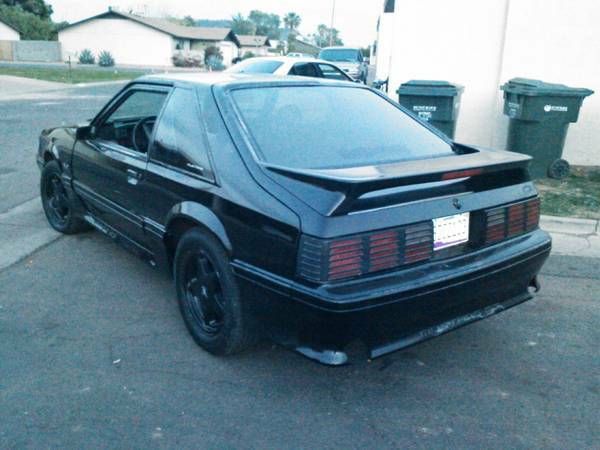

Here is what it looked like when I bought it
I thought "Hey the paint is faded but so what? It's an Arizona car. I'll take it"
Famous.Last.Words

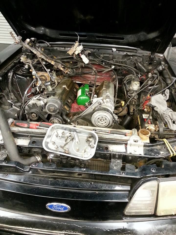

Then the oil leak and misfires i went after at the same time.
the oil leak was the front and rear intake manifold gaskets... well if there were any gaskets, the previous owner used only RTV on those
The misfires were caused by the headers melting the spark plug boots, awesome.
So I bought some heat sock things for the plugs and new wires and we have been solid ever since

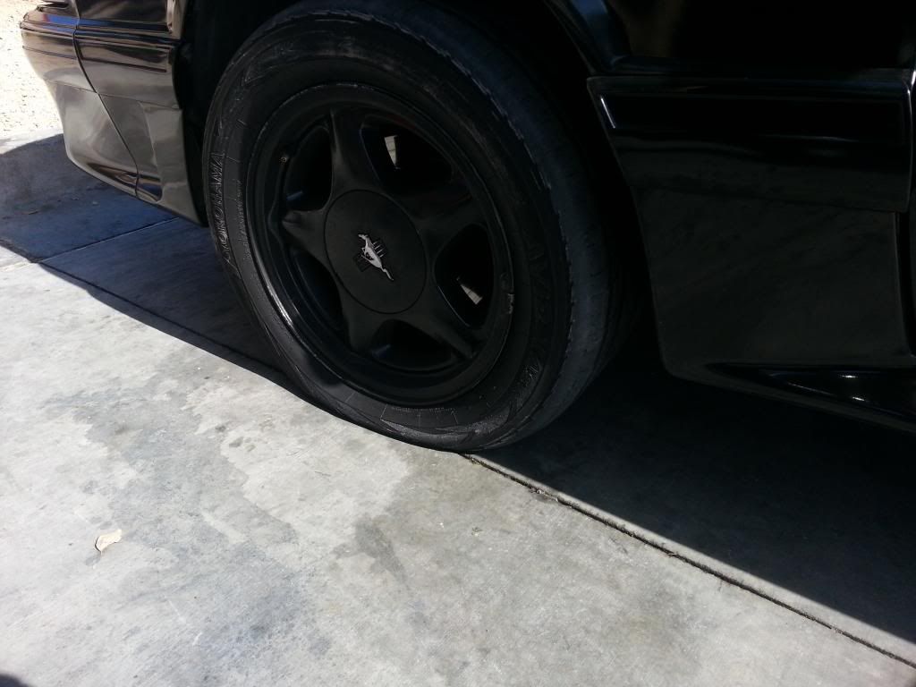

At this point the tire issue was getting worse
I would come out to this every morning
The biggest issue with getting new tires was the rims however.
EVERY SINGLE ONE WAS BENT lol

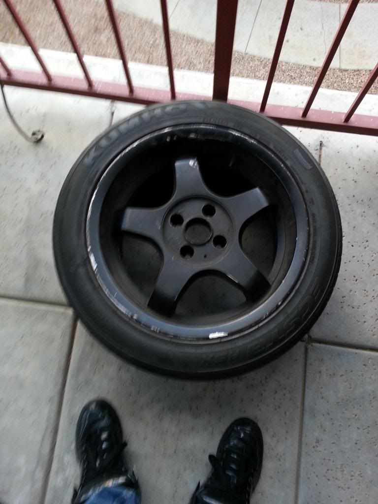

We took a day trip and picked these bad boys up, 17x9.5
Now the Previous owner of the wheels had spray painted them... but black on a black car? nahhhhh
so I broke out the aircraft stripper and got to work, seemed like it took forever but they finally came clean.

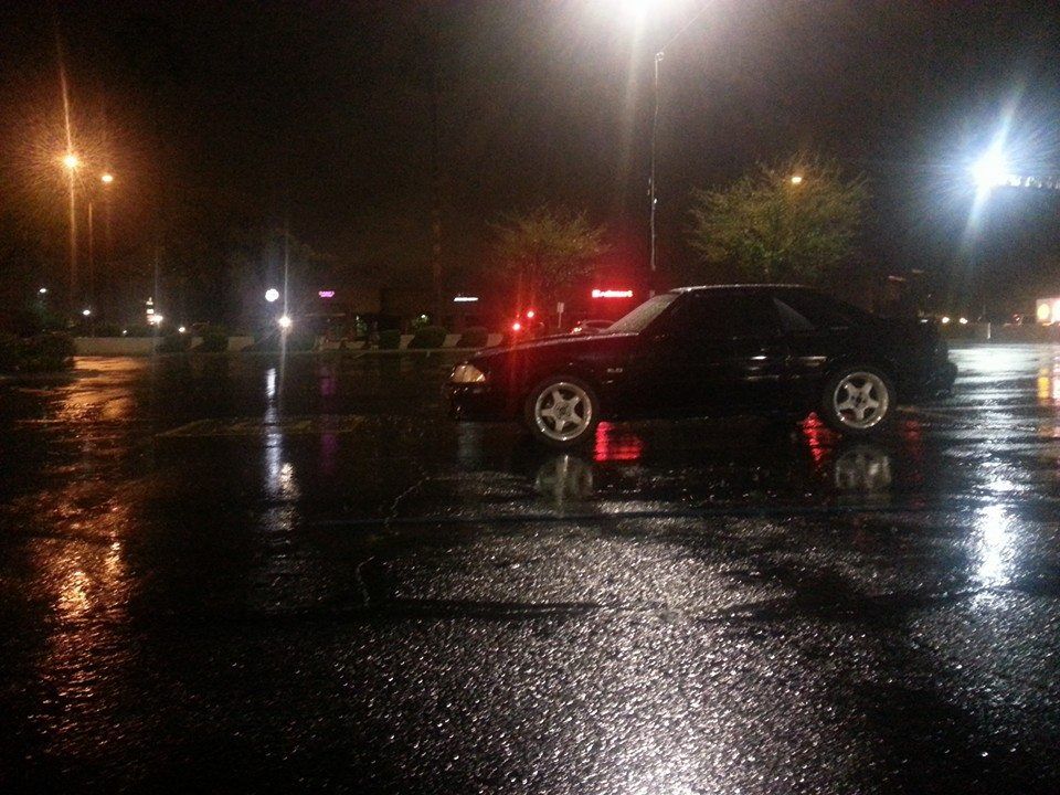

That night I went over to Volkswagen (Where I work) and mounted them up.
It also rained that night so I took some pictures

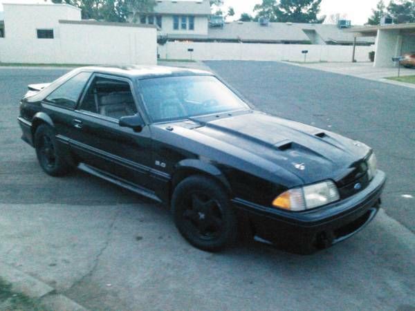

Here she is right now
