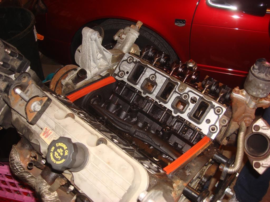

96-97 engine block. Look at the top and bottom of the picture at the block. See the solid line of the block from head to head. That's the first design w/o any holes for locating pins to sit into.
98+ engine block. Look at the left and right ends of the block. See the two holes on each end. These are where the locating pins sit into.
When putting second design gaskets on a 96-97 block the pins simply lay over the side and still do the job of holding the gasket in place before the LIM is put back on.
