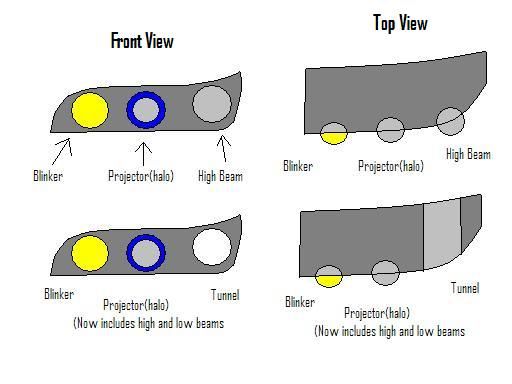

So here is the concept drawn out. excuse my using paint but Im on my buddies laptop. I think a 3 inch wide hole would do a well to feed some fresh air into the engine compartment since the intake is right behind this light. The concept of a ram air headlight seems strange to me too but hey Im an idea man lol.
The upper row is before the lower row is after

I don't see it being worth it. What exactly are you looking to gain? Less than a degree of IAT? Most of the air being sucked in will flow back out through the hole in your fender. Look at the risks. Cannot be driven above 5mph in the rain. Waste of at least 1 drivers side headlight. Loss of Brights on the drivers side.
Your screen idea would give the air a weird pattern and things would still get through that hole. Look at how much crap gets on your headlights? Do you really want that on and or in your air filter?
The reason it works on the car redlinepontiac posted is because carbrated/ early efi motors were not good at sucking in air at all, and force feeding them was the best option for that time. Most people "flipped the lids" which exposed a gap where the filter could suck in more air without risk to the carb.
