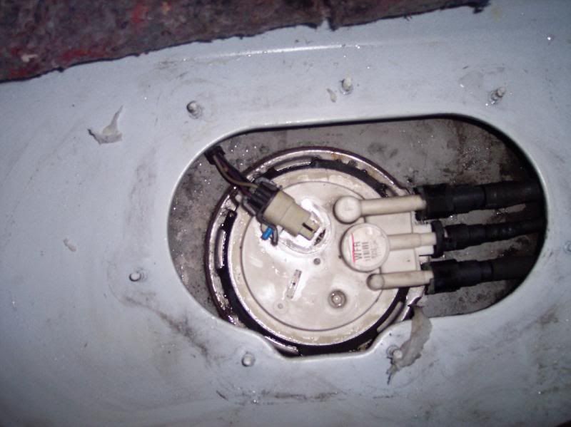

This is a picture of the fuel pump under the hole. The ring is more than small enough to come out:
Go to the members ride section and look at my thread. In there you will find my pictures of when I replaced my fuel pump with a racetronix. It also shows the c clip you are talking about. :)
Thanks guys, but on this picture, the ring is the "C" type ring. The one i have, is a full circle, "O" type i guess, and it is alot larger. i have to actually unscrew it counter clock wise, and once i do, there is simply no way to take it out.

I took it off twice (i thought i will give it a try a second time, a day later), so i know 100% it is a full ring.. i found a picture of exactly what i have. even the two metal vertical things were electrical connection plugs in..
as you can see from this picture, it is way too big for that hole.. so after i unscrew it, i just can't get it out..
PS, obviously i am not the only one with this issue, because someone else took this picture of their own car.
First I've ever heard of it. I'd like a better cleaner picture of your actual car though.
Yeah..I'm a pain and kinda tough to convince. I admit there's some oddities out there, but it's not common.
i found this pic in a different thread, but it was from 2010, so i doubt i would hear from the guy who posted it.
The car is not mine, it is my parents. i wanted to fix their fuel gauge problem (when they took it to mechanic they got quoted almost $1000, 650 for fuel pump, and 4-5 hours labour). . They have way too much stuff in the trunk, so honestly , just trust me, when i say that is exactly what their fuel pump access looks like. I myself wouldn't be able to even take a better picture. i had the ring off, and was able to turn the pump around a bit, so i know that the kind of ring it is. But there is just not enough space to remove it.. even if there was a bit more spece vertically, i probably could have slide out one side, and then another, but it is just so tight in there (as you can see from that picture).
