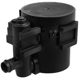

(2) Canister EVAP vent valve and solenoid- located behind your fender liner on the in the rear driver side wheel well. Looks like this: Picture

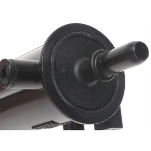

(5) EVAP purge valve and solenoid- located on top of the rear valve cover, looks like this: Picture

After a little more googling/manual reading I decided to replace my evap vent valve and solenoid. It's also pretty cheap and easy to get to; just whip off your back tire, pull out the fender liner and there it sits. 20 minutes later, I had a new vent valve installed. This didn't fix my problem either. In retrospect, this is a pretty easy component to troubleshoot. It is what it describes, a valve that provides a vent path to your vapor (charcoal) canister. With no power applied it's open, with 12V on it shuts. All it takes is a 10mm socket and a pair of pliers to take it off and remove the vent line to the canister. I just wired it up to my car battery, and after I'd put a new one on anyway, could see and hear it shut with power applied. Next.
I stopped by a junk yard and picked up a new Purge valve for $3. It's also very easy to remove and you can troubleshoot it nearly the same way as the vent valve. Pull it off, take the hoses off. Put 12V the valve through the plug blades. If you can blow through a tube into the vacuum-in side with power on, and can't blow through it when you take your 12V off, the valve is good. This valve opens and allows fumes from the vapor canister to pull into the intake, preventing them from entering the atmosphere and burning excess hydrocarbons. At this point I wasn't in the troubleshooting phase though and was just hoping for a quick cheap swap and fix, so I popped the new (gently used) one in. Of course, it didn't work.
