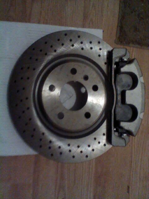

Lookie what I got today.
soo did we come to the conclusion that this is a direct bolt on or not? Im in the need of new brakes currently. Are those pics the ones from the links you posted bc theyre drilled and the ones in the links are not. They look great though keep us updated!
I was doing a little more researching and found out the front rotors are used on the Bonnie GXP, but not the calipers. Thought that was kinda weird.
The rear rotors are just on CTS, not the bonnie GXP..
