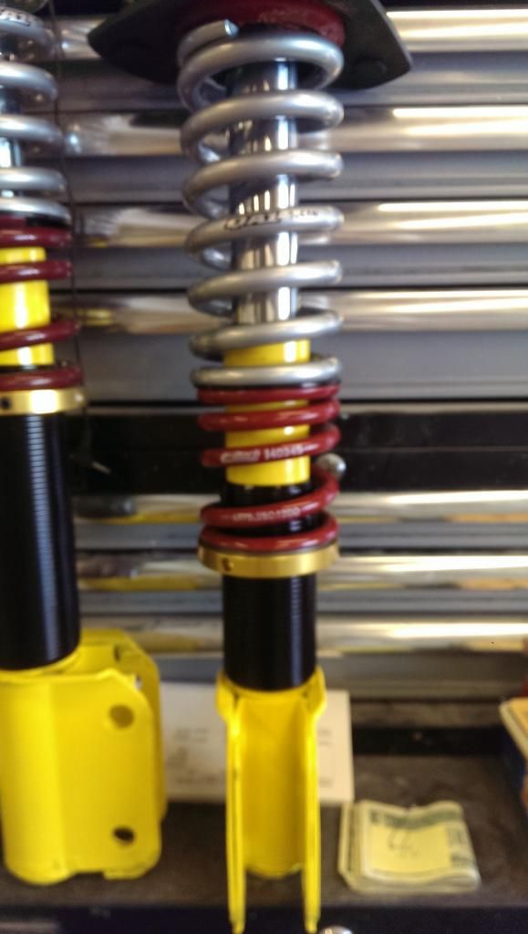

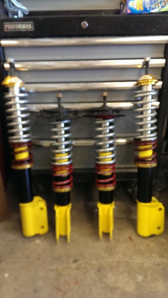

Tomorrow the ol Comp G will be getting some goodies put on her :). Finally got the coilovers put together and my wheels came in this last week. So tomorrow it all goes on. Super stoked.
Very nice with diameter sleeve did you go with so that you didn't have to hammer a exhaust pipe reducer in it.
What spring rates? Who valved them?
Would totally be making these, but I think I have a line on something else.

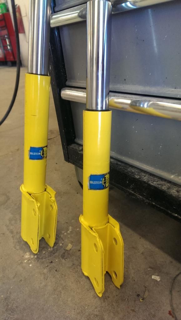

Sleeves were 2.038" they have very slight play. The bilstein strut bodies are right under or at 2" unlike stock bodies which are over 2.1". Front springs are 7" 550# rears are 7" 400# with both using a progressive tender eibach spring 600/1300# rate. The struts are stock gxp hd struts. Should ride much much better than just a main linear spring
You will love the ride for sure...,those spring rates are gonna be really rough on the street though...time will tell though
I do love the way it rides. It's not rough at all, that's what the tender springs are for. They take all the little bumps out of the road, it only gets stiff once they fully compress. I will say I should have gone with a 7" sleeve up front because threaded all the way up the car is still lowered around 2". But all in all I absolutely love them
i never knew the bilstiens were an inverted style strut. that's part of the reason why they're probably the best coilover option.
