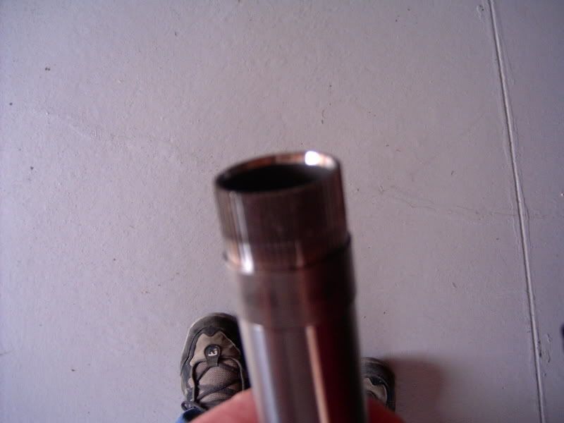

Below is a common problem, No 4th gear anymore. The splines stripped off the end of the 4th clutch shaft

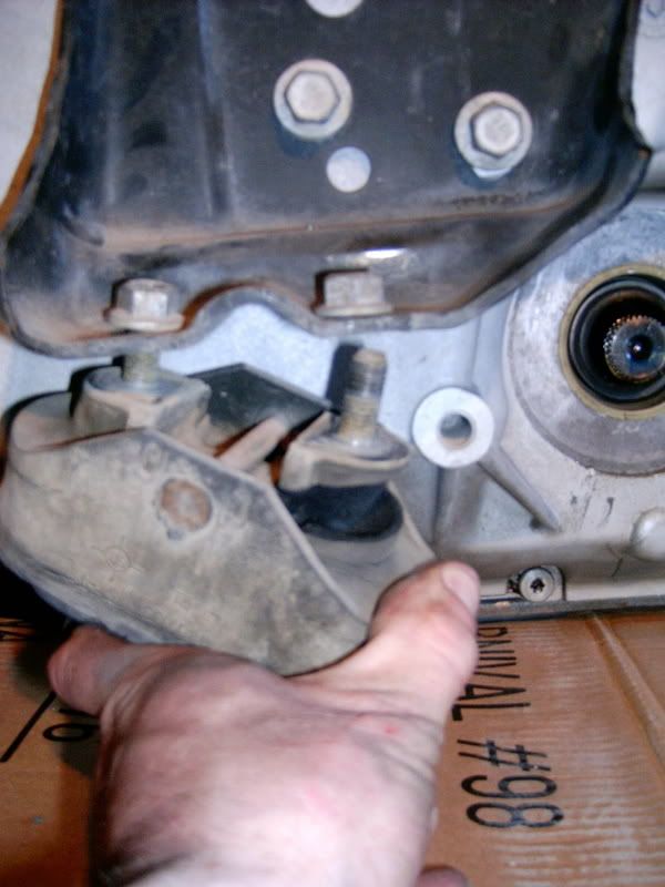

Ripped tranny mount form too much damn torque:
