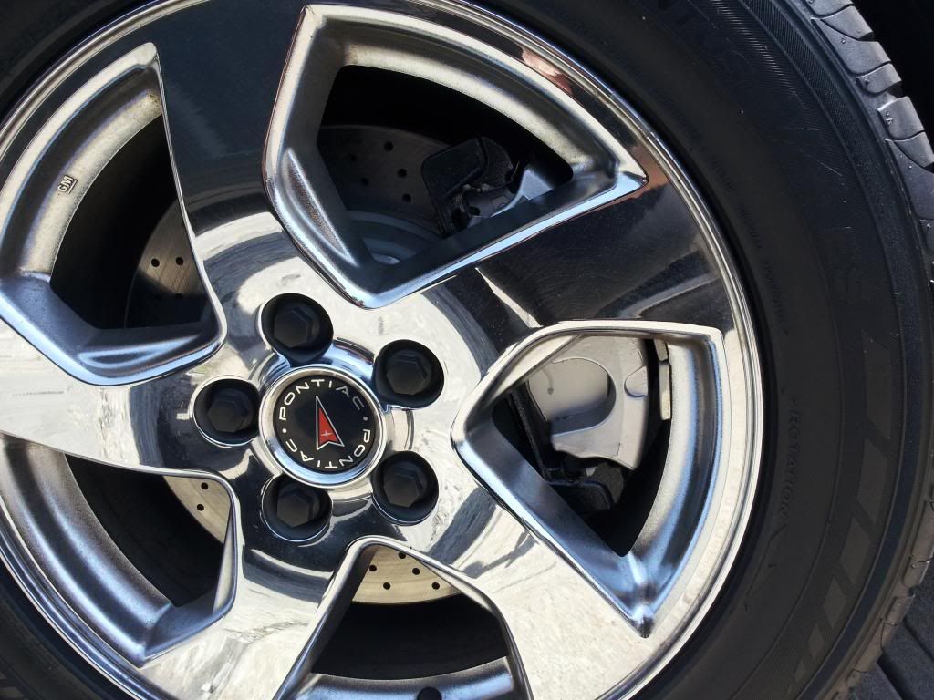

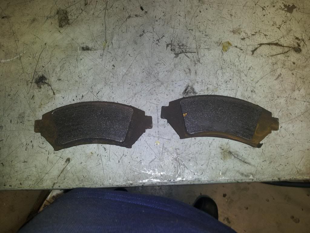

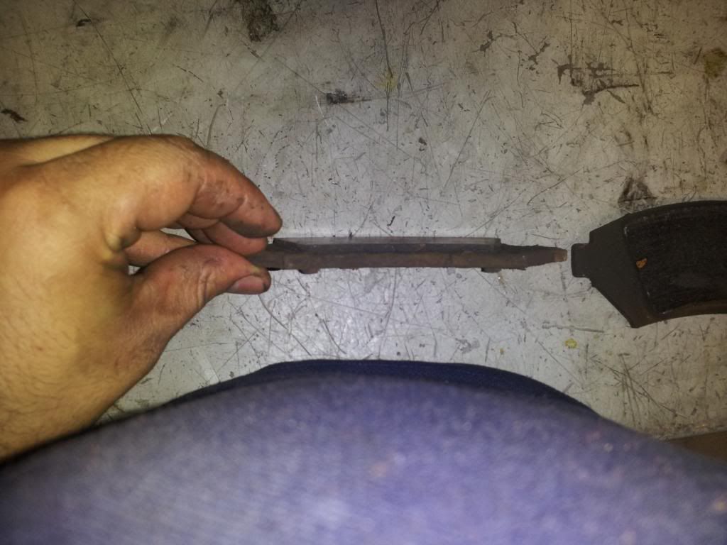

Heard my brakes squeaking so I knew they were about done, So I decided to replace them with better parts. My old pads were done as you can see below.

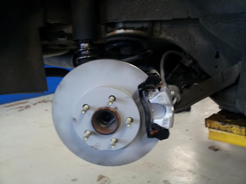

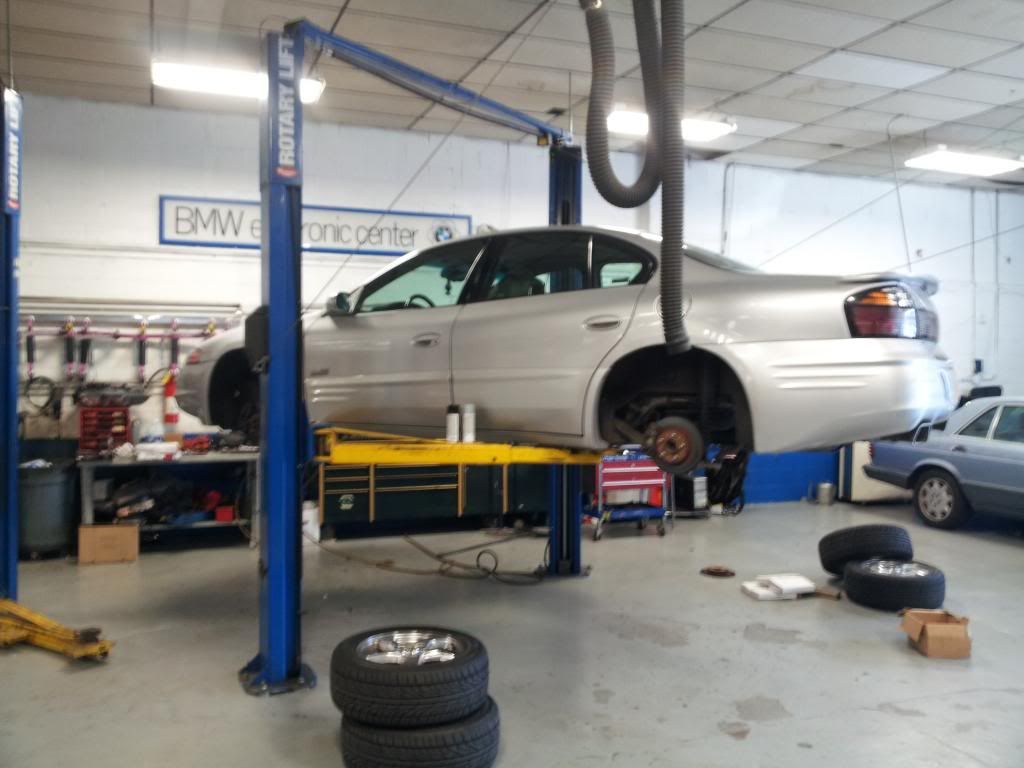

I replaced the Front calipers with Grand Prix GXP calipers.
I also replaced the rears with 2000 STS brake caliper brackets which can fit a 11.7 " rear rotor. It is only .7 of a inch bigger, not much but every little bit helps
(Note: this will only work on G/ 2nd gen H -body vehicles)
I know a bigger rotor in the rear could help, but look at how much of the rotor the pad is not touching.
Thats like an inch of nothing then the super small brake pad.
