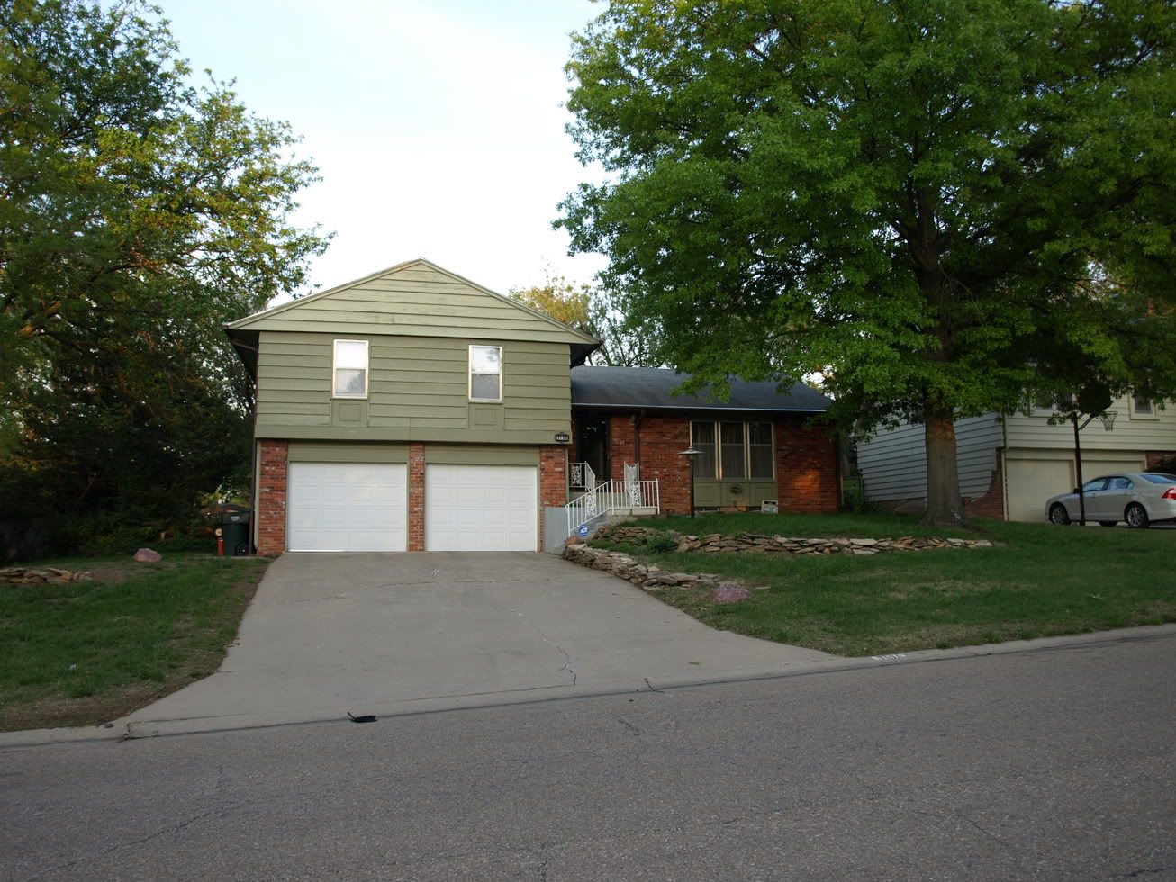

My house's roof needs done. I've had 4-5 roofing company's blow me off. I need the top left and bottom front and back done. I've got some money from insurance but i've had to use some of it for bills due to my wife's inconsistent work as a substitute teacher.
Here's my house
(Deleted Link Done With Project)
I'm not opposed to doing it myself with help or hiring someone. If it's more than 4k i'm going to have to get a loan. I'm pretty sure the lower level also needs new sheeting. Insurance won't cover that...
Let me know if you know someone or want to help or have any experience with this at all. I'm kinda at a loss, I have no truck, 2 hammers, 2 tape measures, 1 pry bar, and one 6 foot fiberglass ladder.

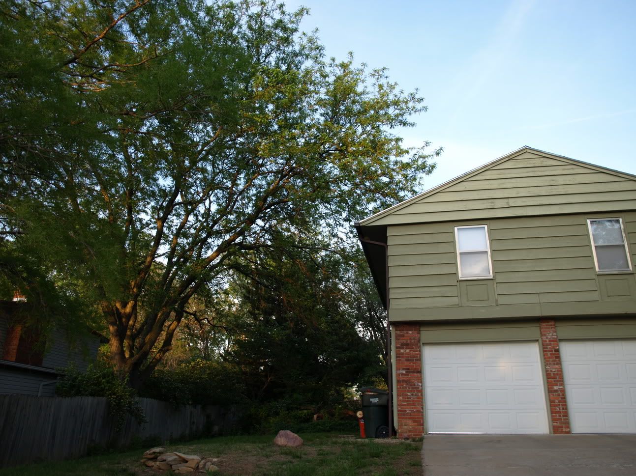

damn, that roof dosen't look bad at all, pitch isn't that crazy and what, 1 valley?. Ive been on some where the roof is like straight up. get rid of that tree too. I went to building school and worked with a few guys, im not a roofer though.
maybe post some pics of the problem areas, from the street your roof don't look all that old, but the sun may rise on the rear of the house and the whole back side is shot to hell in a hand bag.
tip for all of you home owners, the side of your house facing east, well that side of your roof always wears out first. something to do with the morning dew burning off imo. but its always like this.

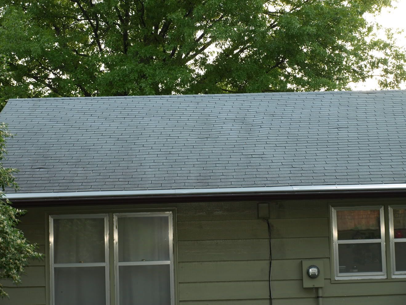

That pics a few years old. Hail hit it last spring. Lemme go snap some shots.

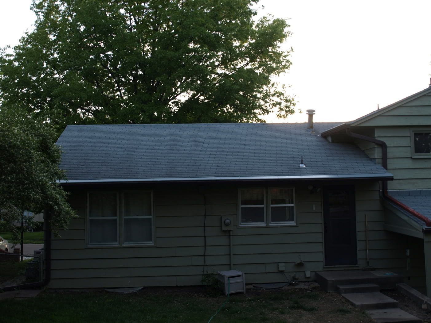

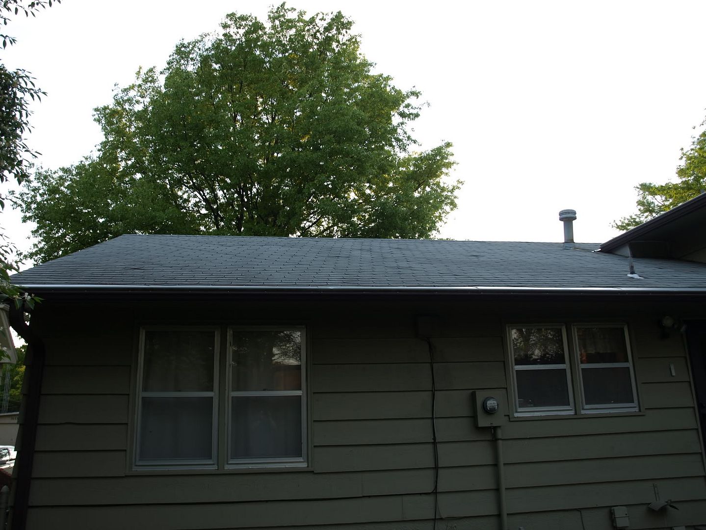

Backside worst probably...

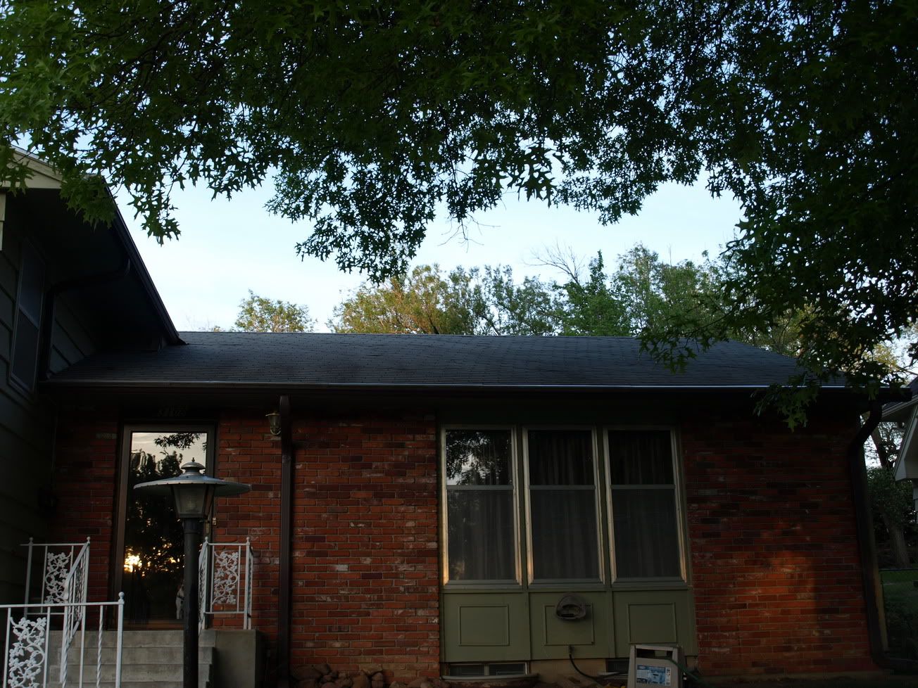

Front
A tree that needs trimmed gone...

are there holes in the shingles or just dents, and is the wood under it, if looking from the attic is it dented? trying to gauge how hard it was hit.
but by the looks of your pics, that all looks like nails popping up under the shingles and lifting the one tab. some times that nail will push through the shingle and make a hole in it, then rain runs down the nail and inside, aka a leak.
and the guy who put your roof on was drunk i think, the keys are no where near straight lol seen a lot worse tho.

heres a vid how to remove just one shingle at a time to fix your roof, this is exactly how to do it. only way really lol
im thinking just buy the looks of your pics you could change out a few shingles and save a lot of cash, see girls do this, not kidding lol
now keep in mind new shingles will look "NEW" AND STAND OUT. so we can do and do all the time, is remove good shingles from the back of your house where it cant be seen if possible, and put the old ones on the front of your house so the repairs blend in, the rear just use new as your the only one whos going to see them, and you can say see all them real white shingles, yeah i changed them....
put another layer on top of it for now if you feel like being quick and dirty. it'll last another 3 years, easy.
Tear it off and reshingle it. Gable roofs are cake. What is this about a 4-12 pitch?
This is a prime example where food+beer+friends=gettin' er done.
better be real good friends who wont quit after its half ripped off, seen that happen before. dont ask the guy who works in a office for help lol
If I lived close I'd help ya for a case of beer. That's a fairly simple tear off and re-shingle. I've done hundreds of roofs jus like that one. These fellas know what they're talking about. Use architectural shingles if you want a simple crash course in doing a roof. Simple as pie to put on and the finished product looks great imo. Alot better than 3 tabbers.
