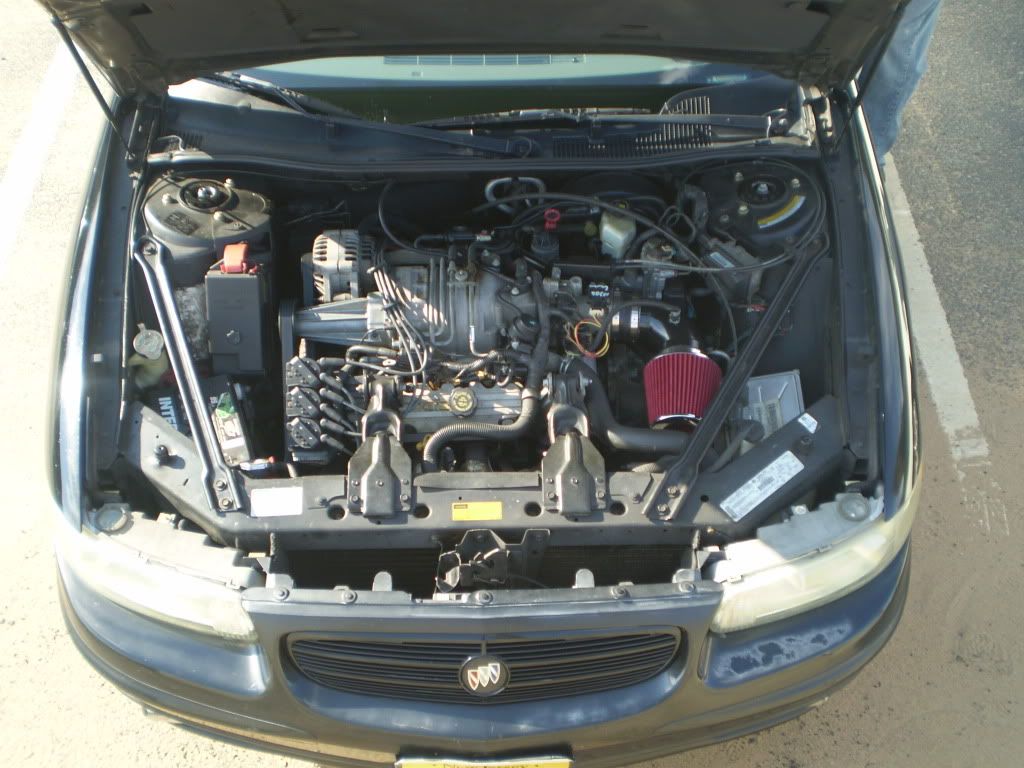

lets see, we got mine.
another NJ guys set up.

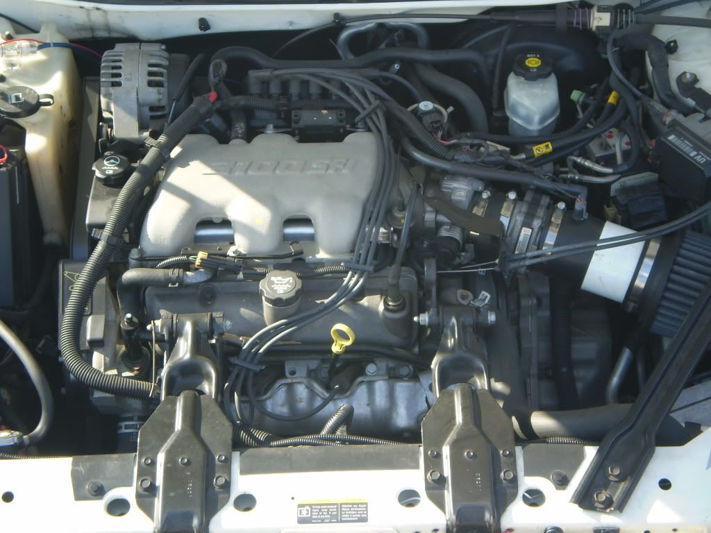

and a 3100 set up to boot.

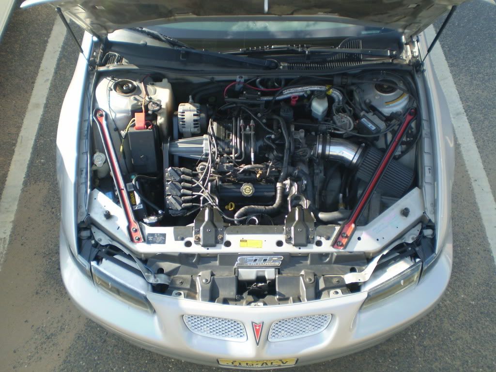

pick your poison.
