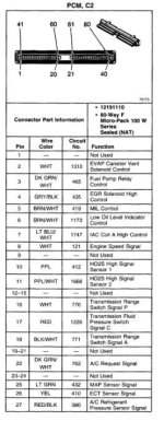

Here are pictures of the PCM connector:

Do you have 5 volts or 12 volts on the grey wire at the TPS? One of your post said you had 12 volts, now you say you have 5 volts? Does it idle high all the time? I would check the readings at the PCM with the engine running when it is idling high. C2 pin 33 should be 5 volts, pin 66 should be about .50 volts at idle.

You need to back probe the wires at the PCM. I use sewing "T" pins to do this, but you can use any small thin metal like a straight pin. I use small alligator clips on the leads of my volt meter to clip to the back probe pins at the PCM.
