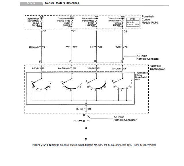

Woot thanks to Jason for the wiring diagrams i just figured out how to get my reverse lights to work.
Looking back at this diagram. Yellow and white grounded makes neutral.
I need those grounded at all times while obviously being able to put the car into reverse and have the reverse lights turn on.
So i figured out if you put the black/white wire to the yellow wire it turns on the reverse lights, so then i just put one of the reverse switch wires connected to the black/white and the other to the yellow and bam operational reverse lights without rewiring them completely with a relay ect.
